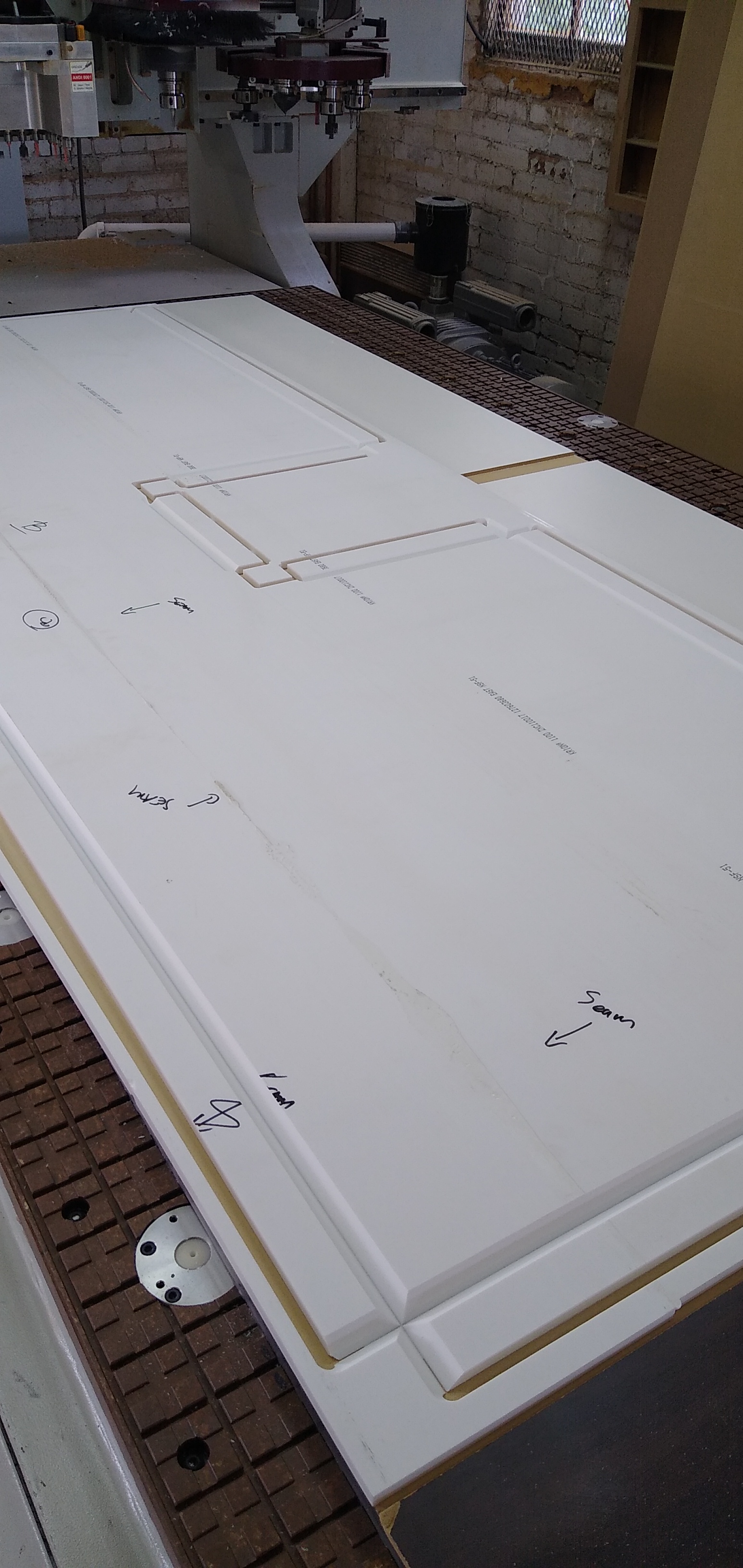

I run a vortex integrated v groove on my Anderson CNC . I run a first pass at .4 in and a second pass at .095 leaving 5 thousandths to the spoilboard so that the vynal packing tape layer is still there for the miter fold.
The cuts are absolutely clean and perfect and the inserts last a long long time. I also miter fold MDF core venir for floating shelves, end panels etc. with the same bit but leave the last pass at about .2 - .25 inch on the 3/4 thick stuff.
I have yet to change an insert and have made a lot of tops with it.
Perhaps the stability of the integrated HSK tool is helping me out, but I have been thrilled with our quality and production.
I will get in the computer at the shop tomorrow and give you the spindle speed and feed rate I am using.

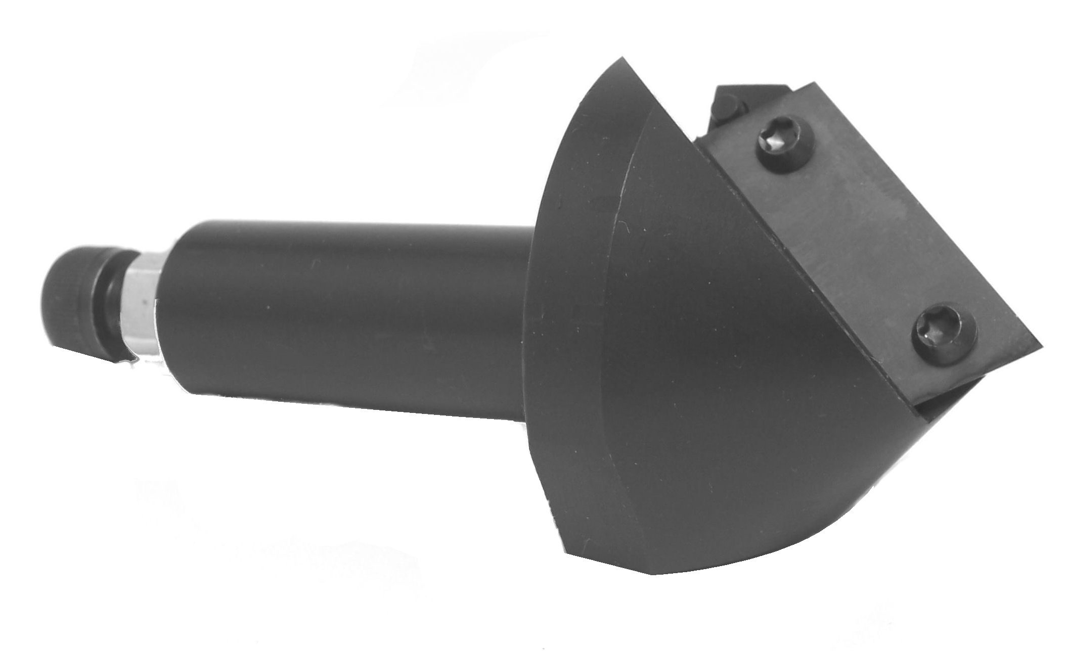

Here is the bit we carry for the Miter Folding
Part # SECS143IR

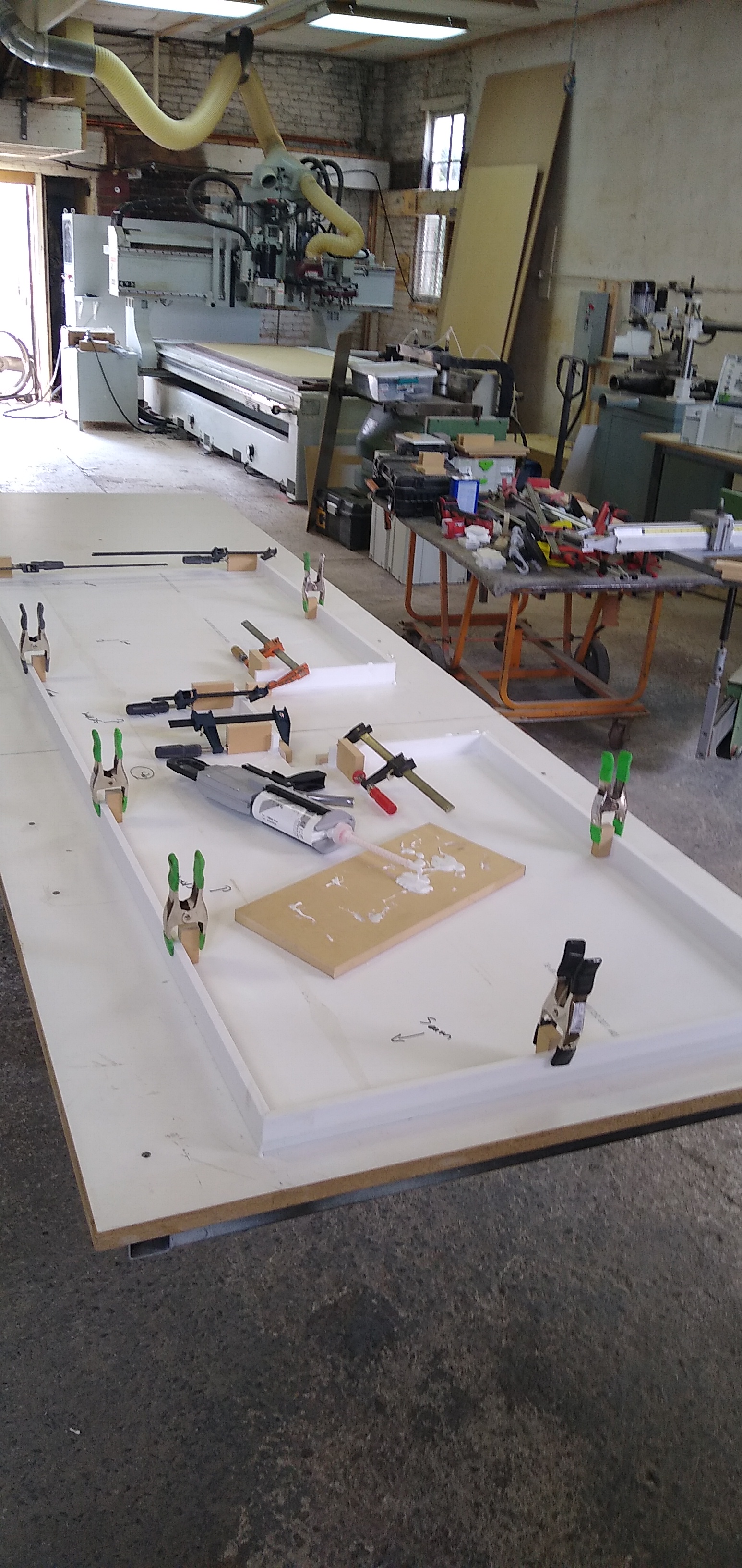

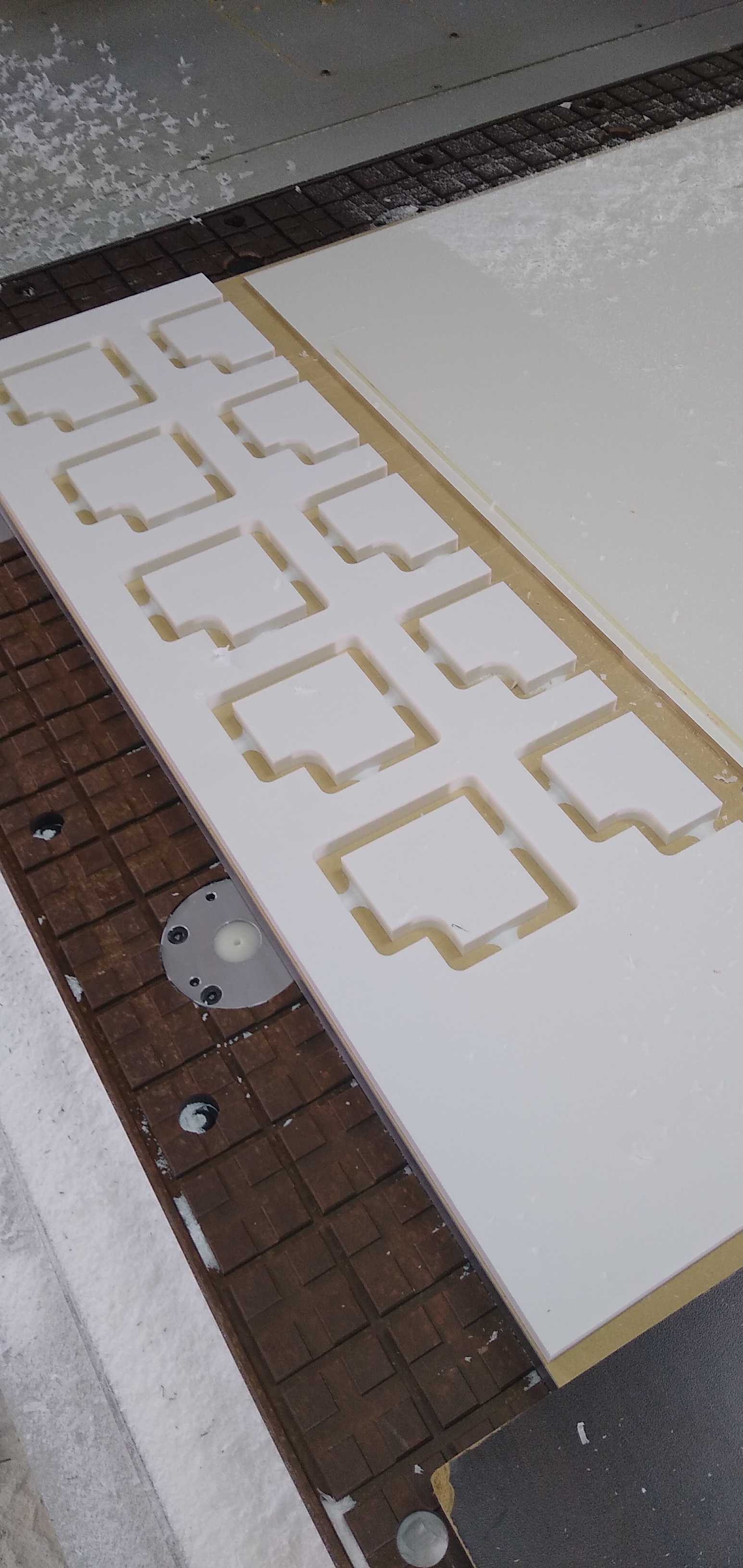

I have found that the geometry of the insert that I have is actually cutting as the angle at the tip is sharper than 45 degrees . And also for the increase in speed of assembly and sanding it's a no brainier for me. That being said, like most things it is not a silver bullet. When you have tops with a lot of inside corners the miter fold doesn't help you and requires clamping and glue up of corner blocks etc..

Quicktrim
Gary,
I am applying tape from Betterly to the back side centered on the cut pattern , then cutting through the ss to the adhesive layer of the tape but not through the tape.
