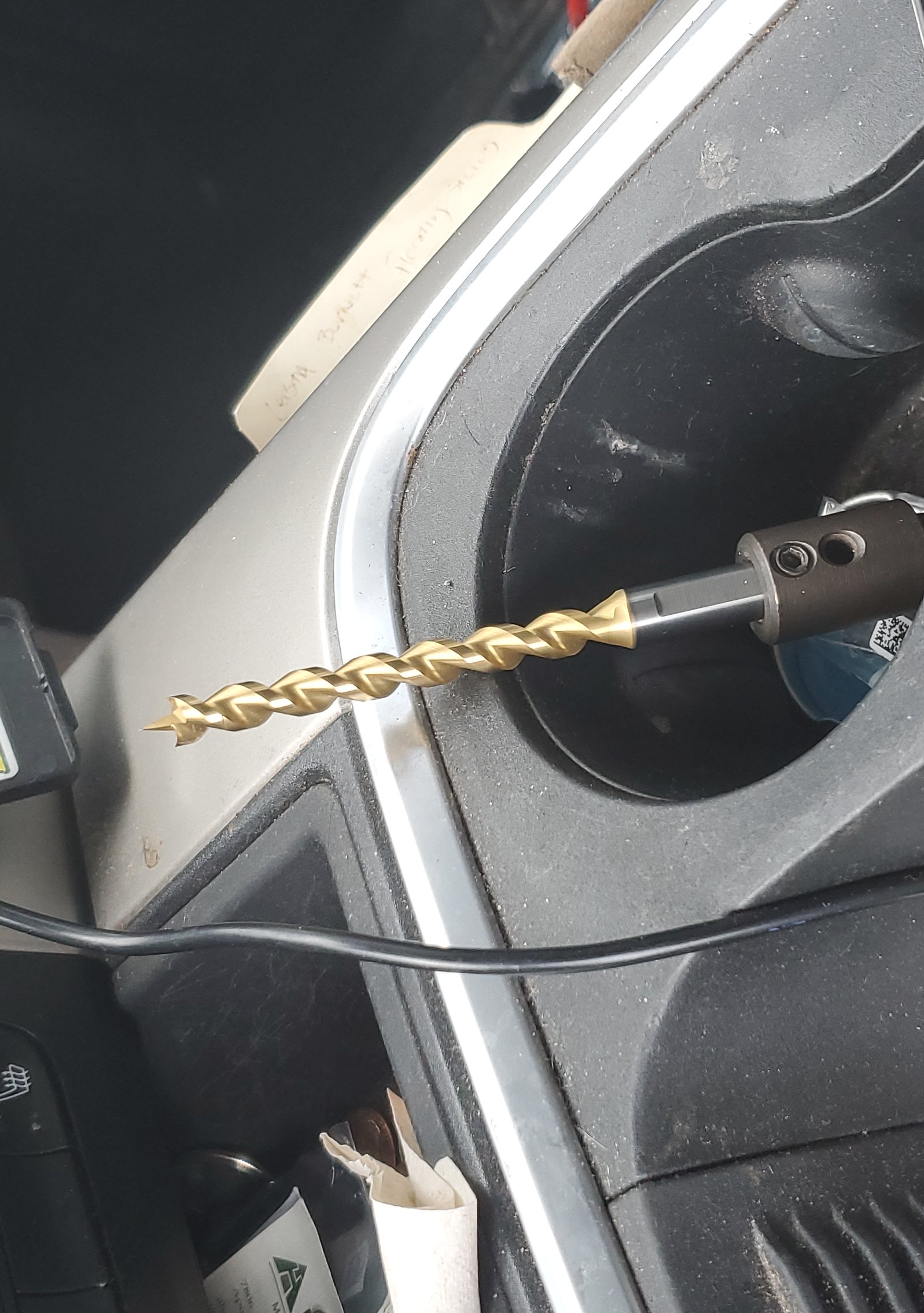

Good morning.
Anyone have any idea where I can buy a 9mm dowel drill longer than 70mm?

If you are not actually needing a deep boring bit and are looking for a long 70mm bit for an automatic doweling machine, there are bit holders/extenders that will allow you to use stock length bits. We had a similar issue on the horizontal drill on our Omal HBD and we bought the extender from SCM

Thanks for the ideas.
We need a 52mm deep hole and are about 2mm short with a 70mm drill.

Reach out to Leitz. Their solid carbide dowel drills are the bees knees and last forever. Brian is a great resource for tooling.
