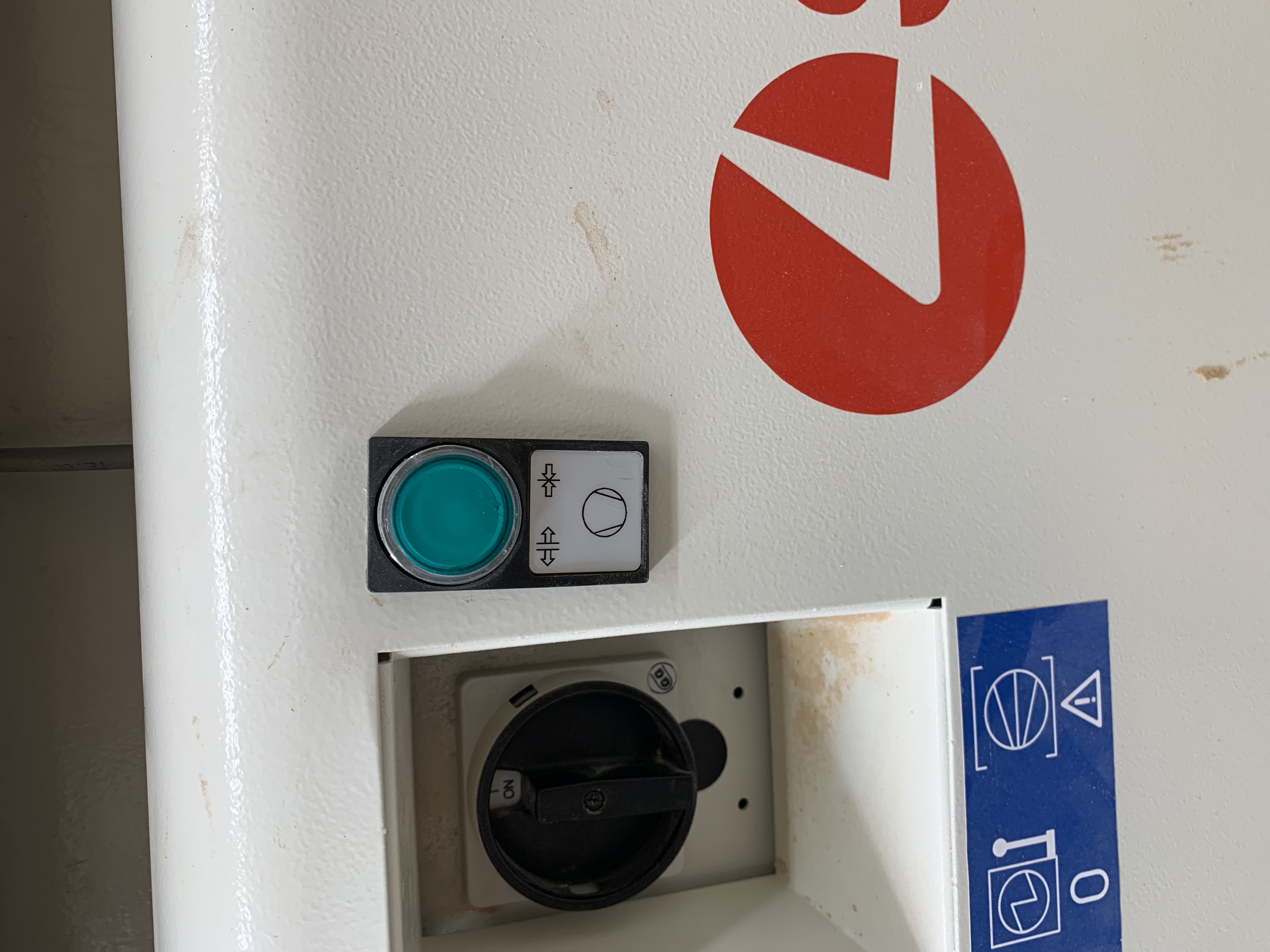

We have a SCM pratix s cnc machine and all of the sudden the auction button isn’t lighting up. It’s suctioning down. So I don’t know what is going on. Is there anyone who can help me

Usually a magnetic contact involved. Do you have a multi meter to diagnose where the current is and where it ain't?
3/18/21       #4: Cnc not working ...
Start with the simplest/cheapest possibility. Check to see if the lamp is burned out.

It’s not going to light up unless you have enough vacuum pull down.the factory usually sets them up pretty high. You can lower the value. Loss of vacuum can be a flat table gasket,rolled gasket,ultra lite mdf,dirty filters.

On my Weeke there is a vacuum sensor that can become lodged with sawdust.
Take it off, tap and blow it out, or replace it.
You can bypass it in a pinch, but I replaced mine straight away.
Wasn't prohibitively expensive.
