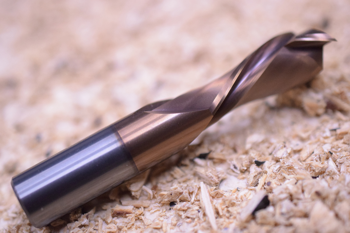

Have you tried any of the longer wear carbide spirals or coated tools?
