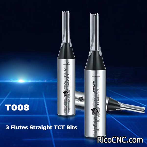

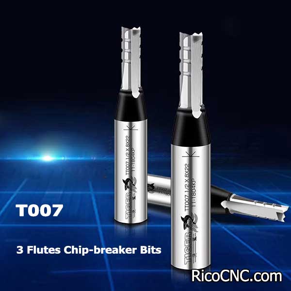

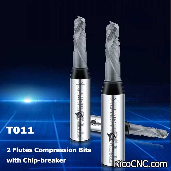

For melamine board cutting, here is some suggests: for melamine chipboard cutting, suggest the T011 bit, spindle rotation speed should at 18000rpm-24000rpm. Feed rate could be 10-15 meters/min. For melamine MDF board cutting, suggest the T008 bit, spindle rotation speed should at 18000rpm-24000rpm. Feed rate could be 10-18 meters/min. For melamine plywood board cutting, suggest the T007 bit, spindle rotation speed should at 18000rpm-24000rpm. Feed rate could be 10-18 meters/min
Rico Router Bits for Melamine
