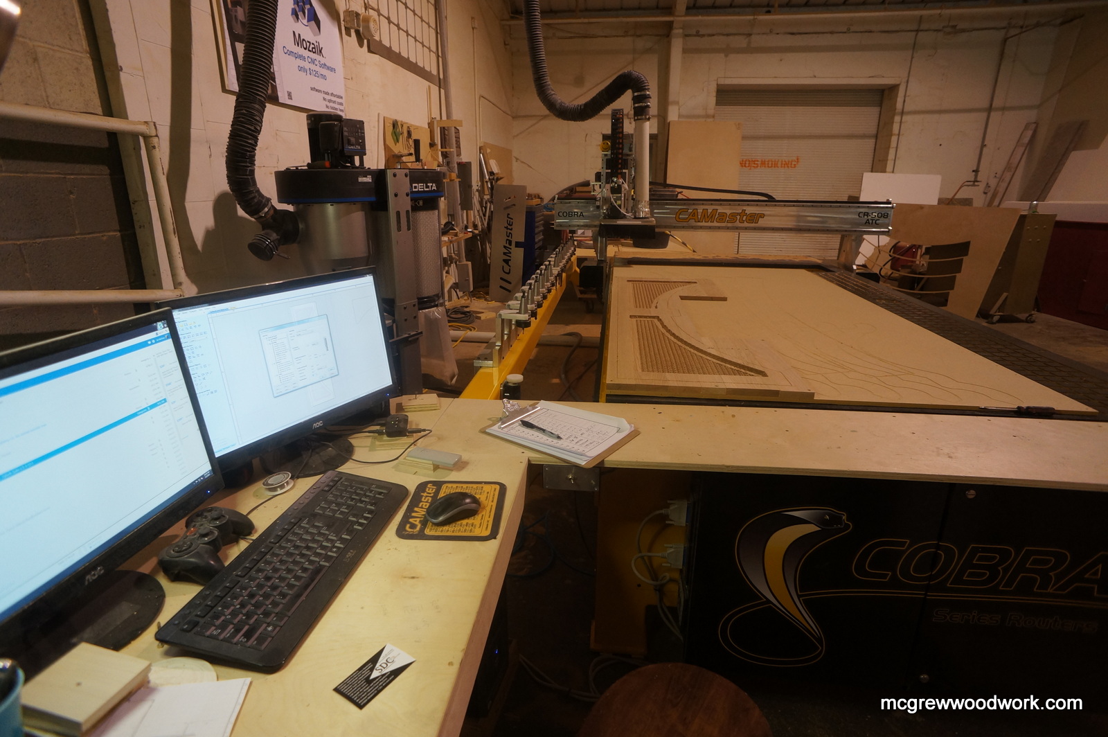

james e mcgrew  Member
A Carosel frees up an edge on the table, this can be good for loading and unloading reasons, and can take a few seconds shorter time to conduct a tool change as it is just closer to the z head.
originally my tool rack was on the end of my machine, I had it moved to the side because i wanted to load from an end and remove from a side. this was a good decision for this set up.
my second machine has a on and off loader and uses a carosel
it is all about set up and thinking growth in use for your cnc
that said the actual function is the same
