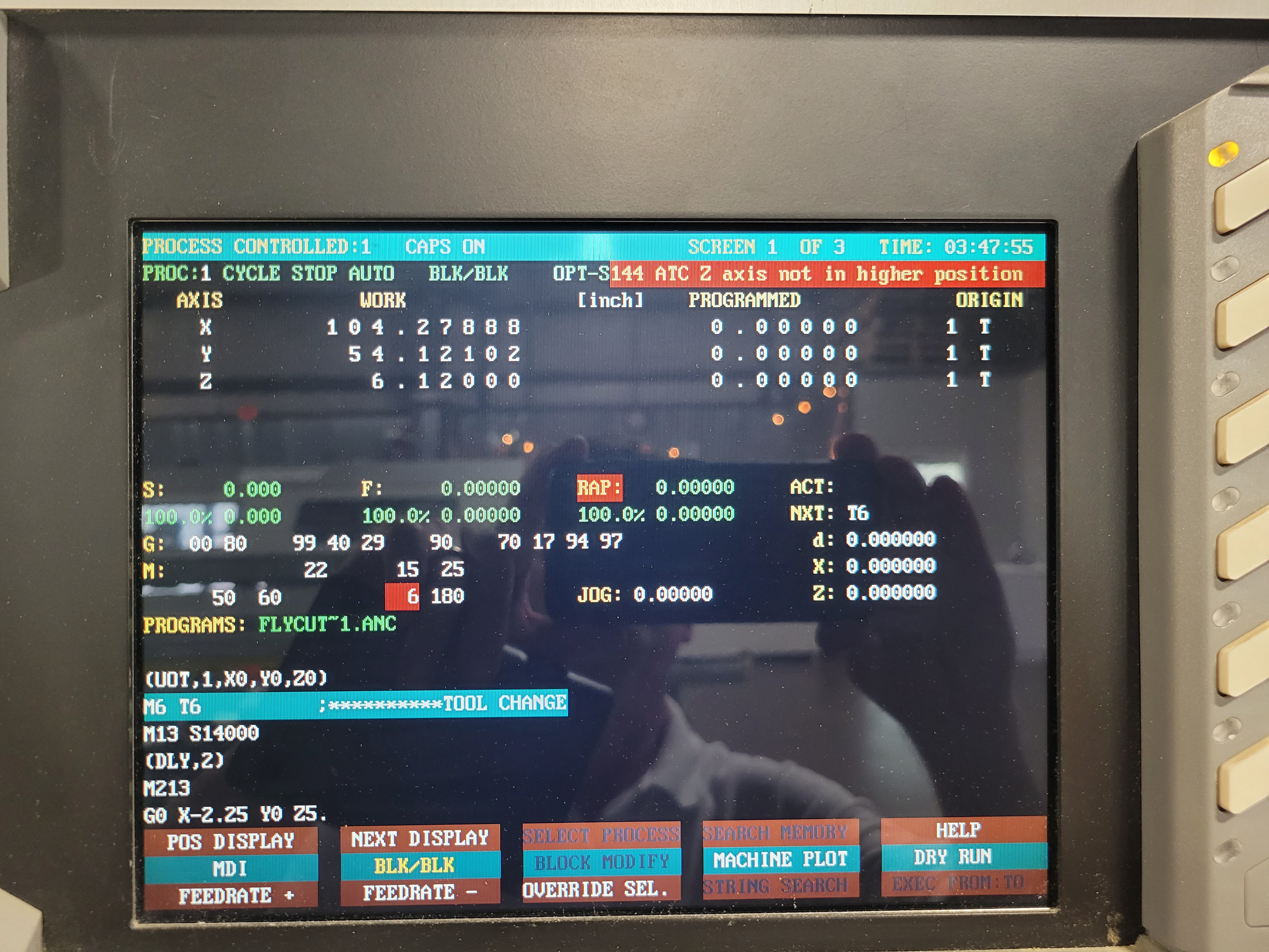

I am hoping to get some tech support for a used CNC router we purchased. I am happy to pay for support (phone, email or on-site), just need someone who knows how to get it working. It’s an older machine but in excellent condition. It is a 1998 HOLZHER COSMEC SA-25 with an OSAI series 10 controller. I have previously owned many CNC's including a COSMEC Conquest 250 (also a 1998) with the same controller so I am familiar with the machine and how it operates. I currently have it setup and running and can run programs with the router, however, I am getting an error message “144 ATC Z axis not in higher position” (see attached photo) any time it calls out a tool change (M6 function) and it stops the program. I can manually load a tool and skip the tool change command, the router works but doesn’t use the tool offset table, so no tool compensation (G41, G42, etc.). This also prevents me from using the drill head, saw, etc. We thought it may be the dust hood not in the upper position, however, the dust hood is up and the corresponding sensor light is activated in the control cabinet so I don't think that is it. The manual M code commands for the individual tool changer functions work fine.
The company I bought it from has been helpful but never had this problem. I am also getting a "CMOS battery low" error and if it sits for a while (which it did before we bought it) it "forgets" everything...I have to enter offset and tool data each time. All the variables are blank also. I think there is a variable that it "forgot" which is causing the tool change error, but I don't know what it is. I do have a lot of backup files, but don't know how to install them or where they would go. Side question.... anyone know how to replace the CMOS battery?

is the mgazine have option go up/down by cylinder?
cheack if there sensor on z to confirm spindle on corect position
is someting happend until this error apear?
i mean is z move? y move?
in any case photo of yours magazine will help to understand

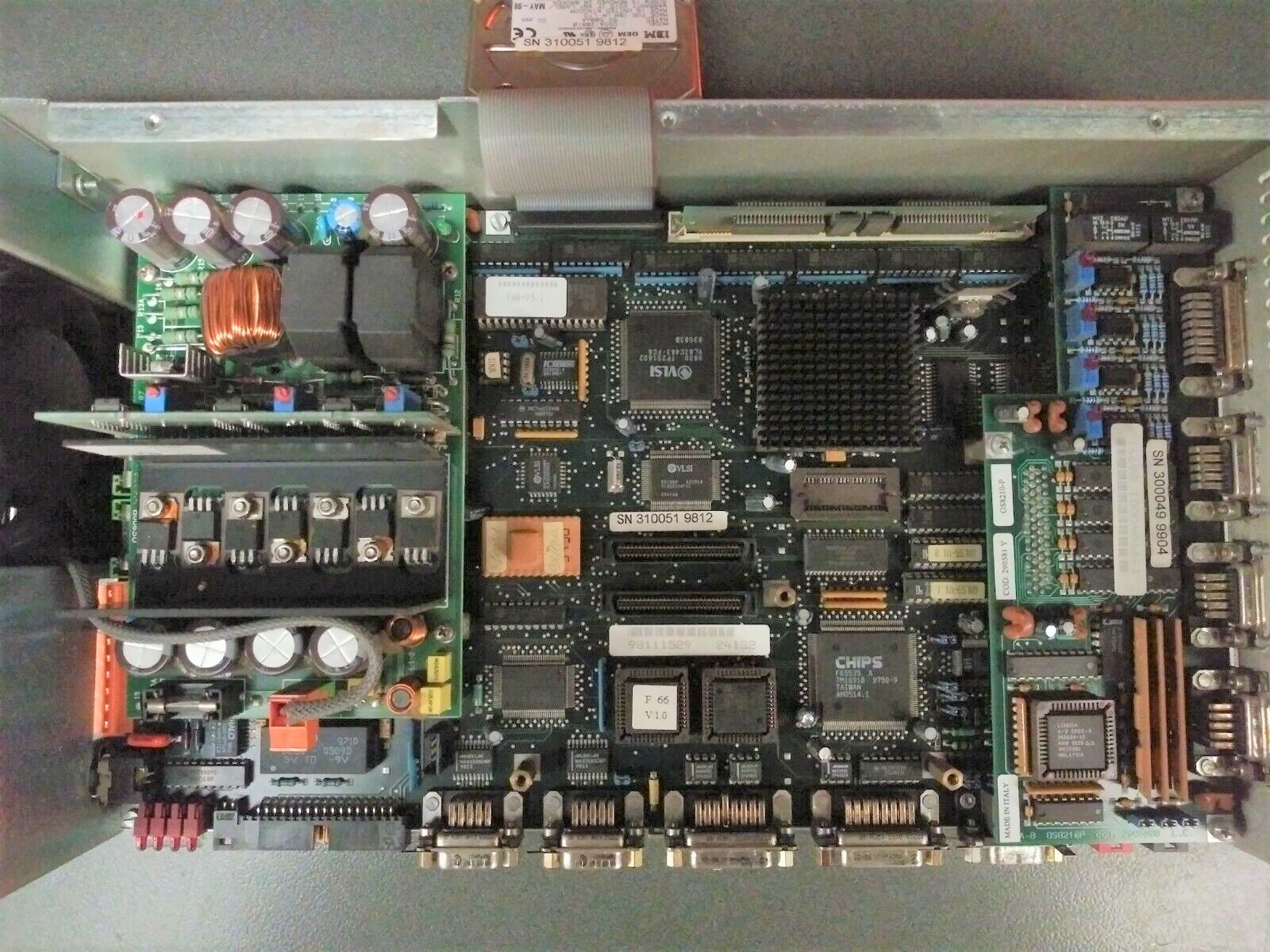

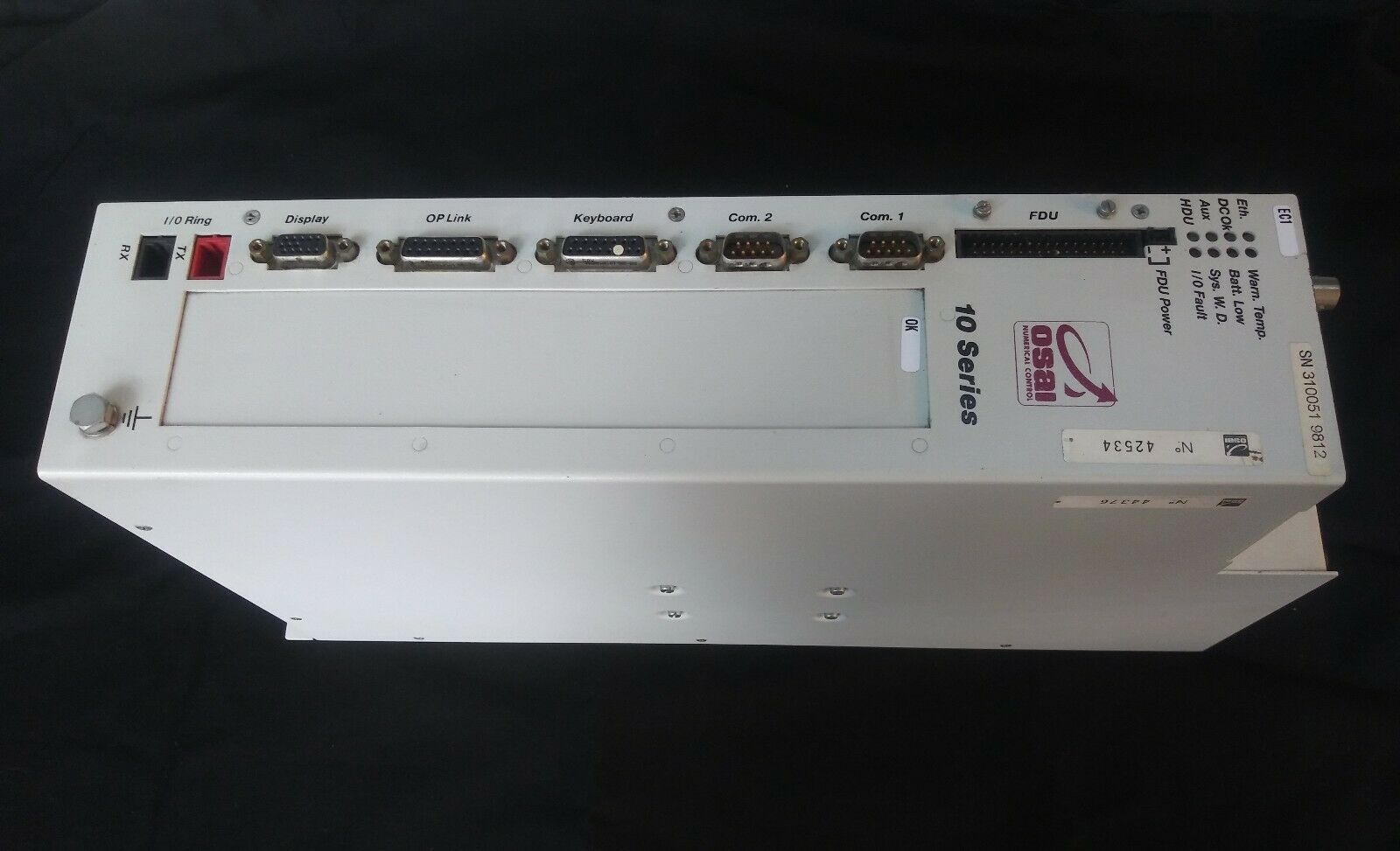

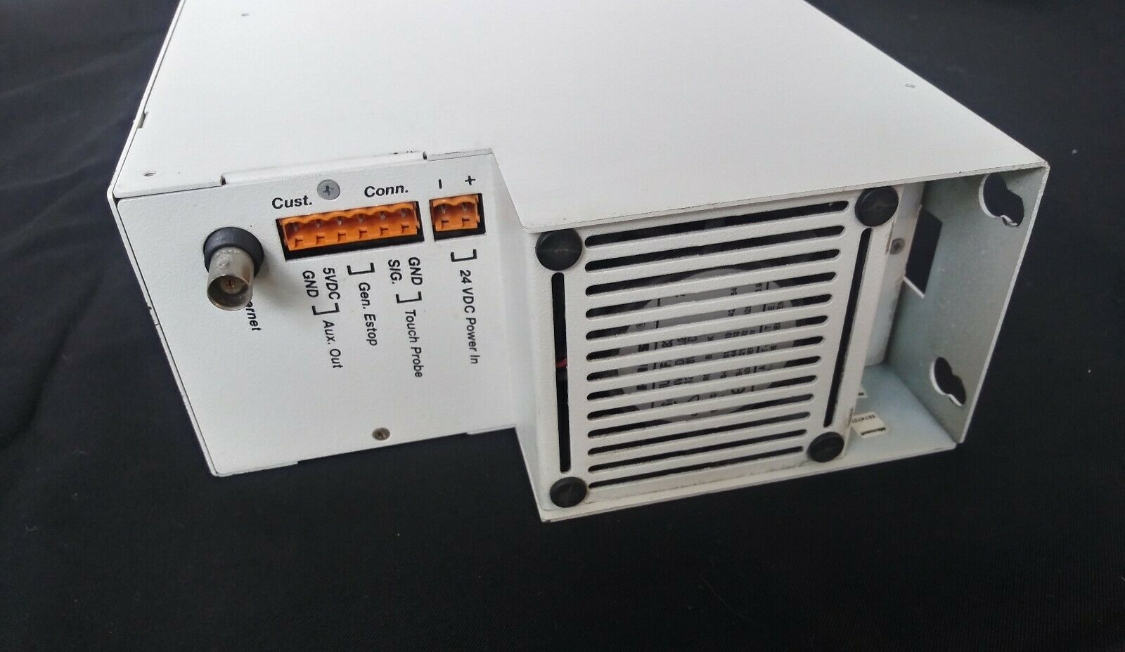

I also have a similar machine which uses the OSAI 10. Did you ever find the CMOS battery?
I found this file online of what seams to be the OSAI 10, but I don't see anything that looks like a battery.

9/23/23       #7: Looking for CNC tech support - HOLZ ...
Romeo
The battery is under the power converter module.
