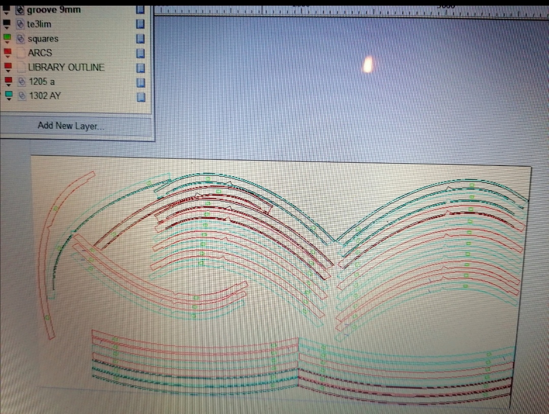

Hello all hope your doing great i have a project that require cutting and grooving in mdf 18mm design as the picture below i am using a compression 2flut bit for cutting and grooving any suggestions about changing this type of bits

I wouldnt be wasting time with a compression if thats just straight MDF. Id be running an up spiral or if that doesnt behave on your top surface or with the material your running a down spiral. No idea if your vacuum hold down, screwed down, or what. A compression is a waste on MDF in my opinion. Even a straight 2 flute tool (brazed) would be fine.
1/10/22       #3: Suggestions about cutting irregular ...
I would not use a straight flute on MDF. Chip evacuation is paramount with MDF. Without good chip removal bits will dull in seconds with the heat build-up. Up spiral two flute.
Your biggest problem will be keeping those slender pieces from breaking free and chattering against the bit. You will probably have to sacrifice nest efficiency to keep a fairly large border around each piece and tab them. Or an onion skin instead of tabs.

I cut miles and miles and miles of 1/4"- 3/4" MDF and run 1/2" shank, 1/4" 2 flute, brazed tooling. Im talking MILES. I have run the same material with up spiral, down spiral, and compared tool life, cut quality, six ways to Sunday. Other than chip evacuation with an up spiral, a 2 flute 1/2" shank 1/4" straight cutter will plow through a hundred sheets in its sleep. I run the up spirals if the parts are large and wont lose vacuum but the wont run anywhere near as long as a 2 flute straight.

I strongly agree with a couple of the points raised previously.First of all I believe you will find it hard to prevent some of the parts breaking free without a good amount of support being present in the form of tabs.Second,a half decent TCT tool will cope with MDF and helical or compression fomat isn't really necessary.

It isn't just the type of board but the tiny pieces under discussion for this project will mean that you can't go tearing into the sheet at a zillion inches per minute because they would break free.For larger pieces that will hold down it still pays to experiment a bit and I have been surprised to find that for some materials,brazed TCT worked better than solid carbide.The things you find when using your own machine sometimes run counter to the generalised recommendations and can be very valuable.

The bottom line is heavy brazed carbide will plow for miles and miles after its dull when brazed to a steel shank. Carbide will cut MDF dull or a very long time with very little effect on cut quality.
A solid carbide tool will dull and deflect and snap.
Ive tried less expensive 1/4" steel shank tools and they snap in no time. The 1/2" shank tools are far stronger, dissipate heat far better, and will cut for ages. Cut one sheet in MDF and then go to hardwood, your dead. But keep your steel shank brazed tools designated for MDF and you can fork lift after lift of MDF to the machine and change tools 1/4 as often.
Cut strategy, thin parts like in the image that are going to vibrate/move well your doing your own math there but I could cut those parts all day long, more, small as possible 3D tabs, that could be clipped off with side cutters, all day long.

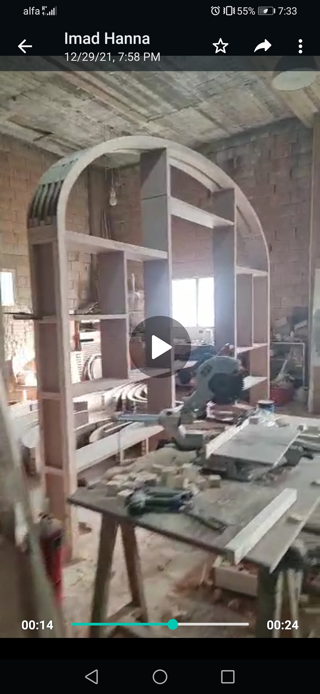

I finished my project i used 2 compression bit and i cut about 155 mdf sheets 366x183 cm it took me about 17 days full of dust but at last a good job and a fast one i was going 10 m/min using the same bit for grooving and cutting and i left 0.4 mm in the bottom of the sheet and i took of my sheet on a movable table place another one the cnc and stat the job shile waiting i was cleaning with a hand router the bottom of the part and naming each a ever part
