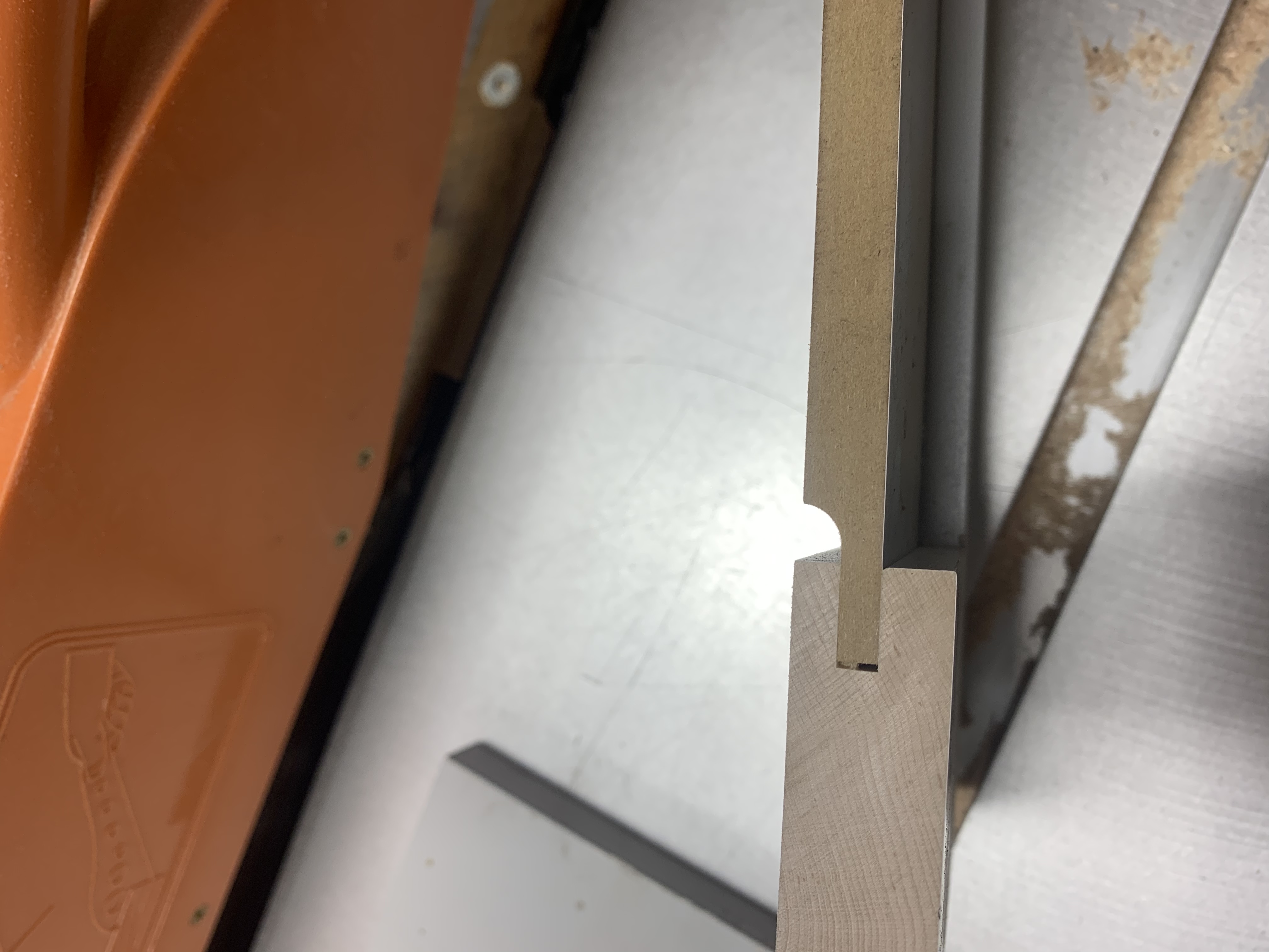

I started building my own cabinet doors, mostly 5 piece, I have most of the equipment required and although the first few sets cost about $200 per door, haha. I have got a pretty good system in place.
I have a shaper cutter for running the 3/8 mdf Center panels through to get the rebate or whatever the proper term is on the back. It has a nice radius so the panels look good when you open up the cabinet.
I cut the panels on the cnc and then run them through the shaper. Is there a tool that anyone can recommend to do this rebate cut on the cnc at the same time, this would save time.
Thanks for any thoughts.

I am looking for tooling to make the relief cut in the panel, using the cnc.
I was joking about the $200 per door, they just cost more than buying them would have cost, but schedule and quality have been a bit of an issue since Covid started. Thanks

You can do the back cut on the CNC a few ways. If you want the reverse raised panel look like your pic shows, it'll take 2 tools: your straight cutter to hog out most of the rabbet (rebate in Europe, rabbet in US, potato poTOHto), then follow up with a bullnose running a centerline cut on the edge of your rabbet to create the scallop. Or do what I do, which is to skip the bullnose and make an extra wide rabbet so it creates a 1/8" reveal and leave it at that. Spaceballs in the panel groove help center the panel so the reveal stays even.

If you are committed to producing a door that looks like a 5 piece door, you might consider making a 2 piece door. For shaker profiles similar to the photo you posted it would be very simple. You would cut a frame from 3/4" MDF. This would have a 3/8" deep rebate around the inside of the frame, "squared up" with a 1/8" or 1/16" diameter tool. Then cut your centre panel from 3/8" MDF using a ball nose tool in the way Jared explains. These panels should be cut around 0.01" smaller than the opening and have a radius in the corners that matches the radius of the tool used to cut out the rebate in the frame. I have found that these fit so snugly it's hard to tell that it's 2 pieces. This method is very simple even without costly software. You can easily draw up a template in any free CAD program and stretch to the required sizes before importing into your CAM software and assigning tools. There would be a slightly reduced yield compared to your 5 piece door and a small radius on the inside corners but your assembly and machining time should be greatly reduced.
