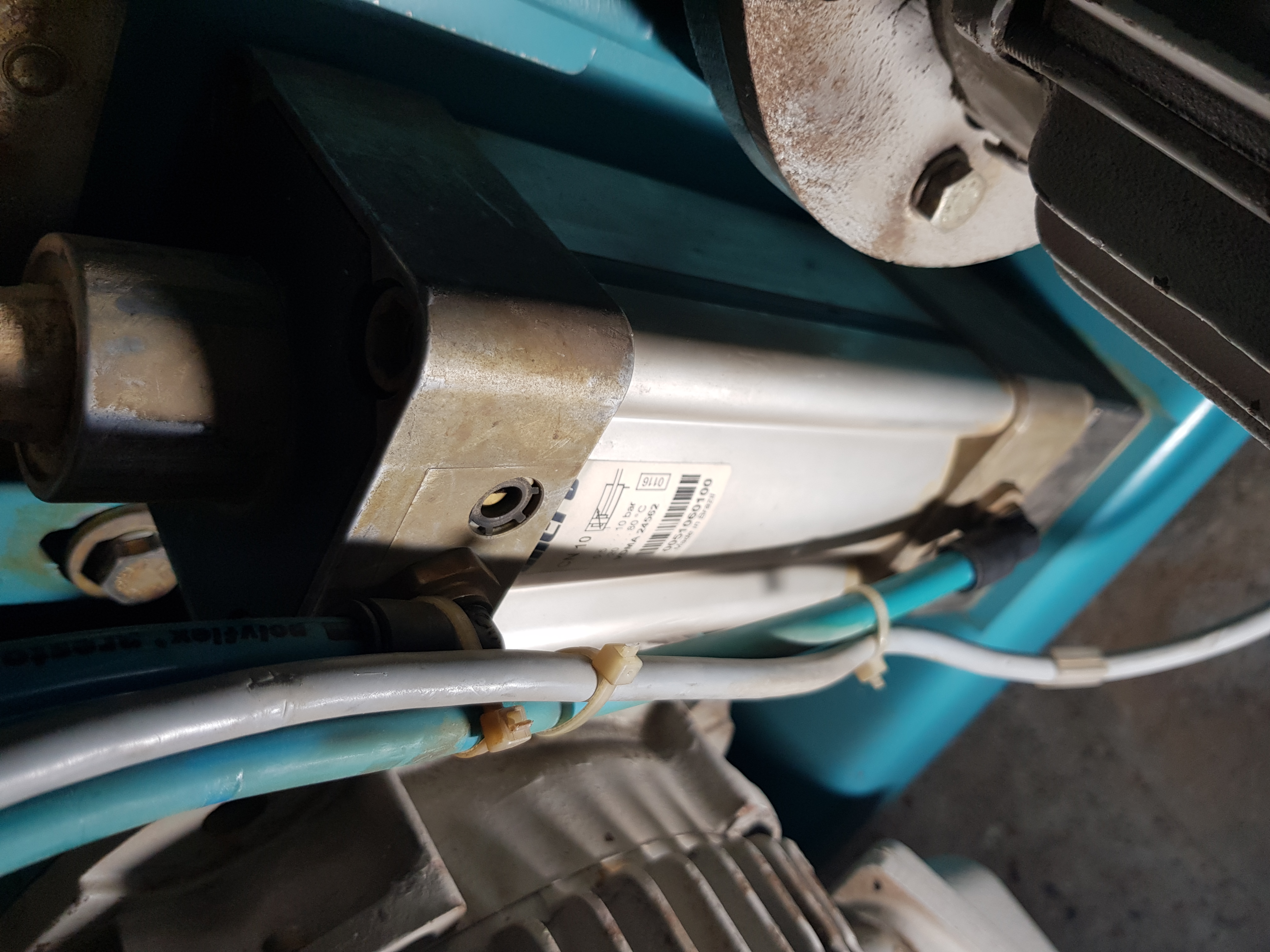

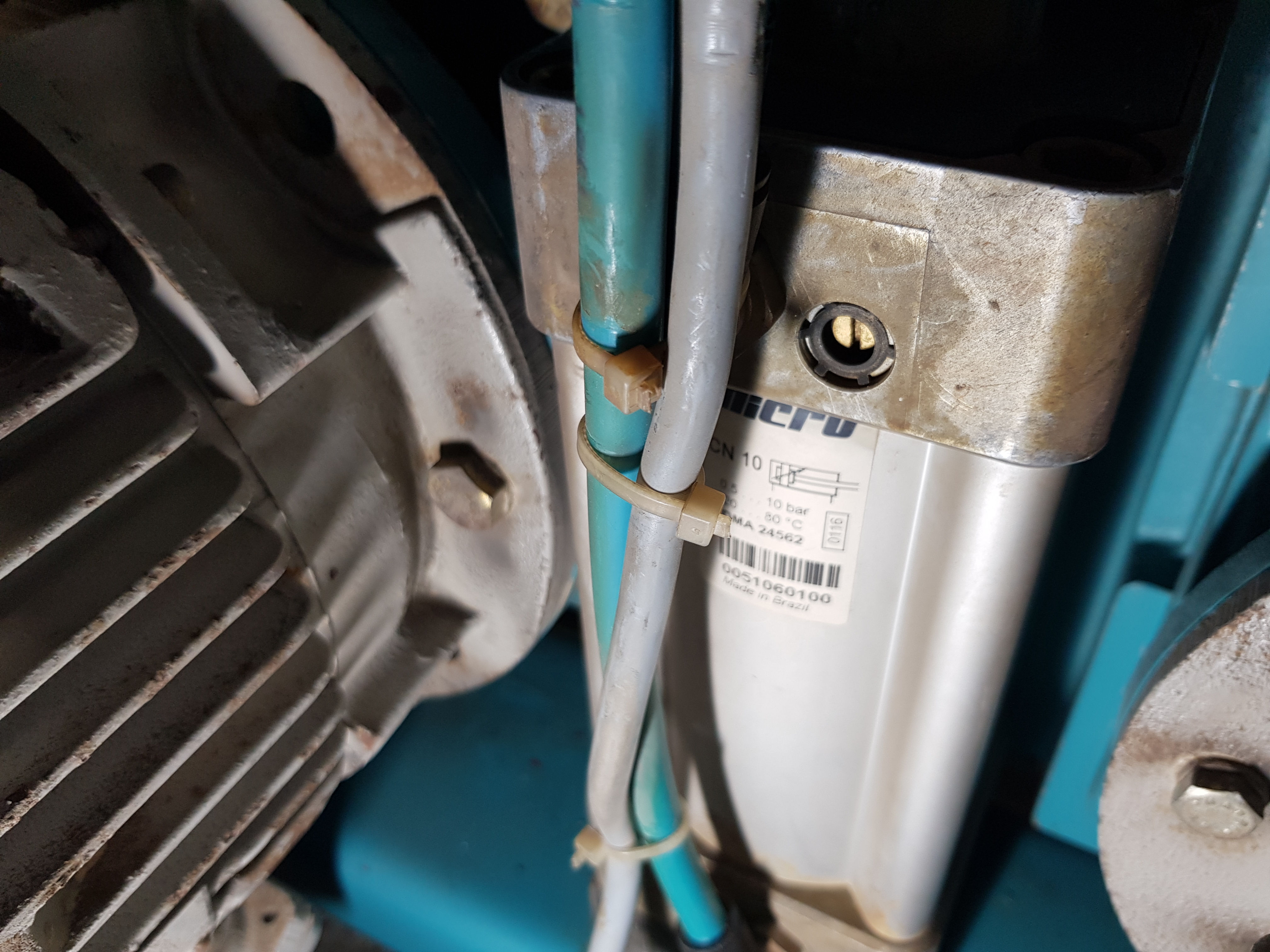

Leon van diepen
Photo of valve
3/12/25       #13: Panel saw variation ...
Leon van diepen
Photo of valve
3/12/25       #14: Panel saw variation ...
Leon van diepen
3/12/25       #15: Panel saw variation ...
Dropout
That's the cylinder not the valve. Please don't touch any of that.
I'll post pics tomorrow.

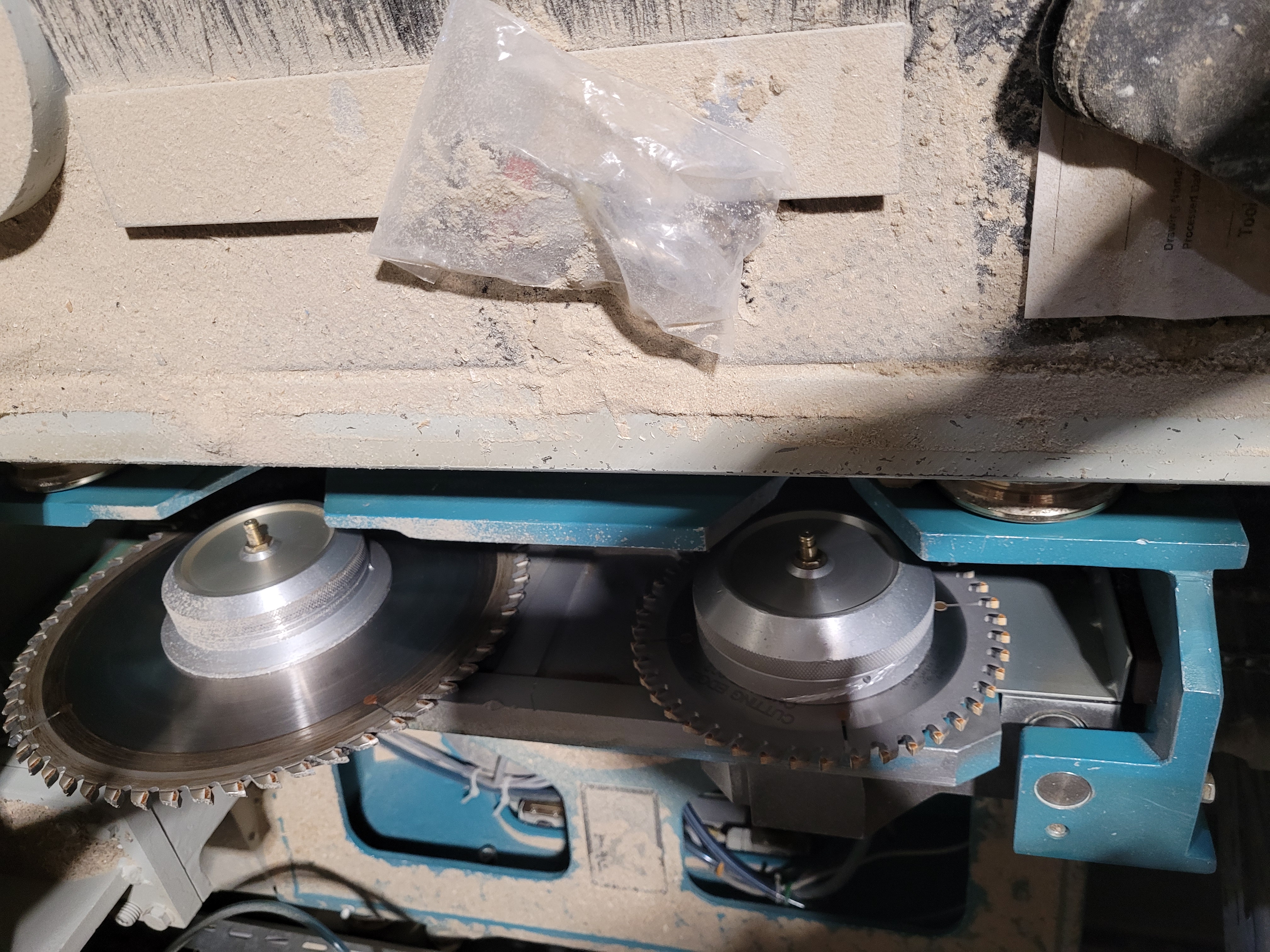

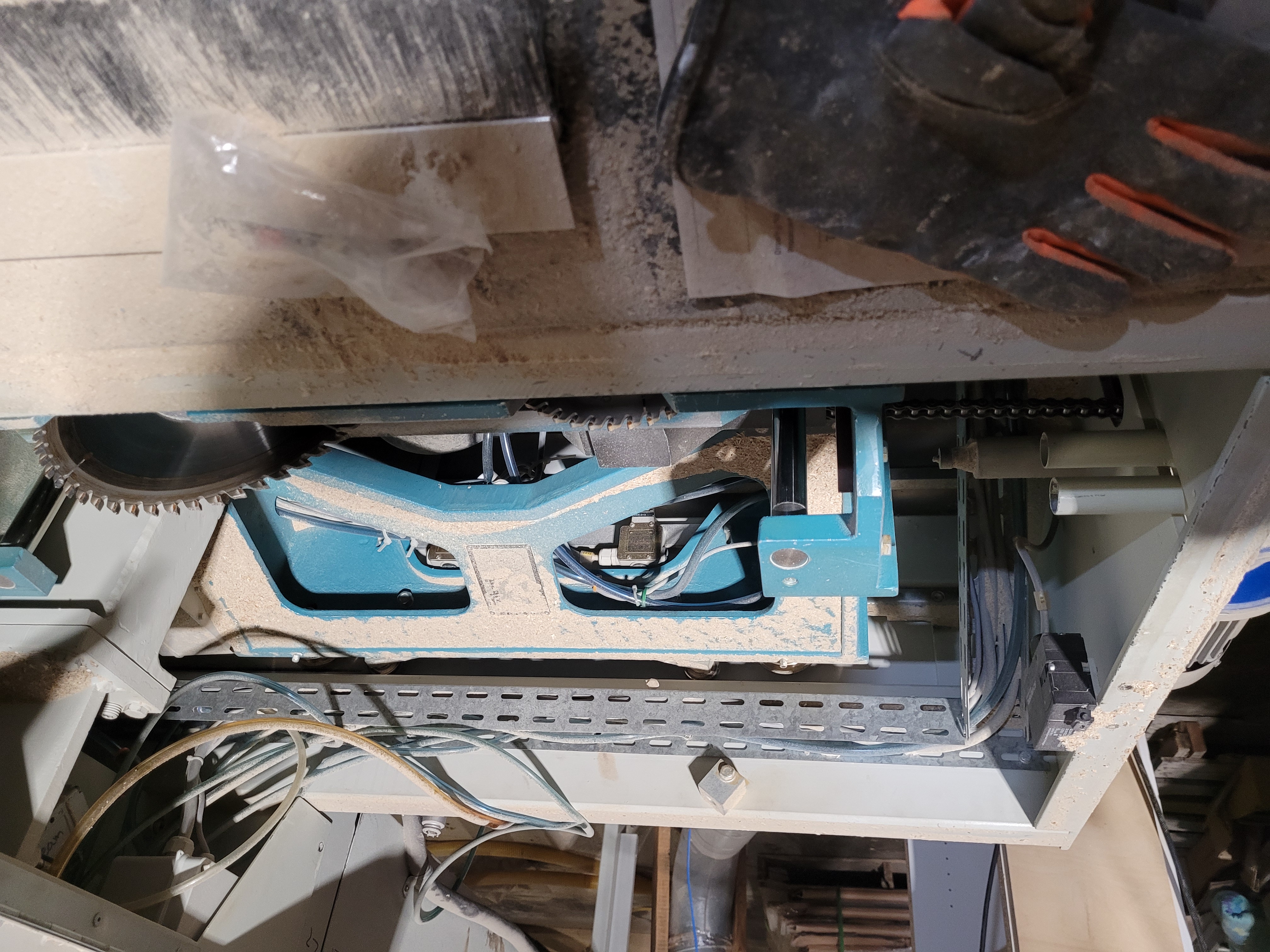

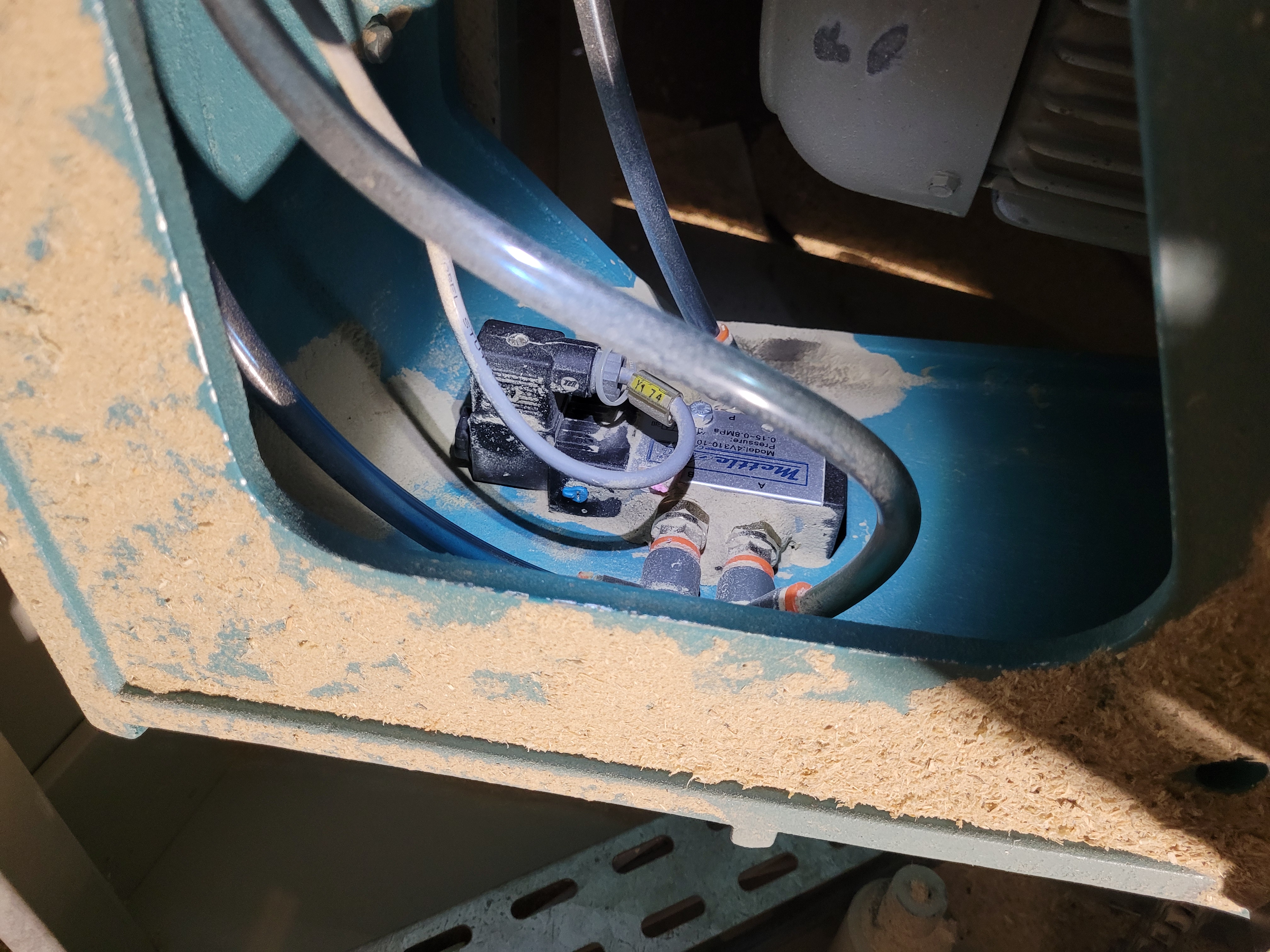

3/13/25       #17: Panel saw variation ...
3 pics.
1 with saw carriage down
1 with saw carriage up
1 of the valve that you need to manually trigger to raise carriage
