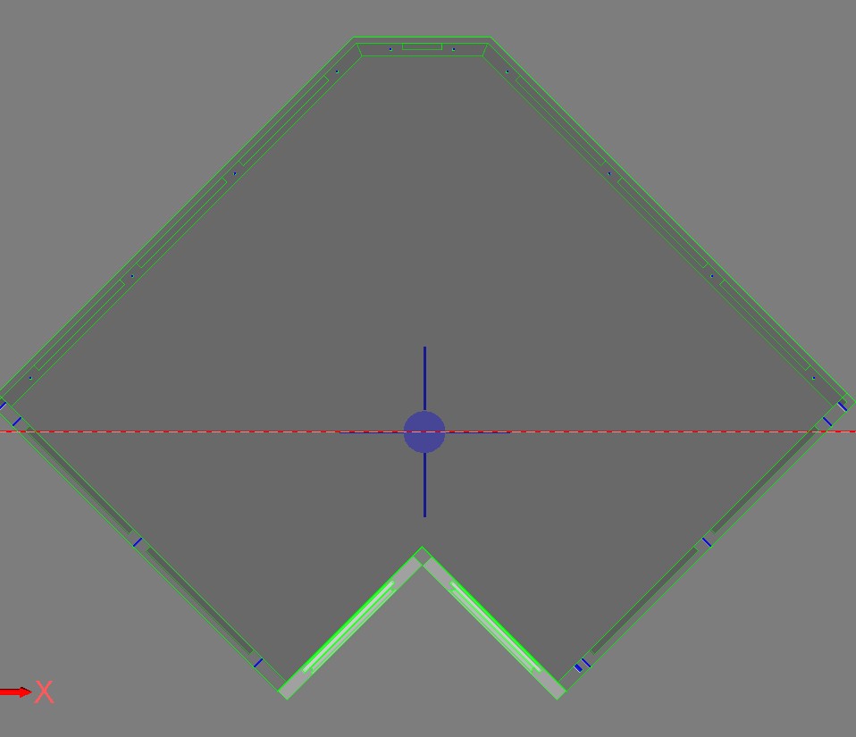

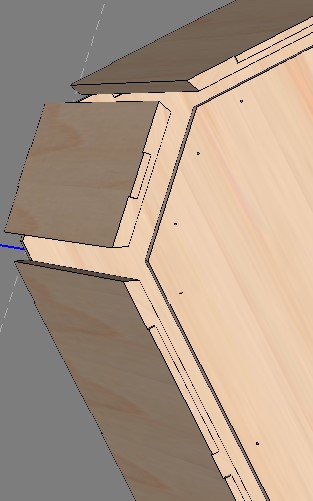

Never beveled edges before, but our current concept for corner cabinets has a detail needing bevels. See the pics.
