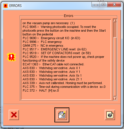

DEAR ALL,
MACHINE STOPS WITH THE FOLLOWING ERROR
PLEASE REFER THE PICTURE FOR ERROR MESSAGE
E CAT 1363
ETHERNET CAT CABLE DISCONNECTED
MACHINE POWER OFF
AGAIN I HAVE TO RESTART TO RUN MACHINE
View higher quality, full size image (431 X 448)
5/4/17       #4: BIESSE ROVER K 1532 G _ ERROR ...
ANTONY Member
DISABLING ANTIVIRUS, WILL SOLVE THIS ISSUE... THANK YOU

justin
I currently have the same problem as you on my biesse, but I don't understand why disabling the antivirus can solve the problem? We have been looking for the problem for some time and I just came across your subject... thank you

Michael L
I believe this is a bad connection from PC to PLC card. It could be a PLC card over heating but more likely a bad cable. Try replacing Ethernet cable from PC to the card that is going to servos.
