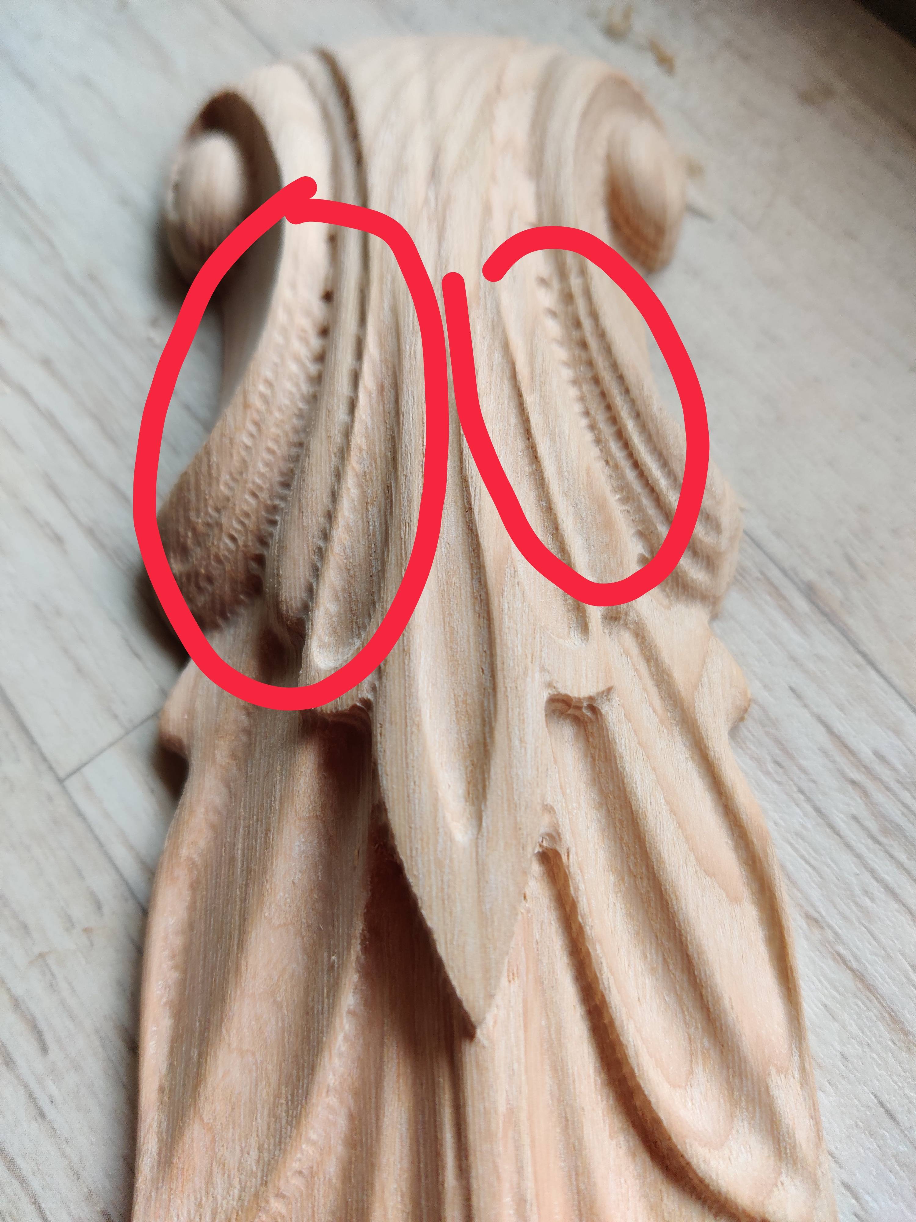

Hi all. Can you please tell me where these "waves" on the product come from and how to get rid of them?

That's a toolpathing issue. try a remachine toolpath in the area you need corrected.
8/5/22       #3: "waves" on the product ...
Mark B Member
Looks to me like something in your CAD file. Assuming this is machined from and STL?
8/5/22       #4: "waves" on the product ...
Machine rigidity issue. The valleys are where the bit is more fully engaged leading to machine deflecting. Recut with a shallow depth of cut and you will probably get better results
8/5/22       #5: "waves" on the product ...
Is that a 5 axis machine or 3? Conrol?
8/5/22       #6: "waves" on the product ...
Mark B Member
Whatever machine is it whether 3 or 5 Axis I would say RichC is correct and DO NOT BUY a wattsan machine... they look like junk.

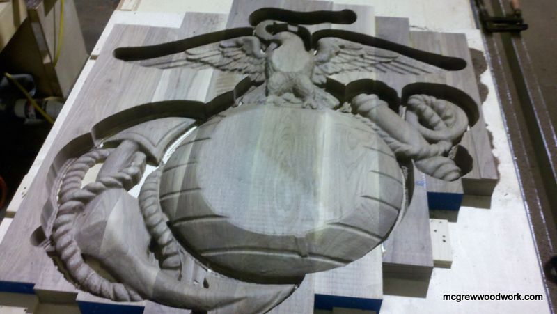

A ballnose bit will leave these marks due to stepover on rise and falls, try changing the angle of direction and just re-machine the specific area.
Which software are You using. if it is Aspire or Vectric give me a call and i can show you this online

The parameters set by the motor are unreasonable, too high or too low will cause high-frequency or low-frequency vibration to cause ripples.

thanks for the feedback)) I will check CAD files!
