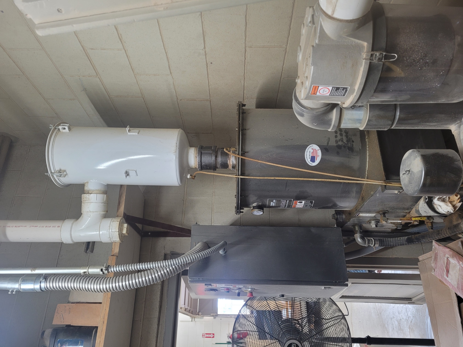

Here is our set up.
View higher quality, full size image (1875 X 1406)

Zak
It depends on what type of pump you have. The exhaust temperature from a liquid ring pump is very low compared to a dry vane pump. The exhaust from a Becker pump will melt PVC pipe. The exhaust temperature from a Travaini pump is very low in comparison.
