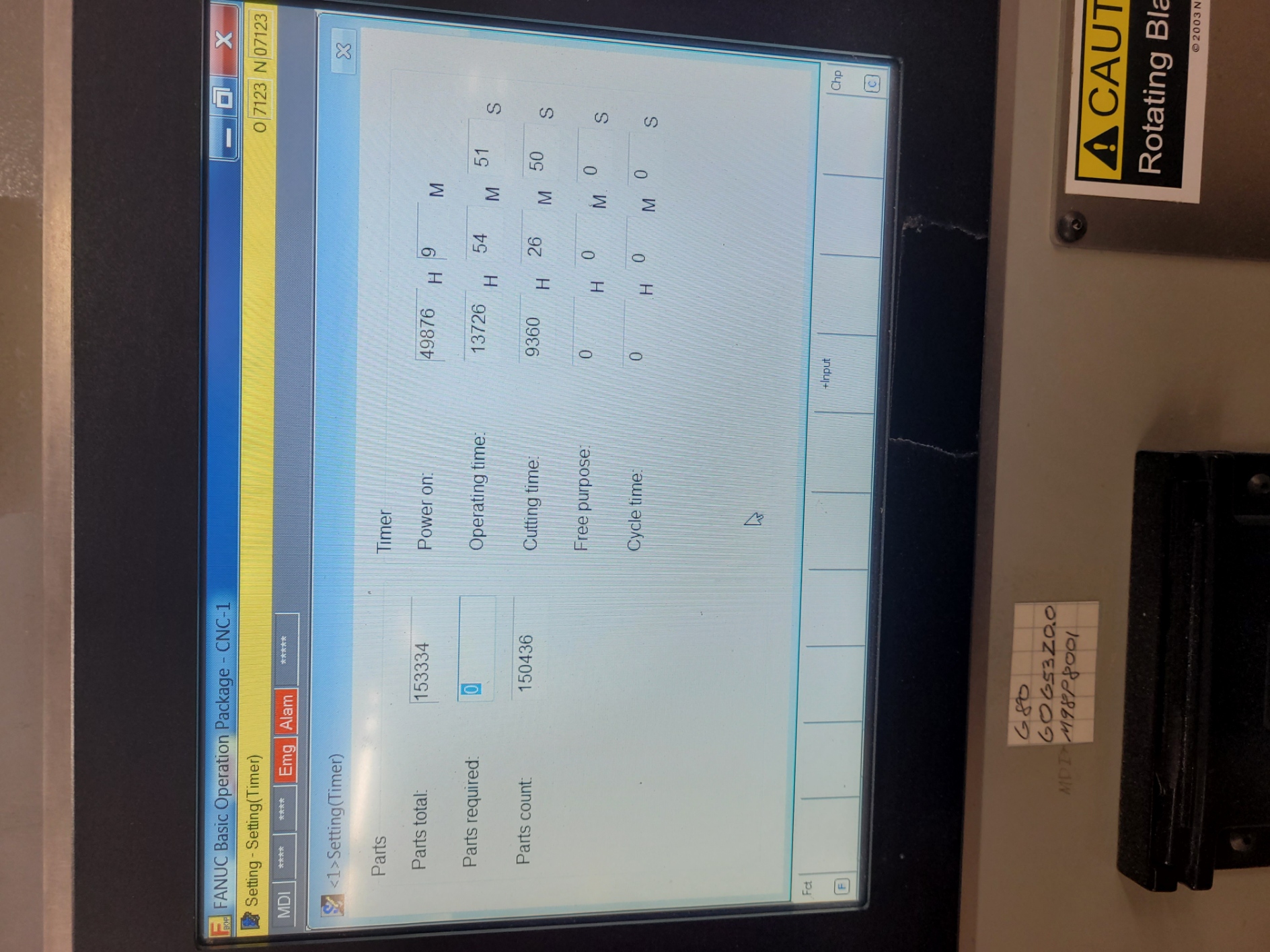

23000 hours may only be "on" time, not cutting time. There is a big difference. Biesse's seem to age fast. Make sure there is support for an elderly machine. I have been down that road with a different Italian company. The software evolves so much over the years, that I was left in a position where only 1 tech was vaguely familiar with what I was running. He had already left the company, but they were happy to give me an email address. My advice with older machines, is to buy something that has a stable control that everyone knows, by that I mean Fanuc. From my picture of the my oldest machine that still runs great, the "on time is almost 50000 but the cutting time is less than 10000. That machine was new in 2003. Good luck.
View higher quality, full size image (1888 X 1416)
