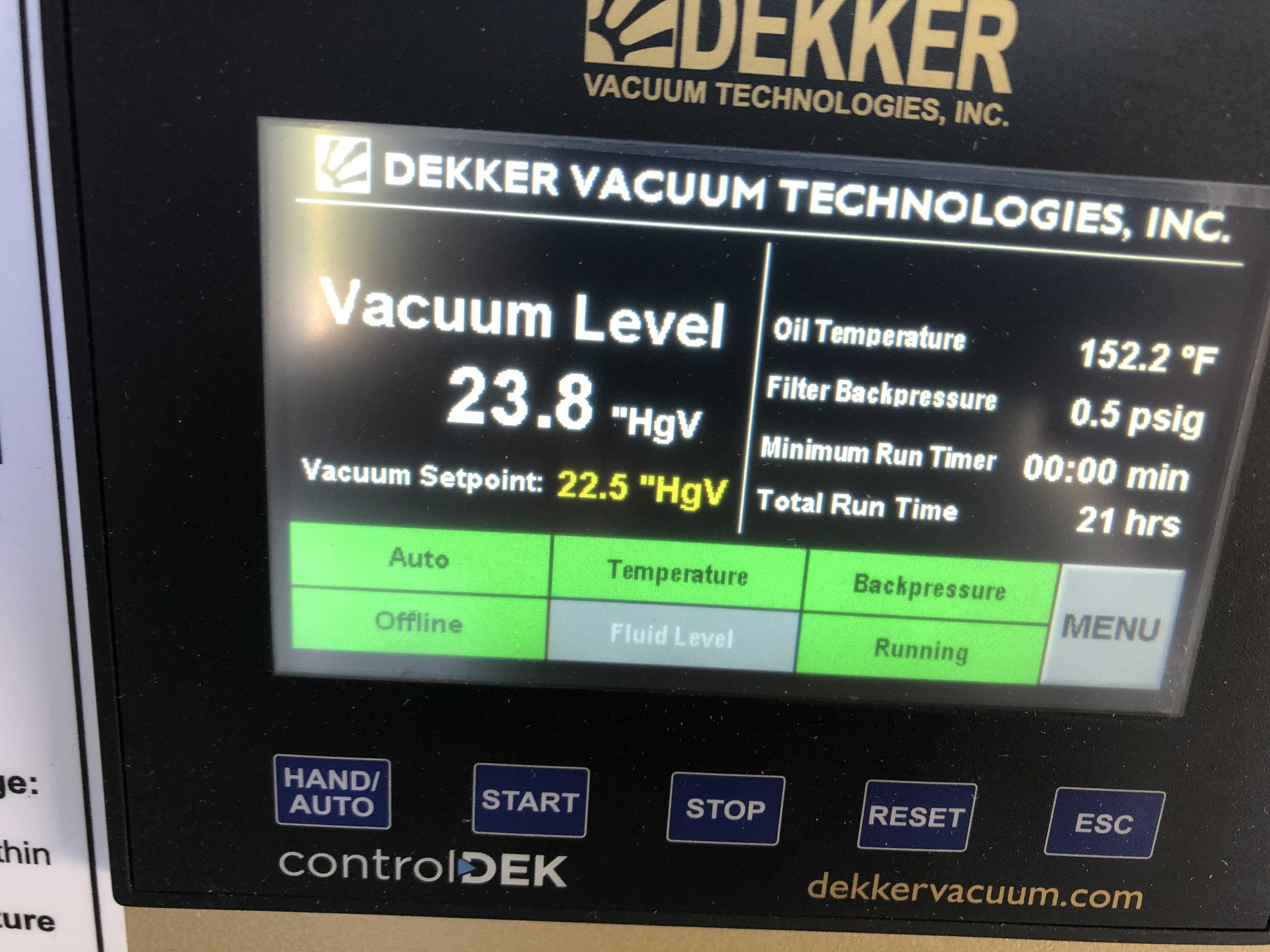

MICHAEL COLLINS Member
thanks everyone for your opinions
i did about everything that was mentioned above
sealed edges 2 times
went to mdf
milled both sides flat
screwed mdf to table
i have been cutting parts today
& it seems much better.
where i am getting confused is
it won't hardly pull down a slightly bowed
pc of laminate i am using to cover open
area past parts i am routing.
my vacuum is really good @ 23.8 hgv
but dont understand why laminate is not pulling down.
with an open sheet of mdf on top what should the hgv
be approx.
thx
mike
