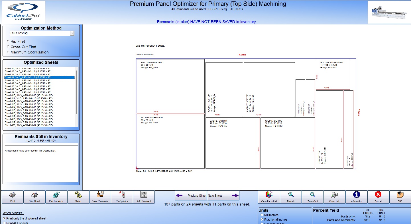

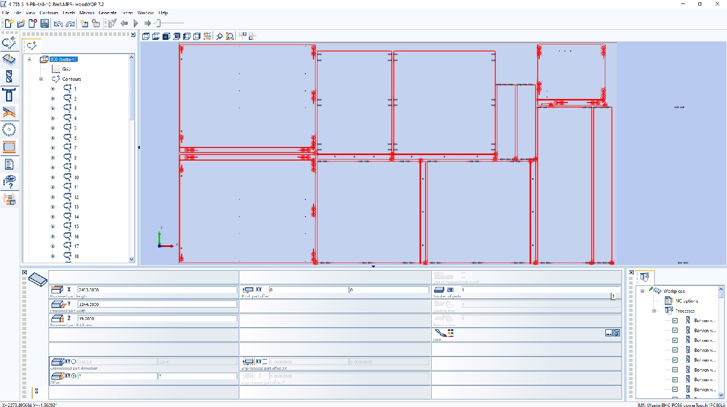

While Anderson is an outstanding machine and company, our customers (of Cabinet Pro software) who have the Homag Centateq N-300 480V7 are more than happy with this nested based router. Homag uses Woodwop as not only the interface between software such as Cabinet Pro CNC and its nested and point-to-point routers, but also as a very readable simulator showing machining in great detail.
In addition, I personally have a lot of experience with the excellent support Stiles Machinery gives to its customers who own Homag or Weeke routers, and to software companies such as Cabinet Pro who support Homag routers. Many of the features of the Homag, such as its Production Files that allow batched files to be processed with greater efficiency, are very convenient and time saving!
Whether you purchase an Anderson or a Homag router, both of which are supported by Cabinet Pro software, I am sure you will be happy with your decision because both machines and both companies are very impressive. My personal preference would be Homag because more of our customers own this machine, its integration with Cabinet Pro software is seemless, I am hopelessly in love with Woodwop (its interface), and to my knowledge, every one of our customers who owns a Homag router is happy with its performance.
The pictures below show a nested sheet in Cabinet Pro sent to Homag's Woodwop where vertical drilling, horizontal boring, dado cuts, and Lockdowel machining have been perfectly communicated from Cabinet Pro to Woodwop. Woodwop allows each of these machining operations to show more detail upon demand or be sent directly to the CNC Router for immediate processing.
View higher quality, full size image (1442 X 788)
View higher quality, full size image (1440 X 806)
