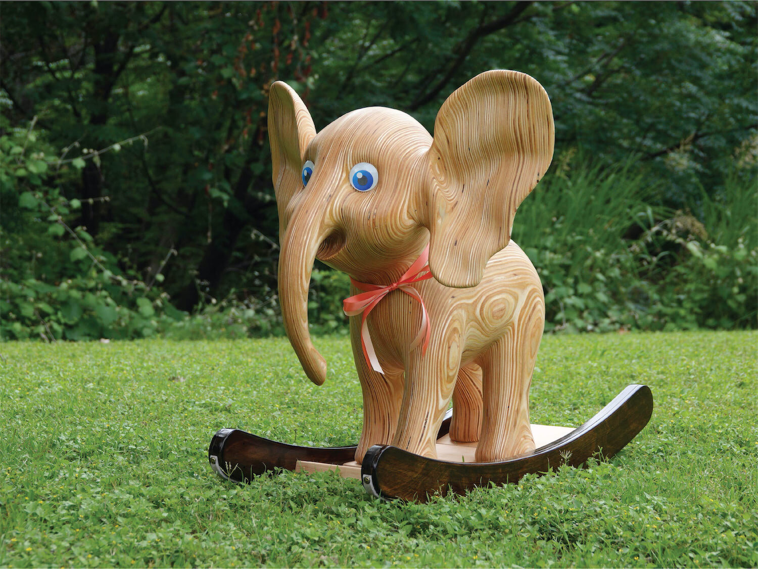

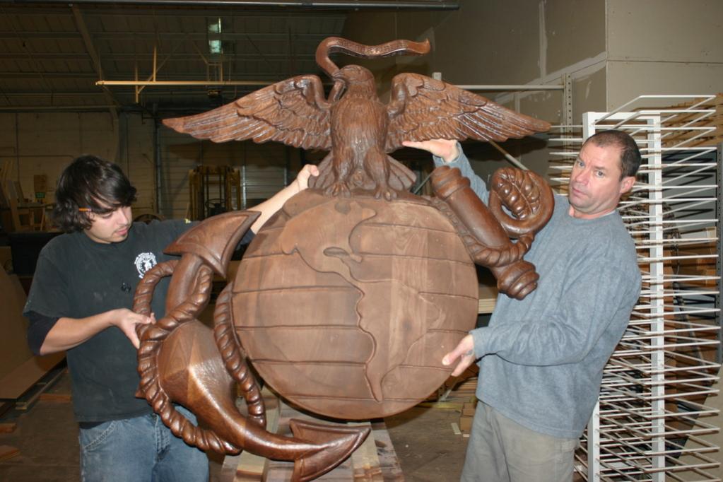

For example, the attached images are things that were possible, whether by laser cutting layers and spending many hours gluing, hand grinding/sanding, or by hiring foam sculptors which are increasingly retiring in our area, and the ones that remain have very long lead-times. Granted, the Z-axis on most of the machines we're looking at is not enough to do any of these without doing them in layers, but it would be far more efficient than the way we've done it previously.

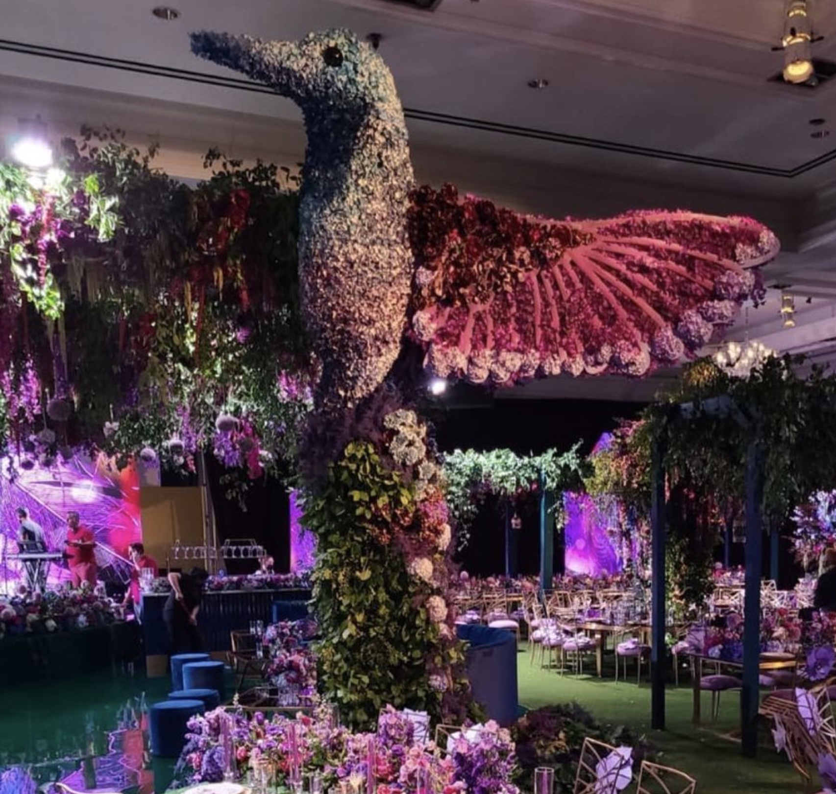

The hummingbird is actually very simple. The exterior is all fresh flowers that the Florist did. Our job was to build a core from foam that they could stick stuff into for applying the flowers. We did it by slicing a model and cutting the slices from 1/2" foamcore and gluing them together. The wings were a bit more complicated... they needed to have two layers with a gap between to hold the floral foam. So we did a layer of lightweight plywood and a matching layer of 1/2" foamcore with spacers between. It worked, but I don't think the florist liked the foamcore due to the paper layers and all the glue.

Coming from the 3axis world and having done a good bit of the slicing/carving you mention I still cant help but to wonder if something even like that elephant is still not more cost effective to slice and carve/clean up on a one-of than generating the file and code and the time and fixturing to 5 axis a single item at that scale.
I could see it if you had a demand for 40 of those elephants but for one (and I know the talent for grinder carving/sculpting is probably a bear) Im not sure.

The bird however, that was part of a week-long mad dash by over 100 employees to prepare the site and install a literal plane-load of floral for a single wedding. We don't judge though... it pays for our toys-I mean tools. The elephant was a personal project... and is at least 40 hours of grinding/sanding after having done it a few times, so cost-prohibitive to sell in that form. I think there is a market if we could get the cost down. It doesn't have to be cheap, but not $10,000 either. That would become a high-end product line, so it would be worth developing.
