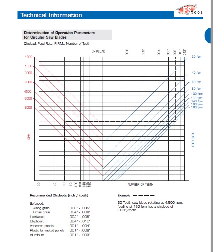

Dylan Bayliss
Please find below. Guide for other materials and chiploads
db

12/13/22       #5: Saw feeds and speeds for solid wood ...
Mark
Dylan,
Thanks that is some good detail, very useful. I will keep it on hand.
Malik's numbers check out with the chart too.
