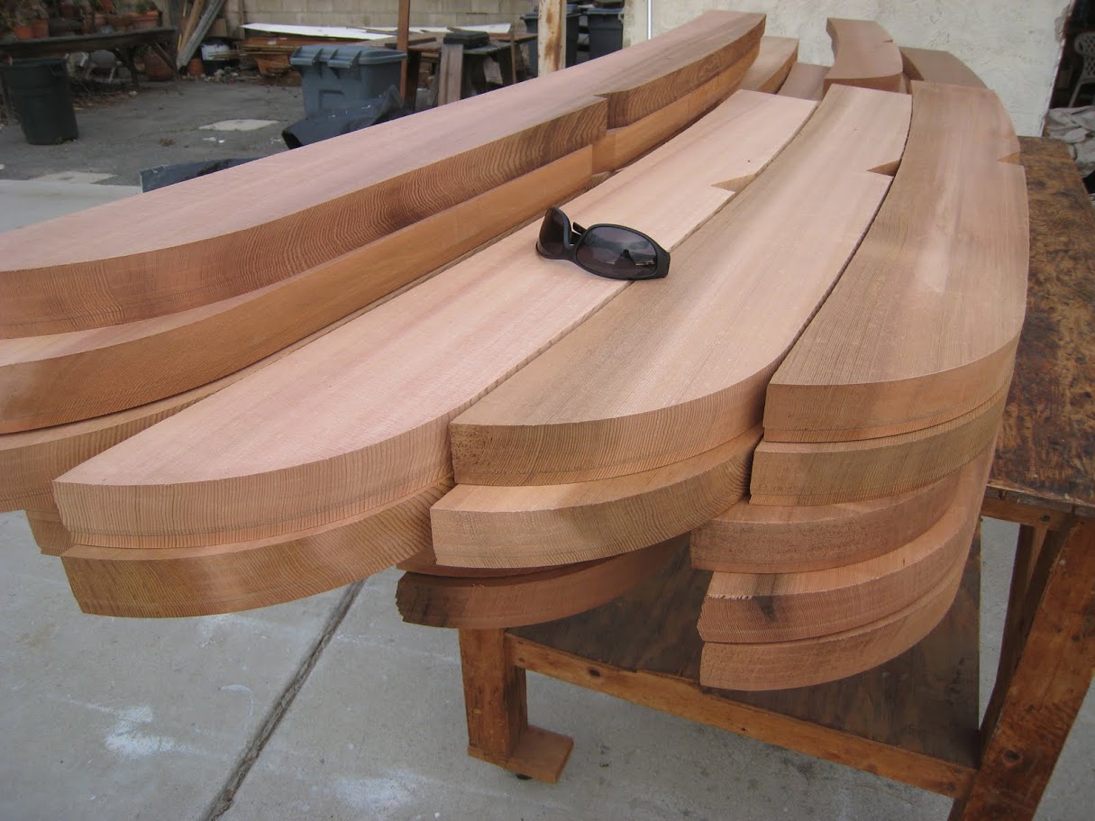

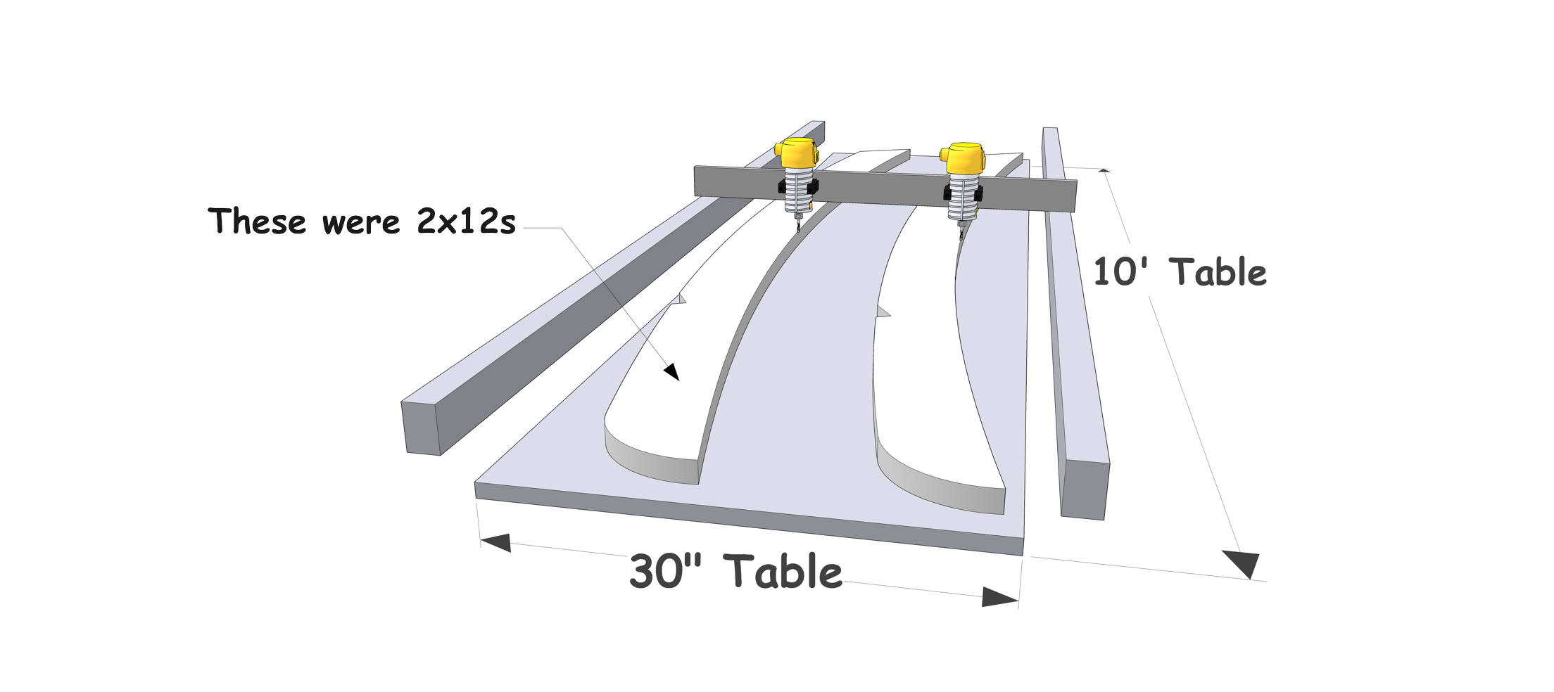

Folks, I need help and advice to come up with a simple CNC router table for one task, cutting these curved rafters from 2x12 clear cedar and redwood. Being able to cut two at a time like I show would be nice. I need to keep the cost down and don’t need anything fancy, so no bells and whistles in the software, or range of operations the machine will be able to perform.
Is something like this doable, and can anyone recommend someone in the San Diego area who could build this for me?

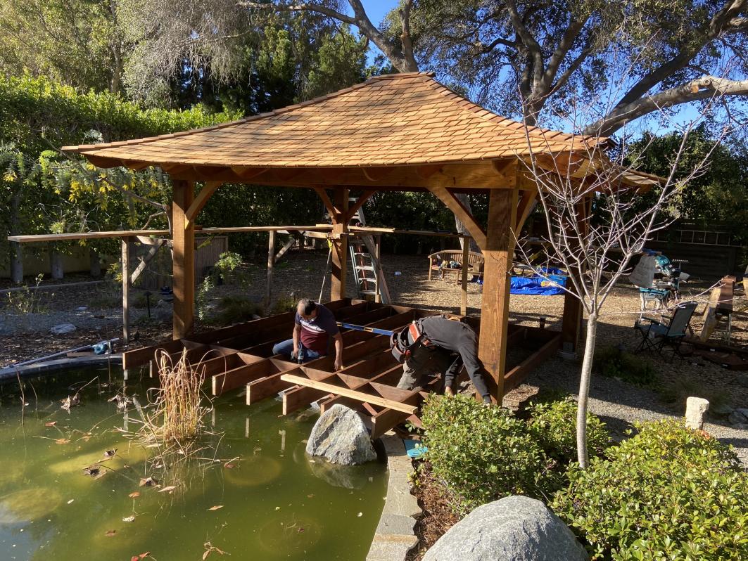

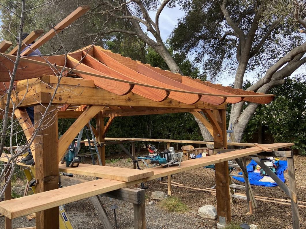

These are others I've had cut, and what I build with them. https://woodsshop.com/kits/gazebo-pavilion-kits/

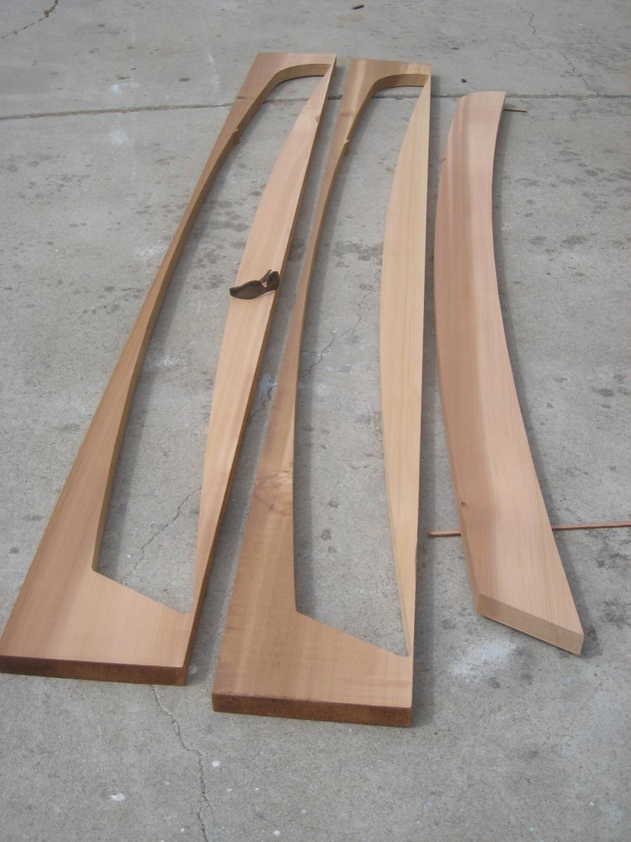

Some more pics.

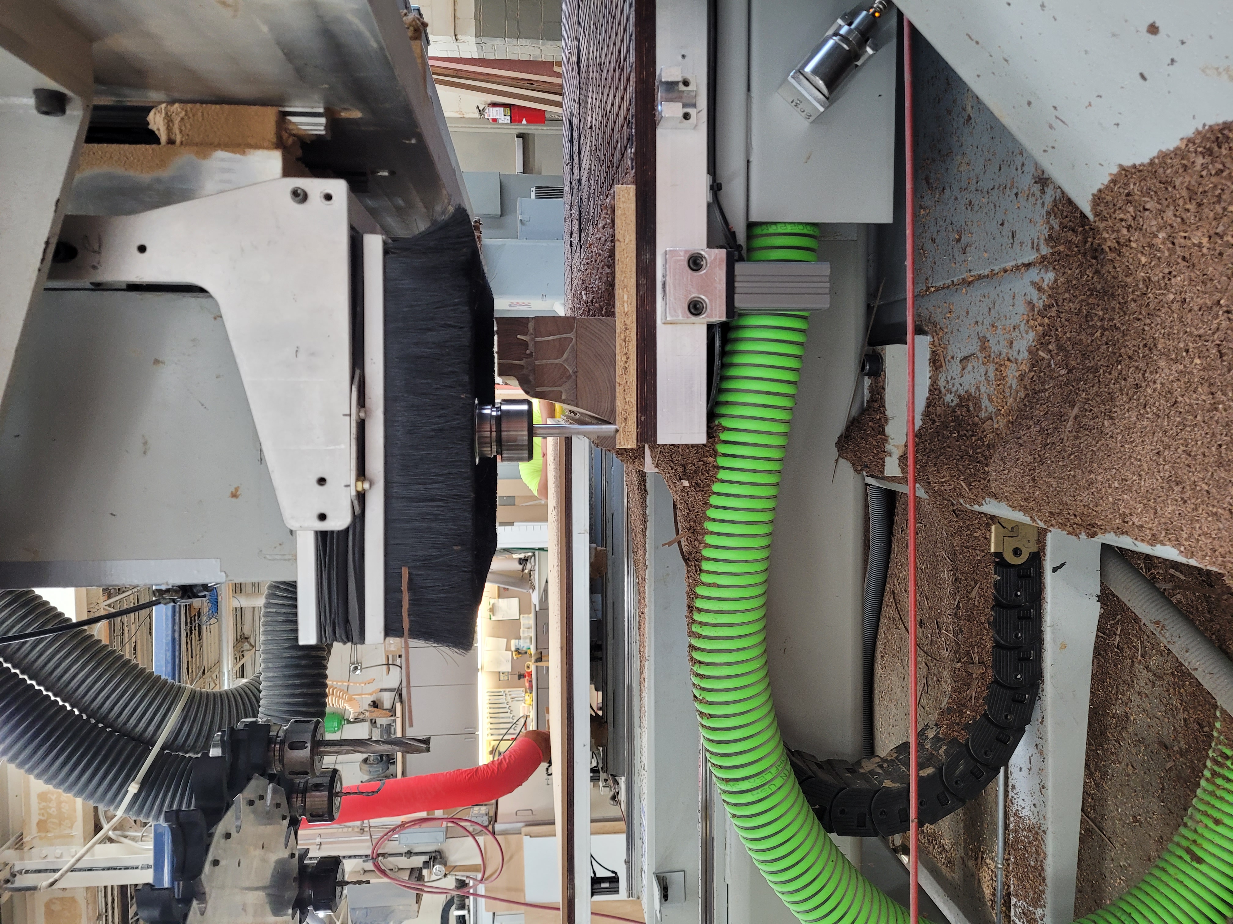

Flat table will work best. Make the table out of non porous material like melamine. Cut a Chanel tor 1/8" x 1/4" gasket. Cut a recessed area 3/16" inside the gasket. Now thru holes in the recessed area to access vacuum. You have now made a pressure fixture that is solid for holding solid wood parts. I'll attach a picture of a solid on such a fixture.

This can be done on either a pod and rail or a flat table machine.
The big one is the length, for flat able you’re probably looking at a 5x10 machine. Your first pic shows it doing 2 at a time with “hobby” routers. A big CNC is going to run a 10-15 jp spindle and runn all day doing this type of part. On a flat table you could screw done or fixture material in place outside of the part area. Depending on speeds and feeds, you would cut in 2-3 passes. To keep part frequency m moving you could onion skin it or leave tabs that hold it in place so it doesn’t move. I’ve never run anything like that but I can see a single part coming off machine I about 3-4 minutes.
