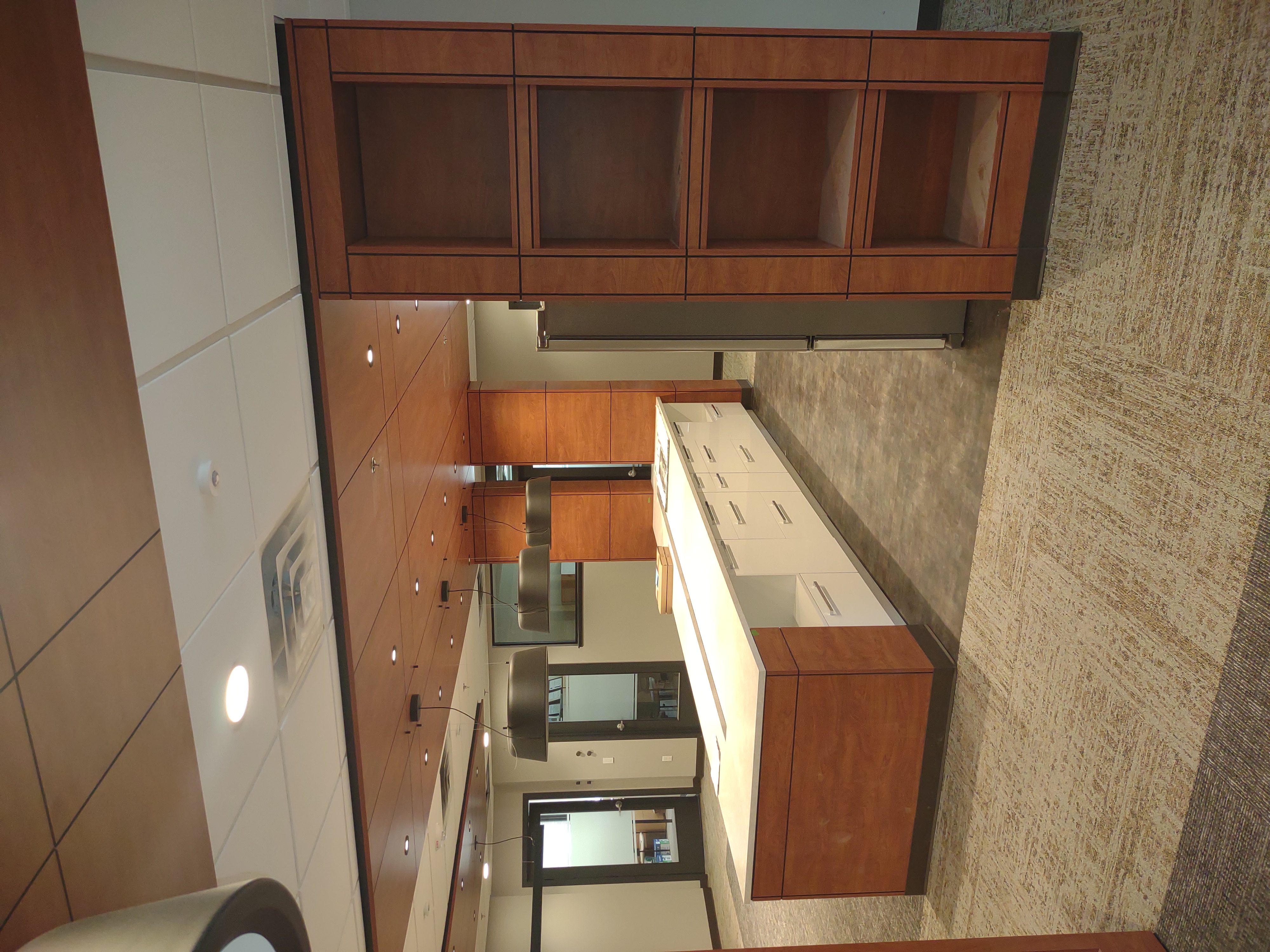

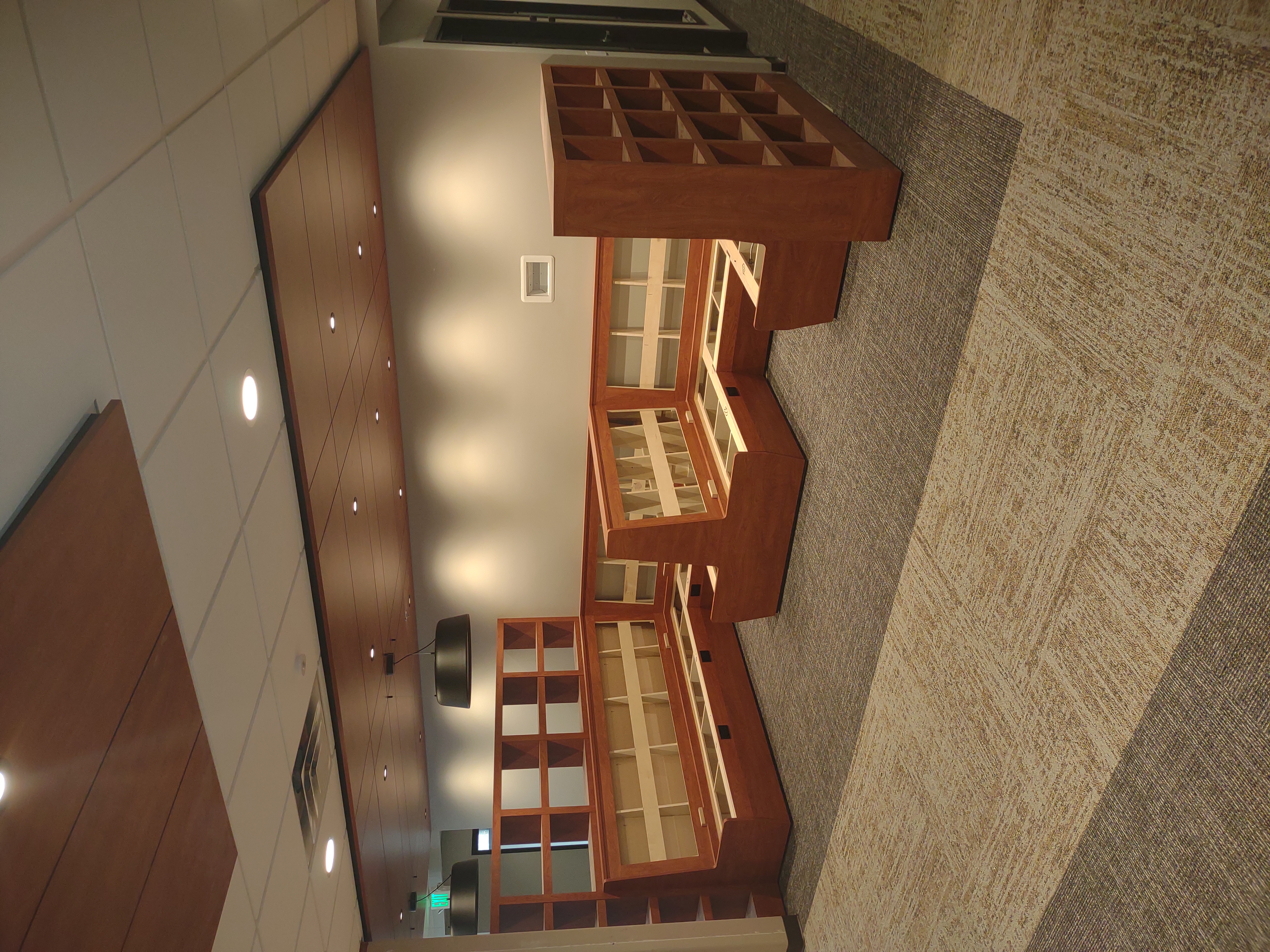

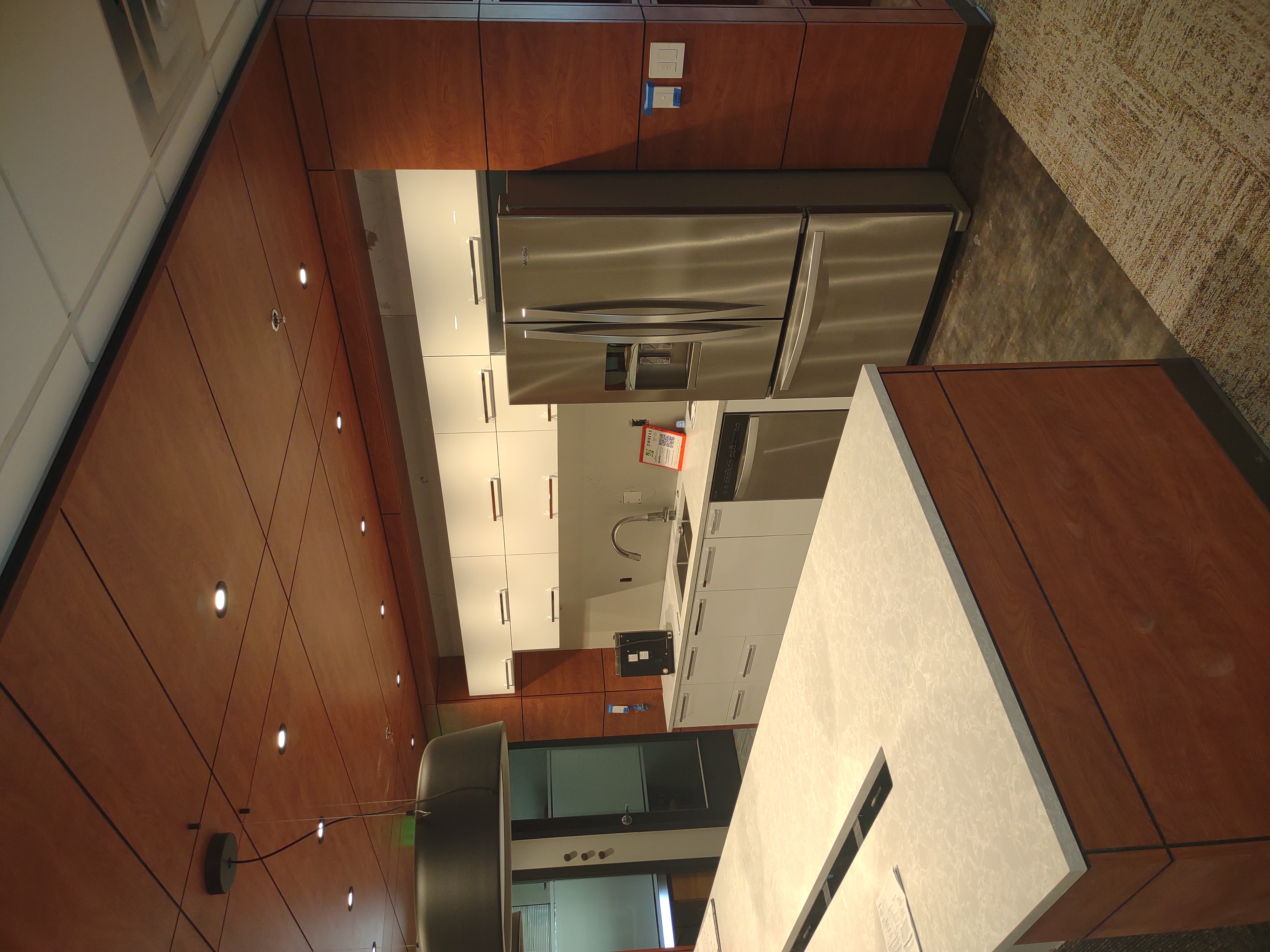

The Photos are for a job we engineered , built and installed.
It consisted of 54 sheets of Laminate in wild cherry ( ordered as layups )
5 sheets of mirlux high gloss white, 12 sheets of white melamine 3/4 and 5 sheets of white melamine 1/4 and 9 sheets of 3/4 plywood ( booth ribs and structures. A good amount of foam and Boltaflex fabric for the booth seating.
I would be curious as to where others would price this as most that I have talked to that have seen it put it in the 125,000.00 to 150,000.00 range meaning that I left a TON of money on the table.
