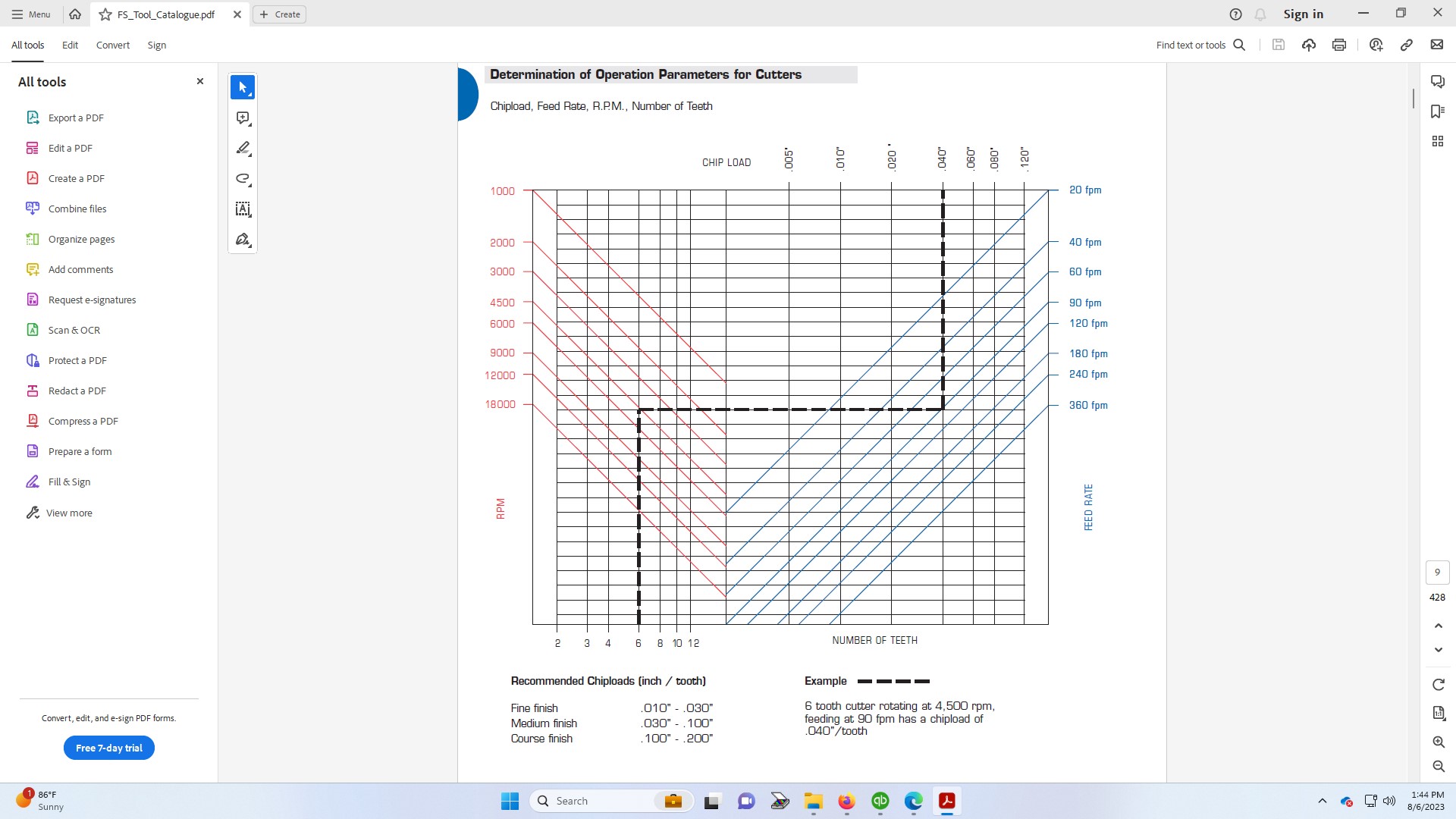

most drill heads have an rpm range either fixed or variable in wood @ 4000~7000rpm. I would use 5000rpm (std rpm in most drill heads) and a plunge rate of 40in/min with program feed of 160in/min
That will produce a chipload of 0.016", assuming 2 flute drill, you can increase feed to increase chip and save tool life or increase rpm to ensure a cleaner hole, but sacrifice the bit.
Hope that helps, I attached a the FS Tool Chip Load chart and our guide to chip load with a calculator mid way down as well.
regards
db
www.cnc-tool.com
https://www.cnc-tool.com/technical-white-pages-chip-load.html
