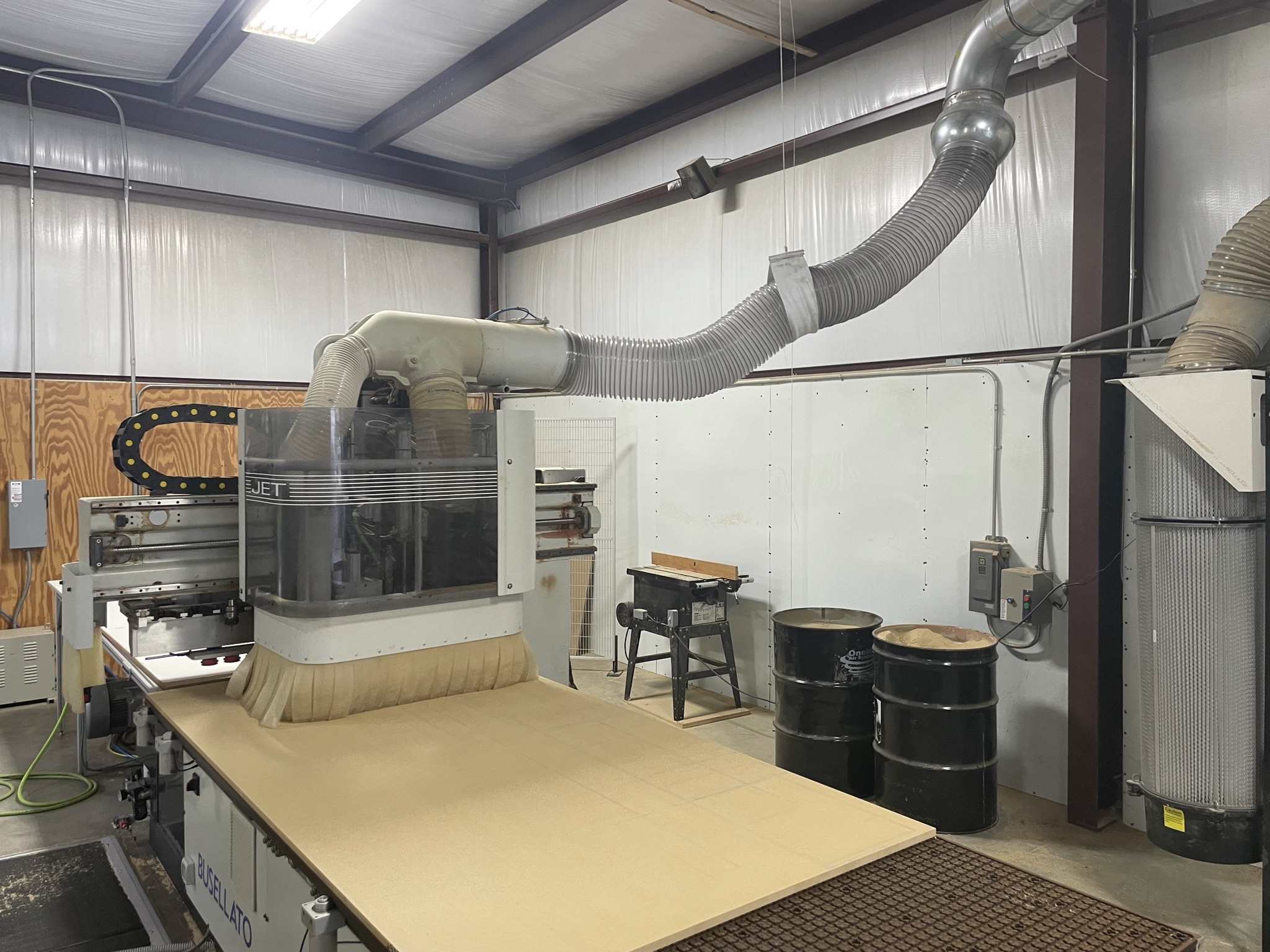

Do you have a ball joint at the top? Is the center of the hose supported?

We don't have a support or a ball joint on ours like Robert does. Ours is central over the middle of the 5x10 table. However, seeing how Robert has his makes me think of a few possibilities we could try here. Thank you for sharing that pic.
