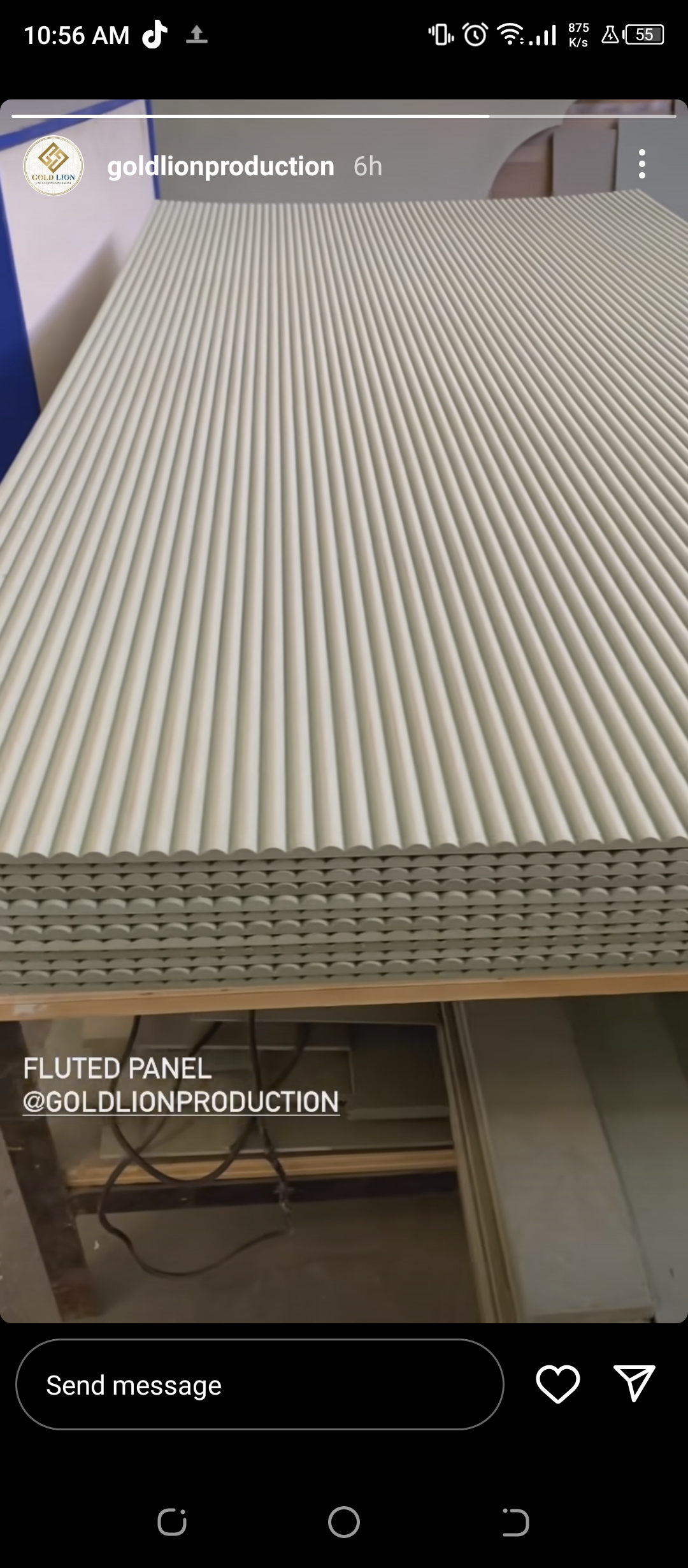

Hi all hope your doing well
I am having a problem regarding mdf panels on flat table when working with sheets the mdf will curl and the product will be ruined
How are you fixing this problem
Thank you kind people's
View higher quality, full size image (1080 X 2460)

I have seen this before, the only solution I found was to use my surface tool and take a few thousandths off the back side before machining the front side. or slightly scoring it on the back side with a small engraver or v bit.

You can also give it a coat of Laquer sealer in Back

This is happening because you are removing the hardened skin from the top of the panel but leaving it in place on the bottom. This causes uneven stress on the panel and makes it cup towards the machined side.
As said above you have to remove about 1/32" from the back of the panel first.
Oh......and I've always referred to that is a beaded panel, not a fluted panel. Beads project out, flutes cut in.

Start at outside and move in to the center.
Left outside, right outside, left outside less one, right outsides less one etc.
Plastic staples on the edges can help if you can get away with it.

1-mr Jim Anderson will removing some mdf from the other side will the mdf sheet still be flat after turning it ?
2- i will try buying some plastic pin nails do i need a special nail gun ?
9/11/23       #8: Fluted panel on flat table ...
We use Raptor nails. They are 15ga so need a gun for that.
