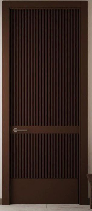

hello hope your all having a good day
i have a project to make like the door in the picture
i have a cnc machine any tips on how to make this door? any thing will be much appreciated

If you have a CNC then you should be able to come up with a program to make the cuts. Lots of right angle inside corners, though.
The first thins I would decide if this is to be subtractive or additive. Will you cut the door out of a larger slab? Removing wood? Or will you add pieces to build up a door? Or both?
Is it wood? Or man made? Veneered? You have a lot of questions to answer before your question makes sense.

Hi Anthony,
As David mentioned, we would need to know a little bit more information to give the most useful advice. However, I can give some what of a guidance here. If you have a pod-n-rail CNC you could use style and rail bits to achieve the outside joinery. From there, you would focus on the panel inserts (top and bottom) I would recommend doing the detail work on a panel of your required thickness with a dado or v-groove bit. At this point a glue-up clamping and finishing would be the next steps.
From the image, it's hard to see if the outside frame is a part of the door itself or not. if not you would likely need to do a glue up before hand unless you have stock already in that size and route the detail work and the handle hole. If this is the case you don't need a pod-n-rail set up

You can draw this in a cnc program. check out the tutorials on youtube.
