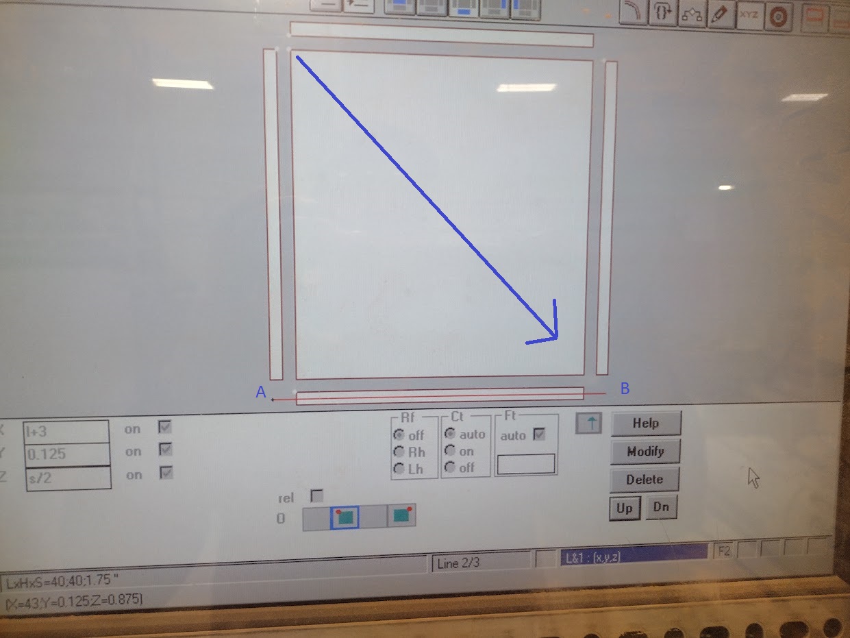

I'm attempting to fix an issue that happened many years ago before I was involved. The short version is the manufacturer's tech accidentally wiped out all our machine parameters in Genesis, not Evolution, the old version. At the end, he was unable to get the universal aggregate working correctly.
This is what the machine currently does when running a program utilizing the aggregate. On a straight line cut from point A to point B on the x axis, the aggregate does travel from point A to B, but travels at a -45 degree angle on the y axis. Picture attached.
I have adjusted the alpha angle. I have enabled/disabled tool compensation. I have adjusted the tool settings. Nothing seems to have an affect.
I'm hoping either someone has enough experience with Genesis to help rebuild the broken/missing parameters or refer me to someone who might.
