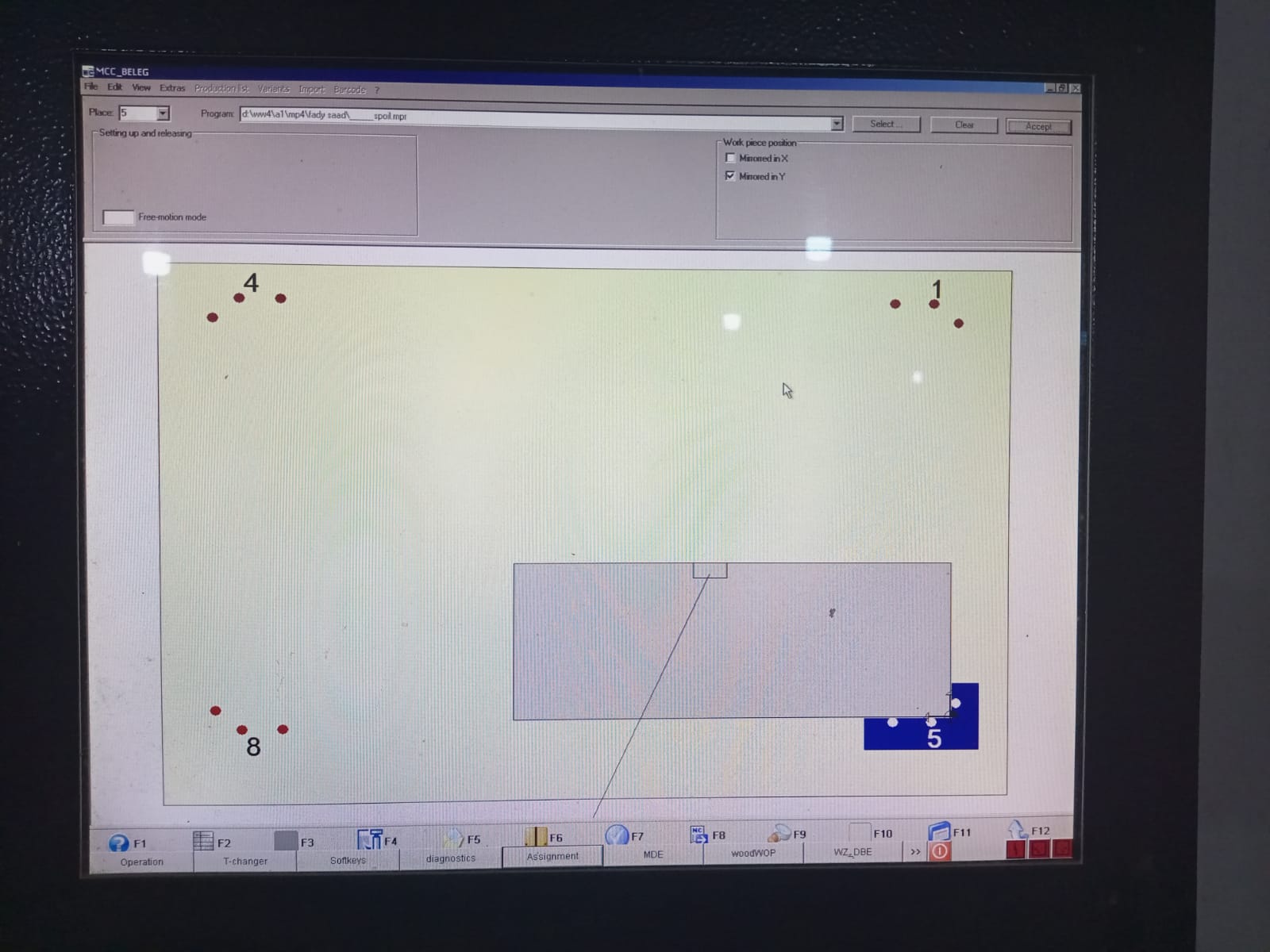

i have been working on my cnc for over 4 year
today for no reason i am facing a problem that is when i load any file to the assignment tab and i try loading it by pressing the accept bottom on the top right window and nothing happens

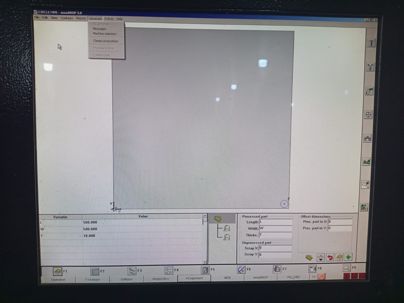

and i noticed that in the woodwop tab while pressing generate i cant even press on the nc generate button

The (2) pics attached are (2) different MPR files!
The CIRCLE.MPR ... looks to be POLYGON CUTTING with NO toolpath to generate ... thus why NC Generate is disabled / greyed out. Then in Zone 5 you are trying to load __SPOIL.MPR
