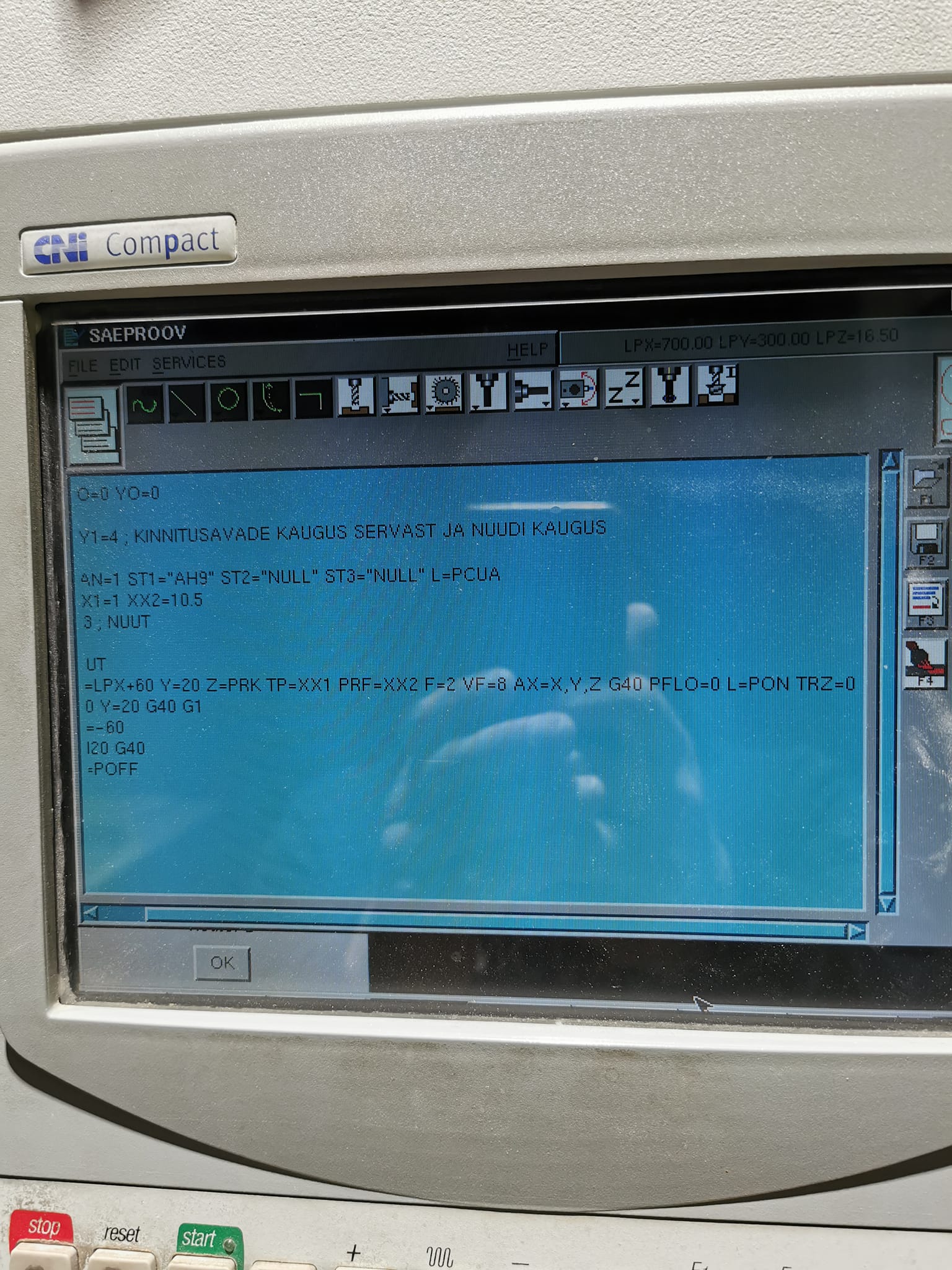

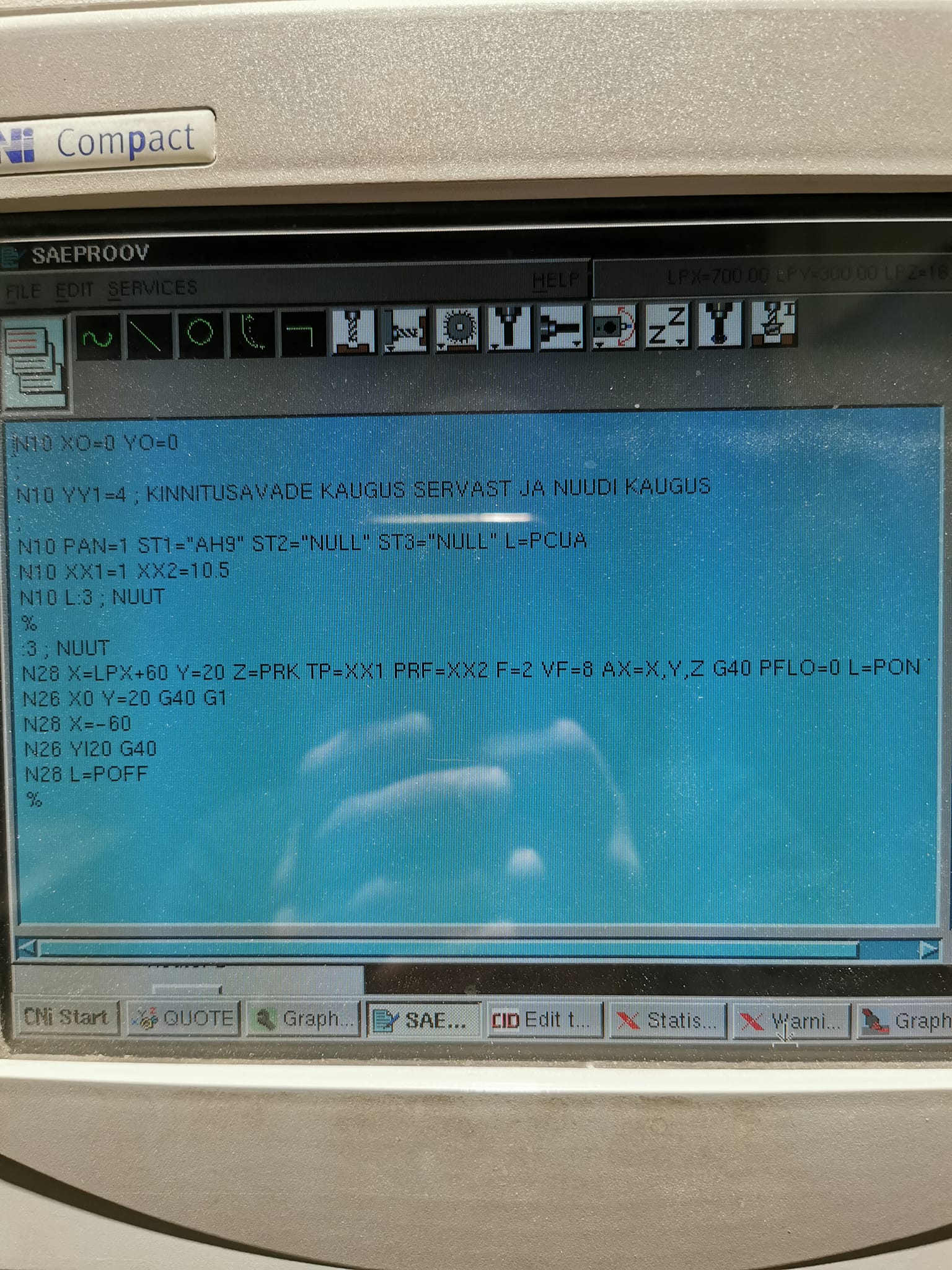

Hi. I am looking for help for the Biesse Rover 24 machine. The machine works with aggregate and milling only in the left working area. In the right work area gives such an error message - INT 143 - Cannot execute Program line. Non existing spindle. The problem is not only with the agregate . The machine has two spindles and does not perform the operation with either milling spindle on the right of the work area, regardless of which instrument is installed. Sry my english, hope you understand, what I mean. Best Regards!
