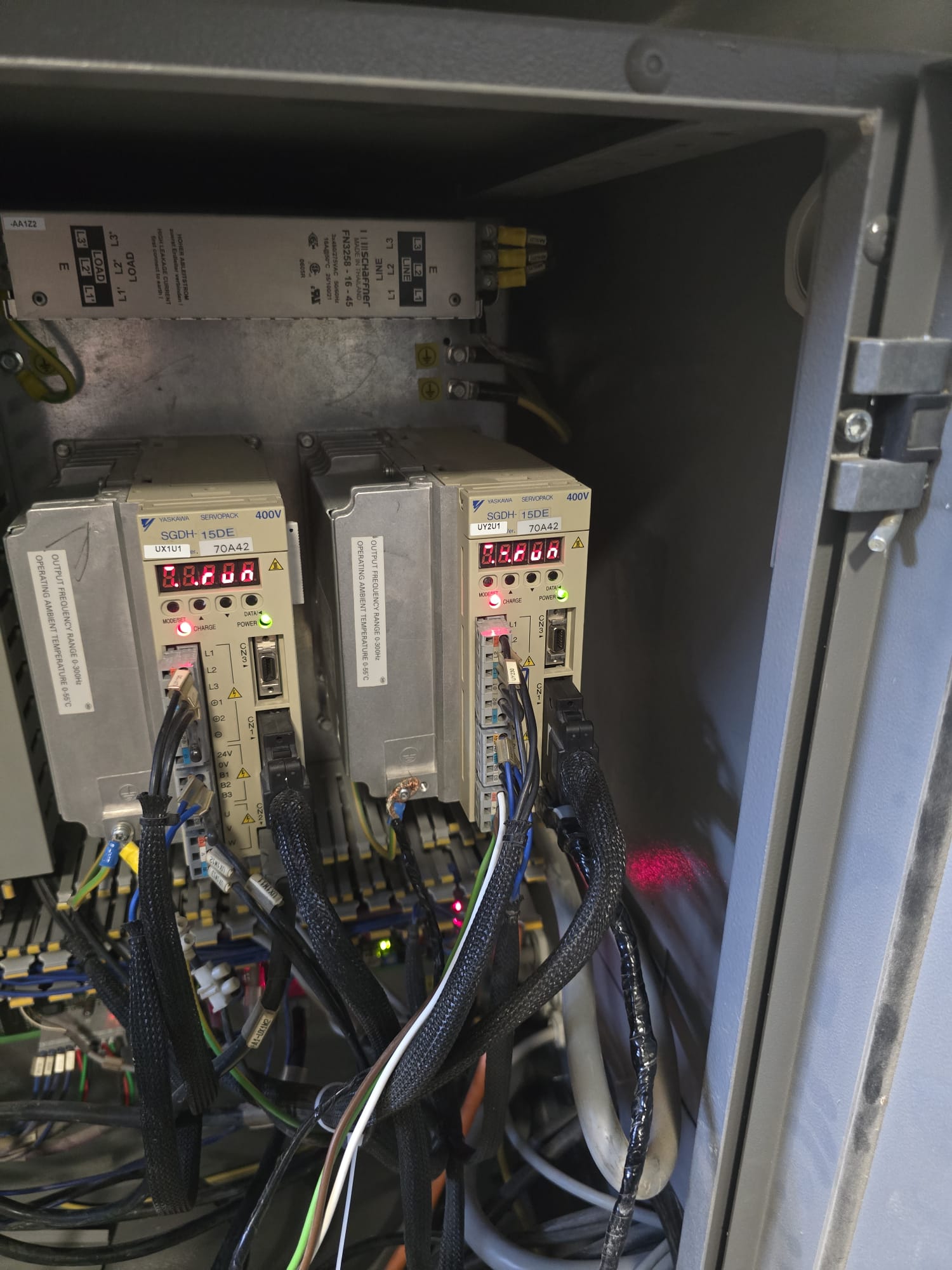

Hello everyone,
​I need some help with my Biesse Selco EB 80 panel saw (Serial Number: 72010).
We had to replace the Yaskawa servo drive for the Pusher axis (Asse Spintore), but I don't have the factory Pn parameter list to configure the new drive. The local dealer is refusing to give me the parameters without a very expensive service call.
​Here is my hardware setup:
​Drive Model: Yaskawa SERVOPACK SGDH-15DE
​Motor Model: Yaskawa SGMGH-09DCA-YG25
​Does anyone have the same machine or access to the Biesse database to share the correct Pn parameter list for this pusher configuration? Or maybe a backup file?
​Any help would be greatly appreciated. Thank you!

If your old drive will still power up, you could capture the parameters from it or possibly send them both to a yaskawa service center and have them do it,
