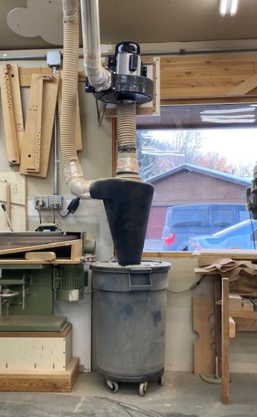

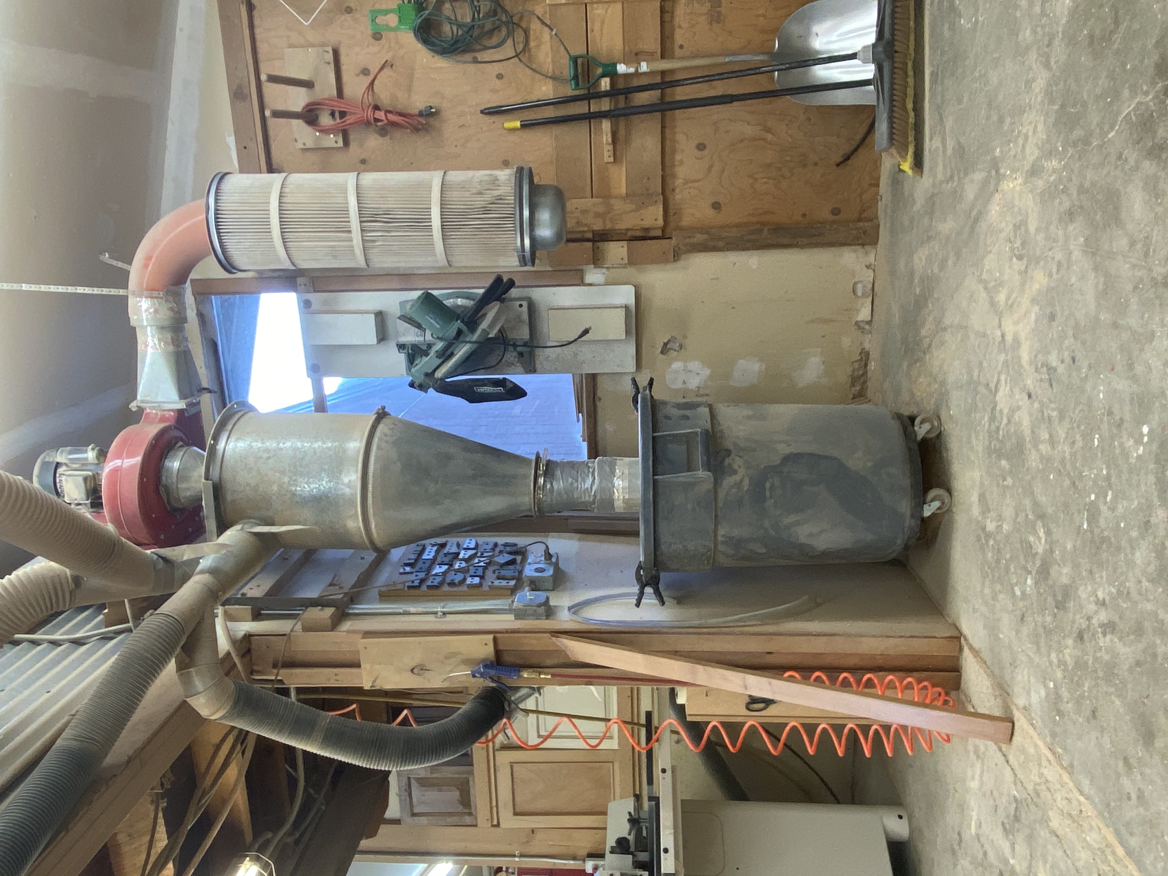

duster
Mark - pictured is a 3 hp blower and cyclone which drops into the Rubbermaid trash can, exhaust air goes into the canister filter. I have another for my cnc with a wall mounted blower and an Onieda cyclone mounted directly to the lid of a Rubbermaid can. On that one, the exhaust blows back into the original filter bags. I haven't ever had a problem with the Rubbermaid containers collapsing, but these are only 3 hp motors.
11/24/20       #10: dust collector fills one bag much f ...
duster
Here's my set up for the cnc. Wall mounted 3 hp blower above an Oneida dust deputy cyclone bolted directly to the lid of a Rubbermaid 35 gallon trash can. Exhaust air goes to the filter bags that came with the motor. I can fill the trash can 10 times, and have only an inch or 2 of dust that blows by into the filter bags. I spent about $250 on the parts to do this, on top of the original dust collector.
11/24/20       #11: dust collector fills one bag much f ...
duster
Here's the photo of my set up for the cnc.

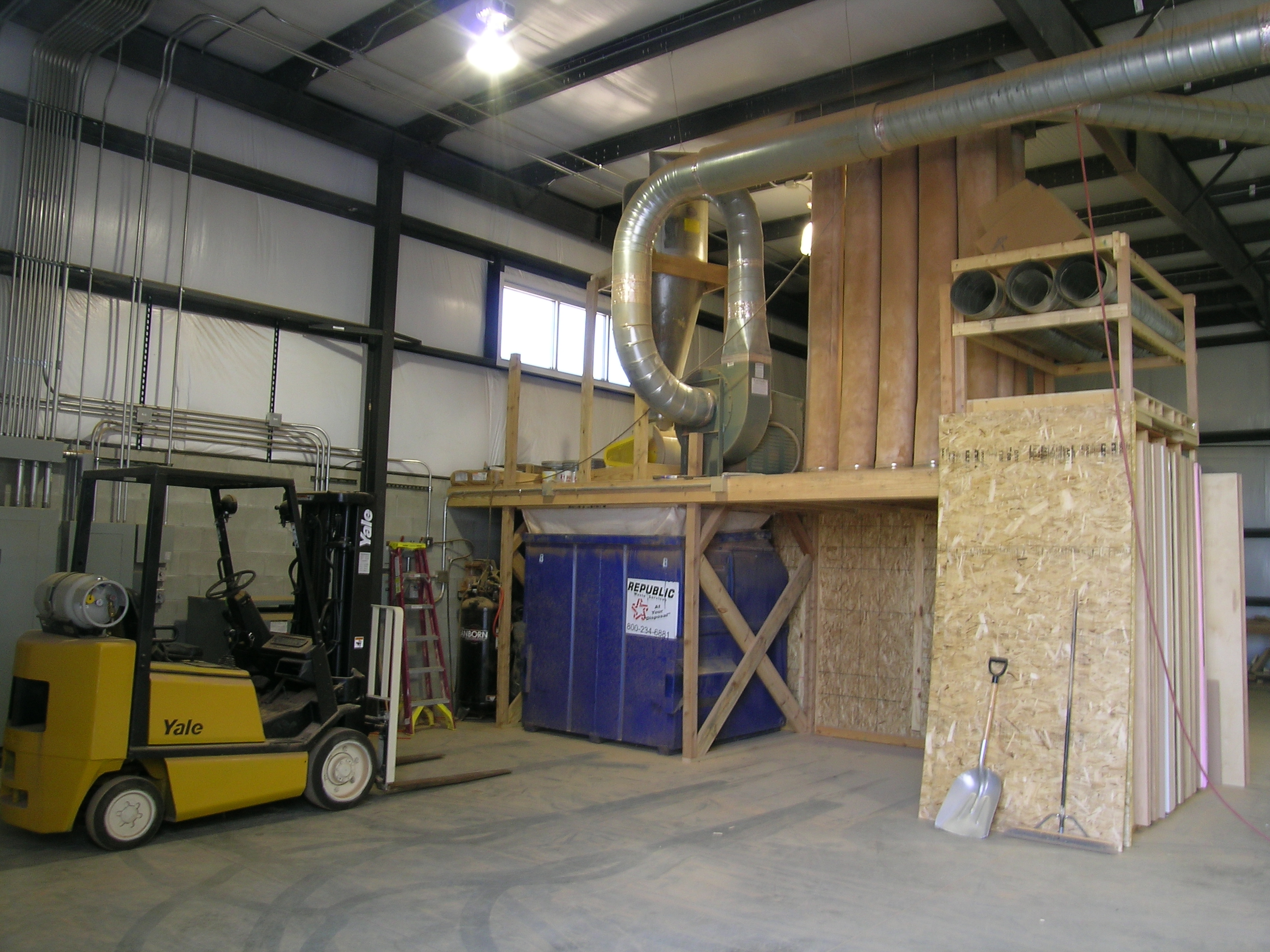

Not to be left out, here is a photo of a previous installation that worked very well. The sequence was: pipe in from machines, cyclone with rotary airlock below (drop into dumpster), then to the fan and then into the filters. The fan was not first since we had horse people hauling the shavings and they liked them fluffy. It was determined that if the shavings did not go thru the fan, they would remain large and fluffy.
(Sidebar) That meant nothing when they complained that the high percentage of Mahogany was turning the hoofs red and they were getting points off in the show rings. They moved on to other materials, and we just compost it now.
11/27/20       #13: dust collector fills one bag much f ...
Let me correct myself..... That photo is of a fan first set-up, used to maximize the draw.
Sequence: Pipe from machinery, fan, cyclone with RAL below, then filters.
