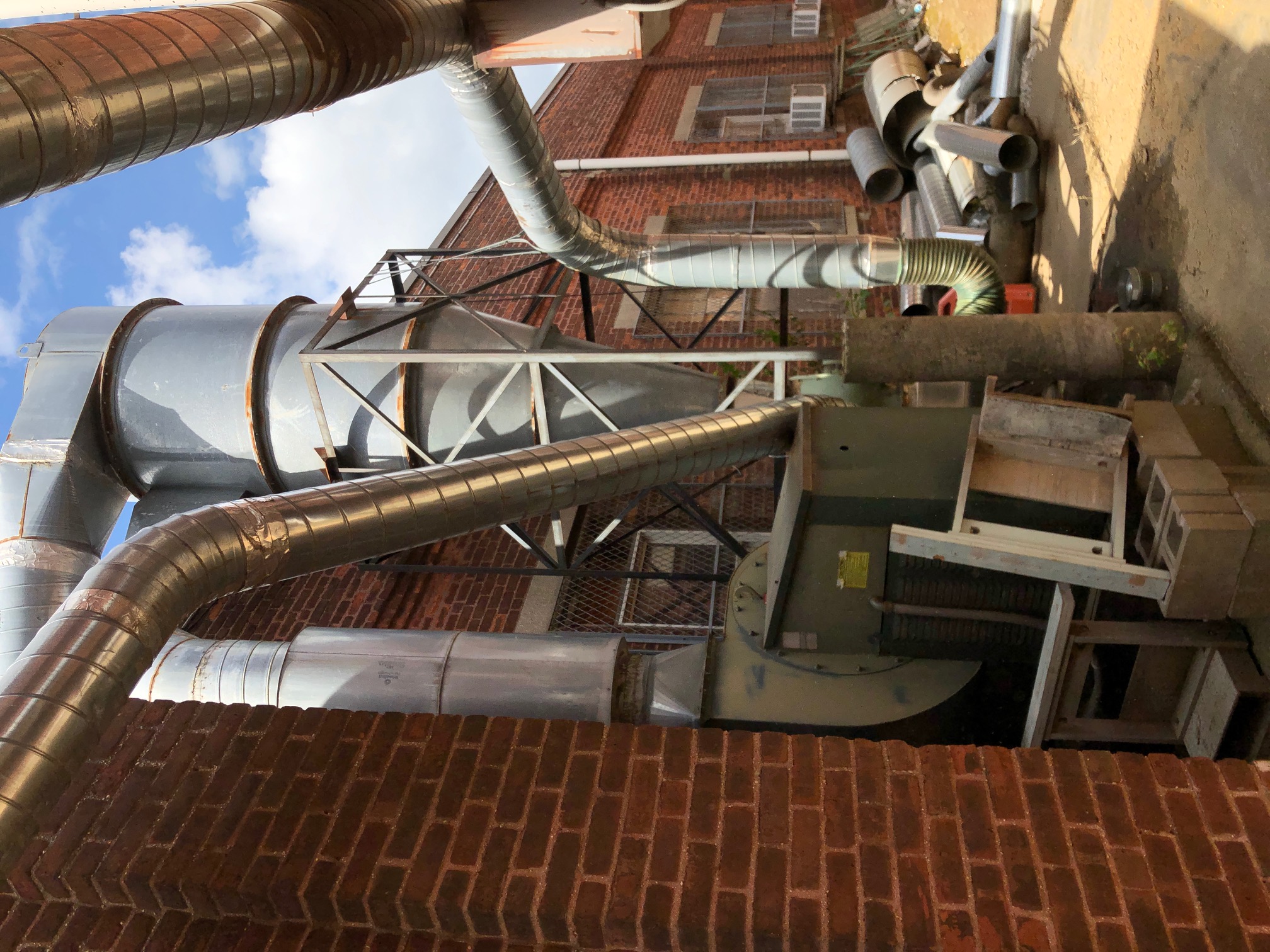

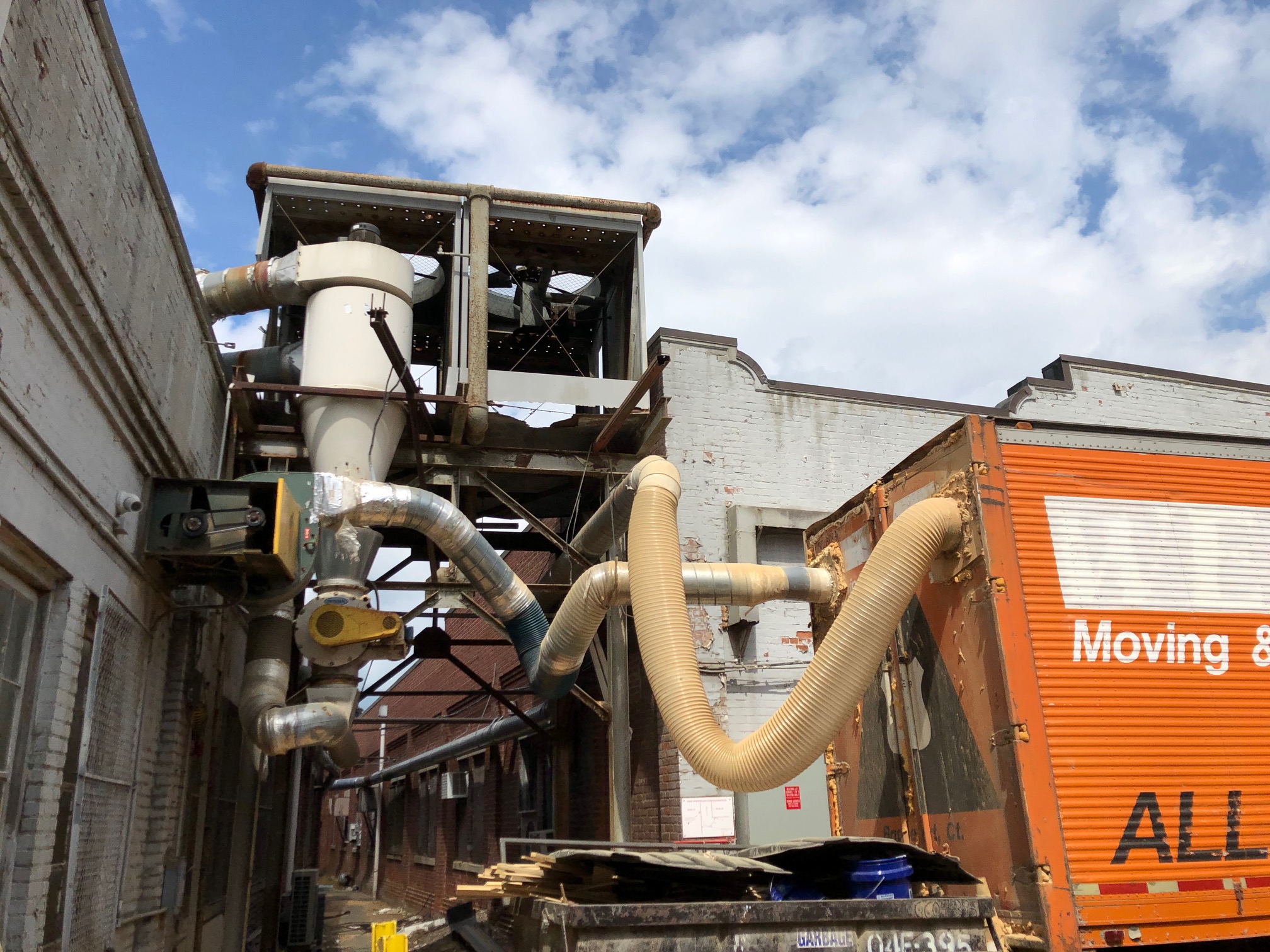

We are moving to a new shop, approx 12,000 sq ft. and are looking to get some input on a new vacuum system design. We currently have two (approx 7,000 CFM each) systems with a 5hp booster between. We have been looking for a baghouse or similar system for the new shop (20,000-30,000 cfm) but are thinking that a system that size with 100hp motor may be overkill for what we need. We have about 15 guys on the floor and about 25 machines. Our biggest draws are our moulder and wood grinder. Both of which are never used simultaneously. Our CNC machine has a dedicated system so we don't have to worry about that. All of our dust goes into a semi trailer and is hauled away when full and we have a booster at the trailer hookup as well. In short, I believe they systems that we have are sufficient but need to be designed to work properly. Any input or a system design company recommendation would be greatly appreciated.
