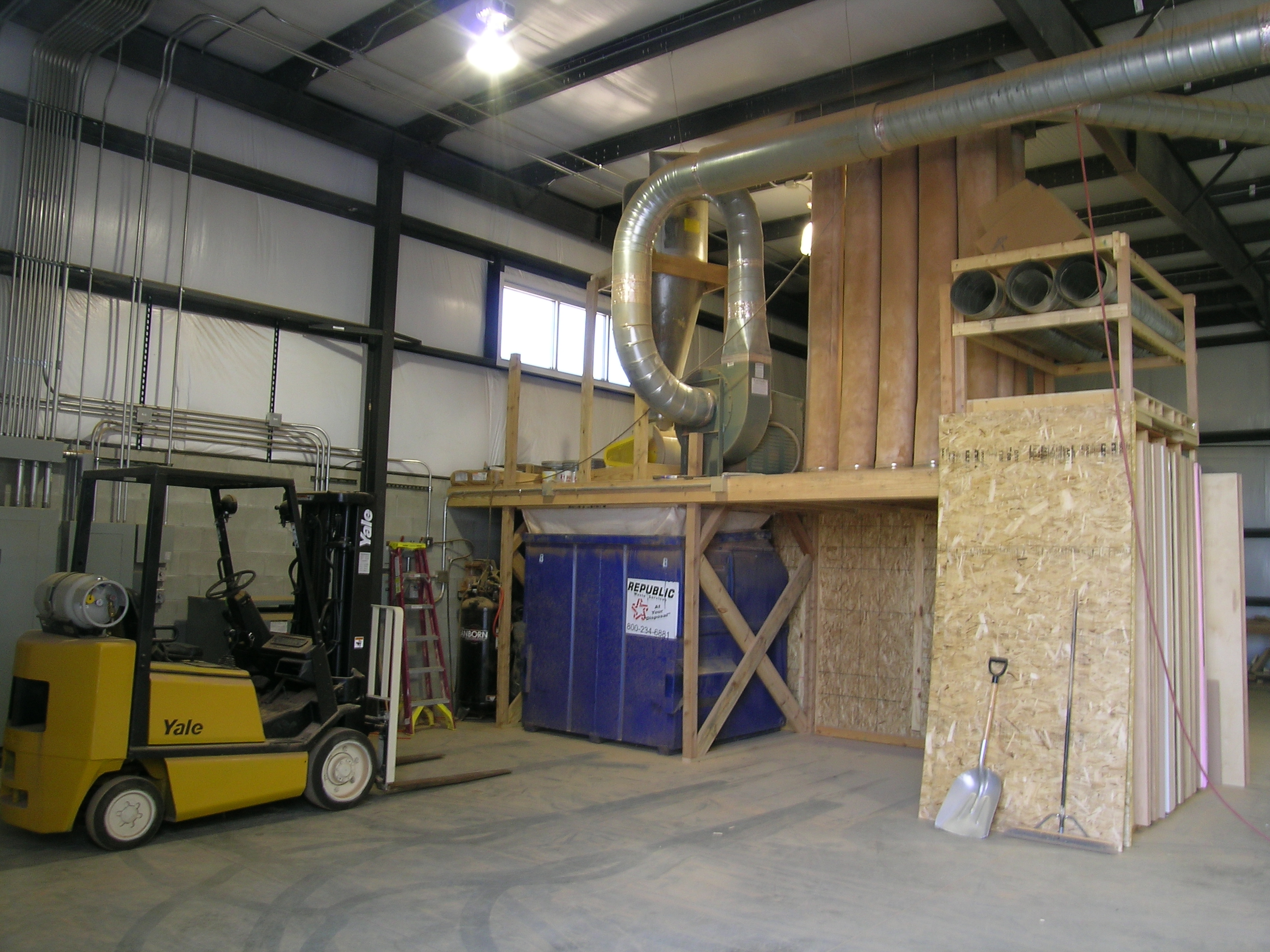

A fundamental component of dust collection is filtration. You ndeed some filters.
I had Oneida size and design my system, and it has been flawless for 30 years. My dusty air first goes thru the cyclone, where 90% or more drops out into a collection bin that is emptied, accessed from the outside of the shop. All the openings and doors are sealed to be 'air tight'.
The rest of the dust blows out of the cyclone to a series of cloth 'socks' that filter the dust, but allow the air to pass. The socks are in the shop, but high off the floor so they take up almost no usable room. We notice no change in temp when the collector runs vs not running.
Photos are of the same Type of system, but larger. Cloth area vs CFM is a baseline calculation you will need to do.
