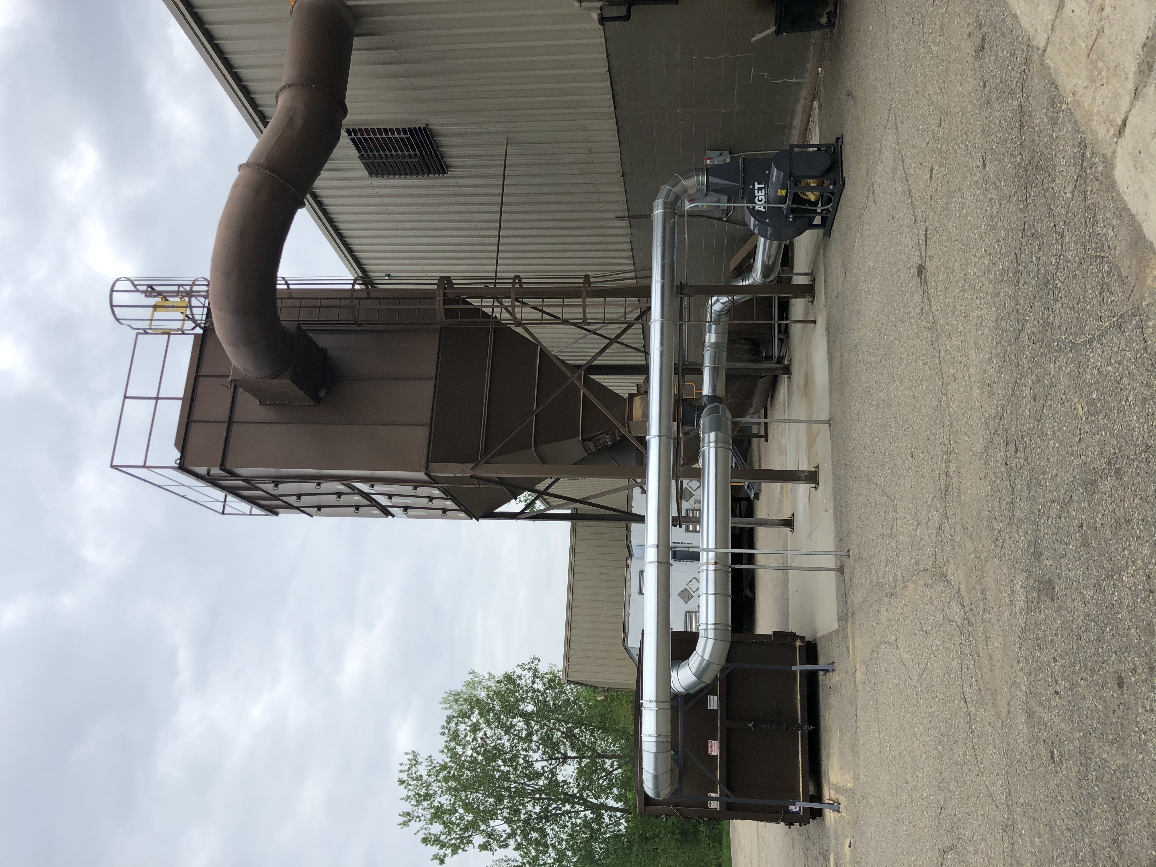

If you are using a rotary airlock the returning air is set up in a closed loop. It gets blown into the side up high and they returned to the closed loop up high next to it.
We use a sealed 40 yard dumpster. It holds 6-8 tons on dust.
