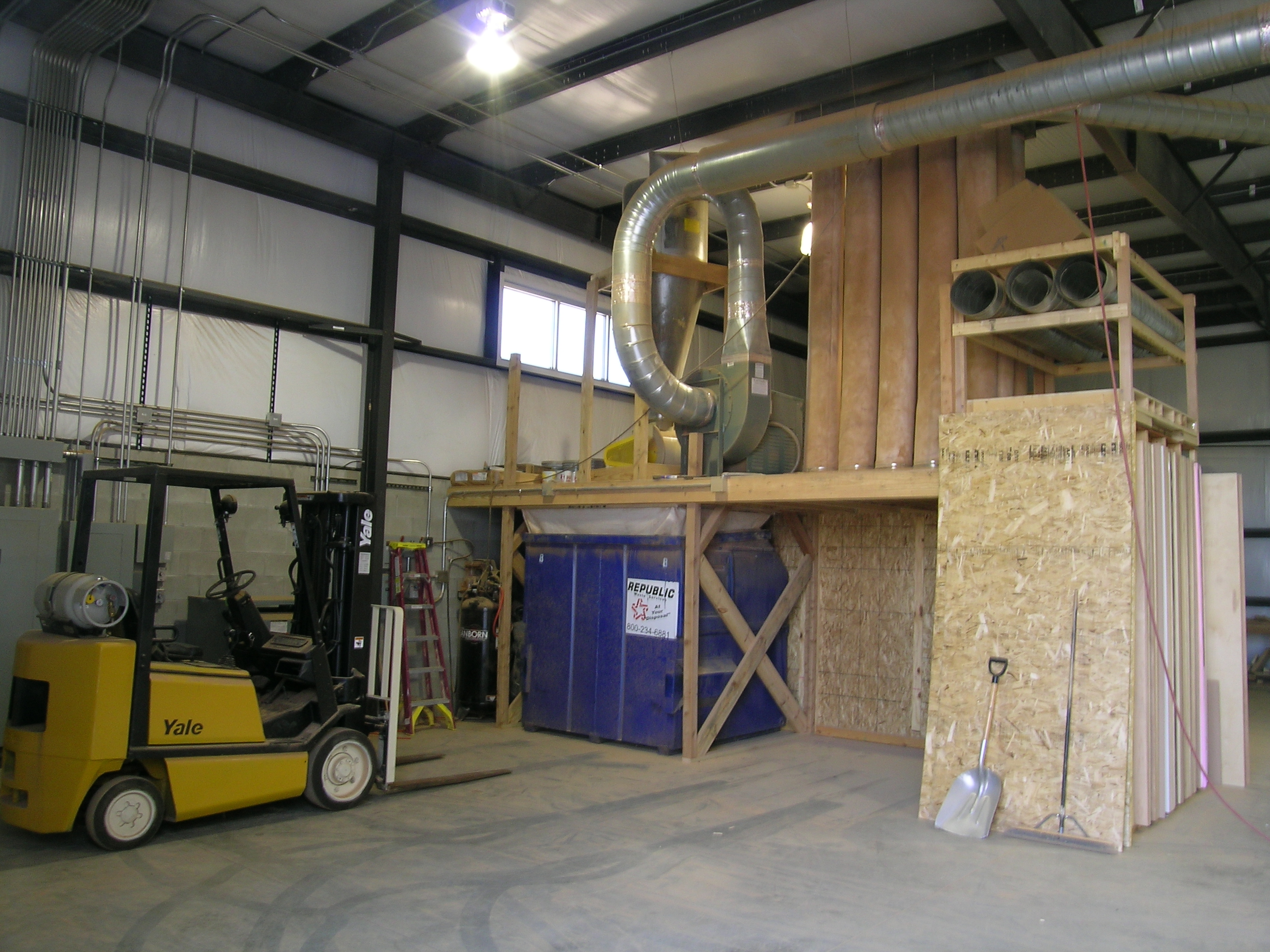

Build a plenum box that all the filters drop into. If you have the room, you can slope the bottom so it all goes to a sliding door that drops it into a dumpster. Do it at the end of the day, and you'll never have a back up again. If you don't have the room, make one end a door, and you can make a rake that pulls it all out into a dumpster.
Photo shows a plenum box that all the socks drop into, and the side opens and can be raked into a dumpster - once a month or so. Still dusty, but better....
