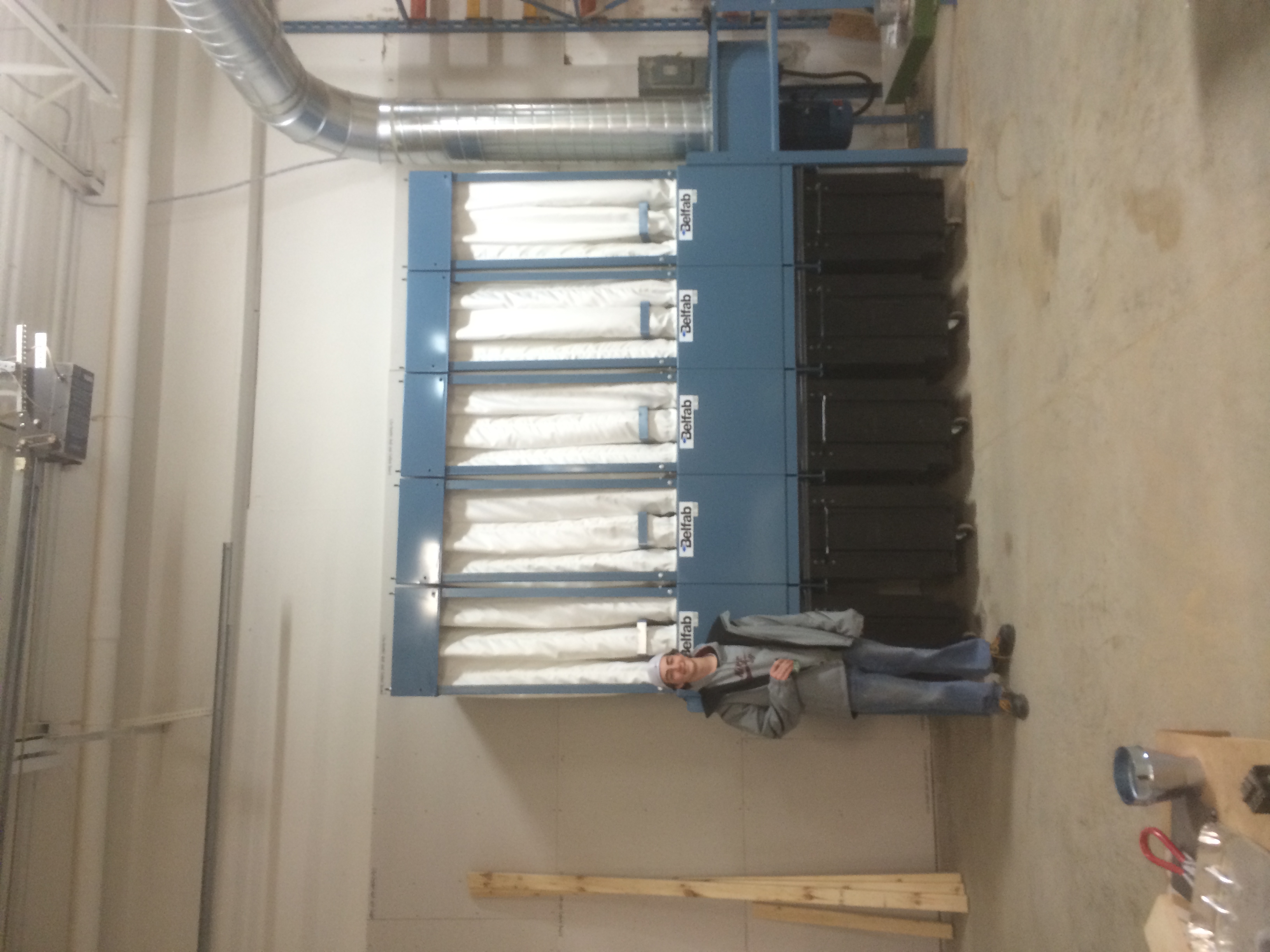

Bill
I had a 20hp Belfab with dump bins. It was their whisper(?) series and I believe I had an extra bag bank put on it. The shaker was manual. It was reasonably quiet, the suction was outstanding. The duct system was professionally designed. The bins worked well. We used a fork lift to dump them in a dumpster. That was a messy operation especially on a windy day.
Overall I was happy with its operation.
