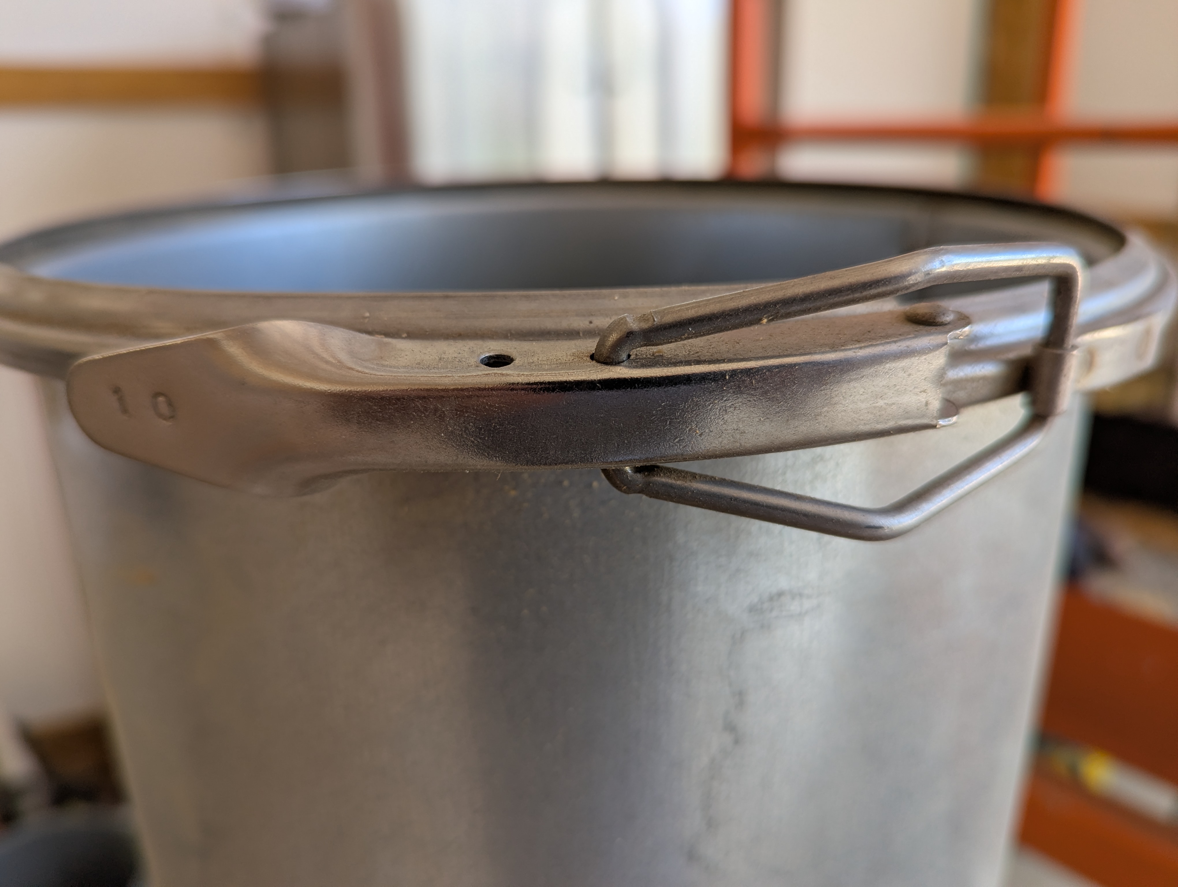

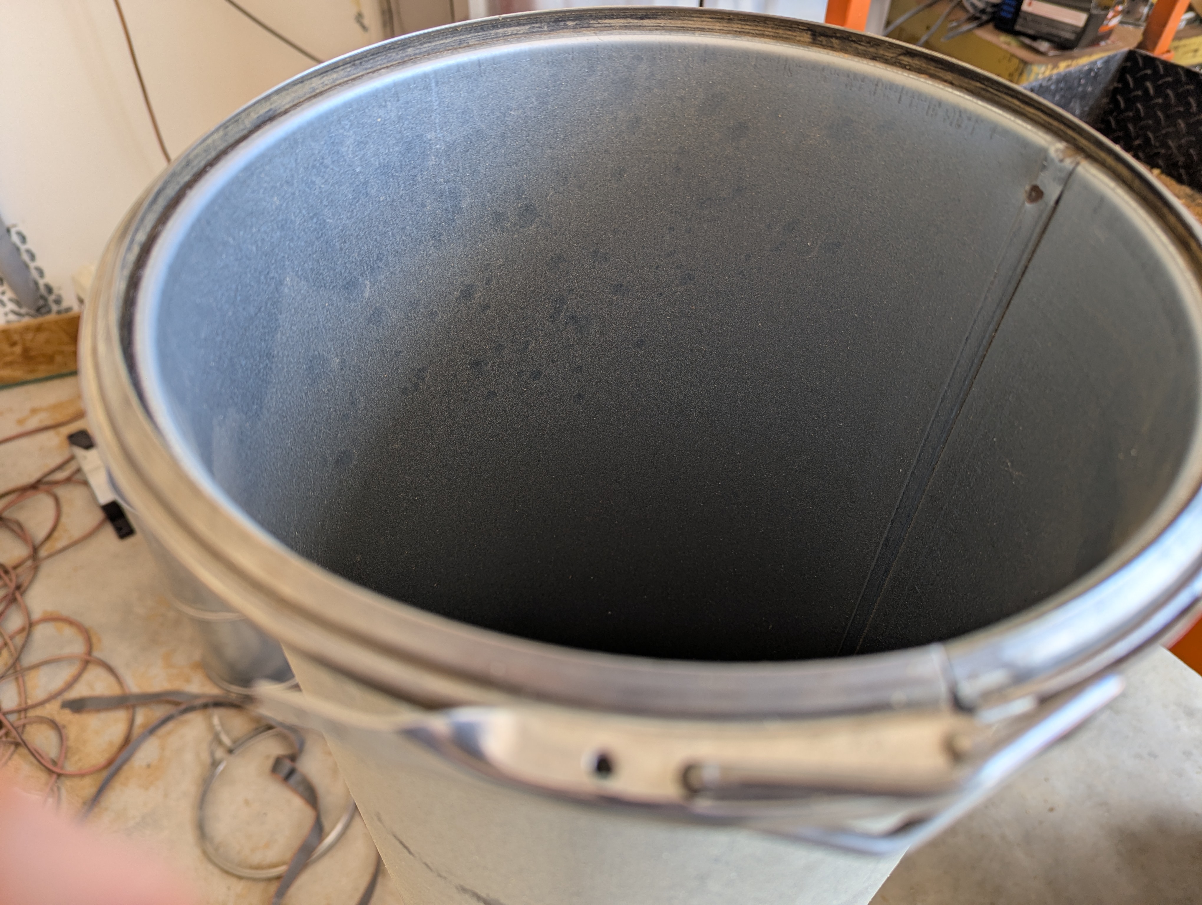

I purchased some used clamp together dust pipe from an online auction. Is there a way to tell what brand it is by looking at it?

From that clamp it looks to be from KB duct. We have some from them and some Nordfab. The clamp styles are a bit different but they both work on each brand fine. Hope that helps. We found the KB to be a better price and IMO make a better clamp as the Nordfabs use an adhesive backed seal that after a few years deteriorates and falls off. The KB is a rubber like seal that is crimped inside the clamp so it can’t come out.
