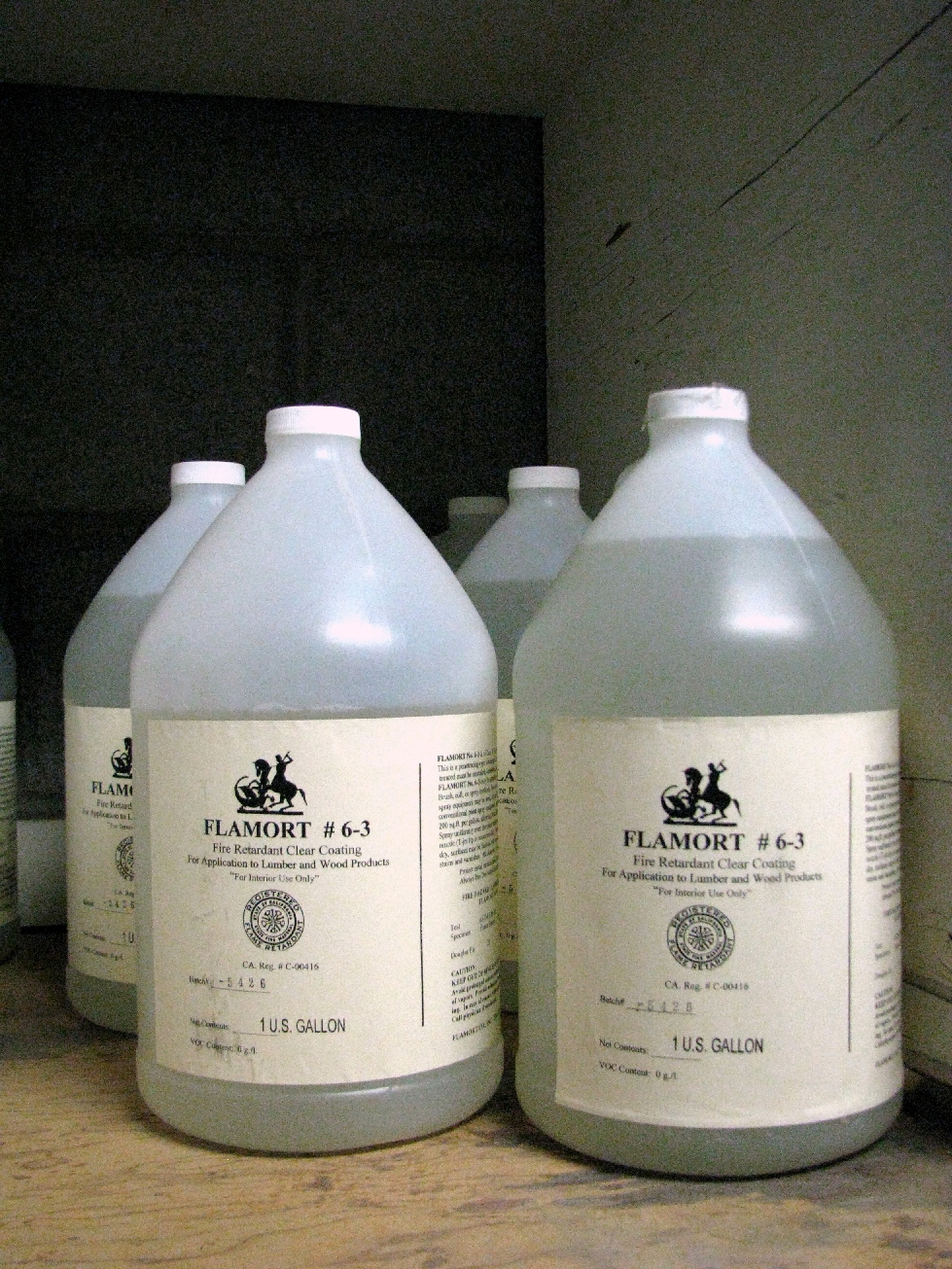

I am going to assume someone used Flamort fire retardant on your island? You say fire retardant in the title and salt in the body of the text.
Since it is a residential environment it doesn't have to meet class A fire suppression so I would just try and sand off as much of it as you can and providing you are able to spray I would use a 2K isolante coating or a catalyzed vinyl as a sealer and then a 2K polyurethane coating in whatever sheen and build you are after.

I attached the TDS for Flamort 6-3. Flamort has a number of retardant products and this is the one that's used on bare wood. It's a topical treatment and can be sanded off pretty easily though it sounds like it was applied heavily. I'd wash it off with fresh water, let it dry, and sand lightly to smooth before top coating. Test everything on a scrap if you can.
I usually use conversion varnish (CV) over it - 1 coat sealer and 1-2 top coats but 2K PU is also a good choice.
Flamort_6_3_Fire_Retardant.pdf
