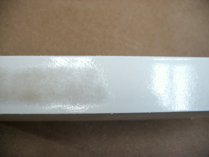

I usually use 150 for pretty much everything, but like Adam I also prefer 220 on MDF to avoid making the surface too fuzzy. I also use the same grit on the edges so it won't soak up all the primer. This single sanding step works for me and the adhesion is good - no problems.
The picture shows an example where I sanded the right half of the panel edge with 220 and the primer didn't soak in like it did on the left side (sanded to a higher grit).
View higher quality, full size image (681 X 511)
