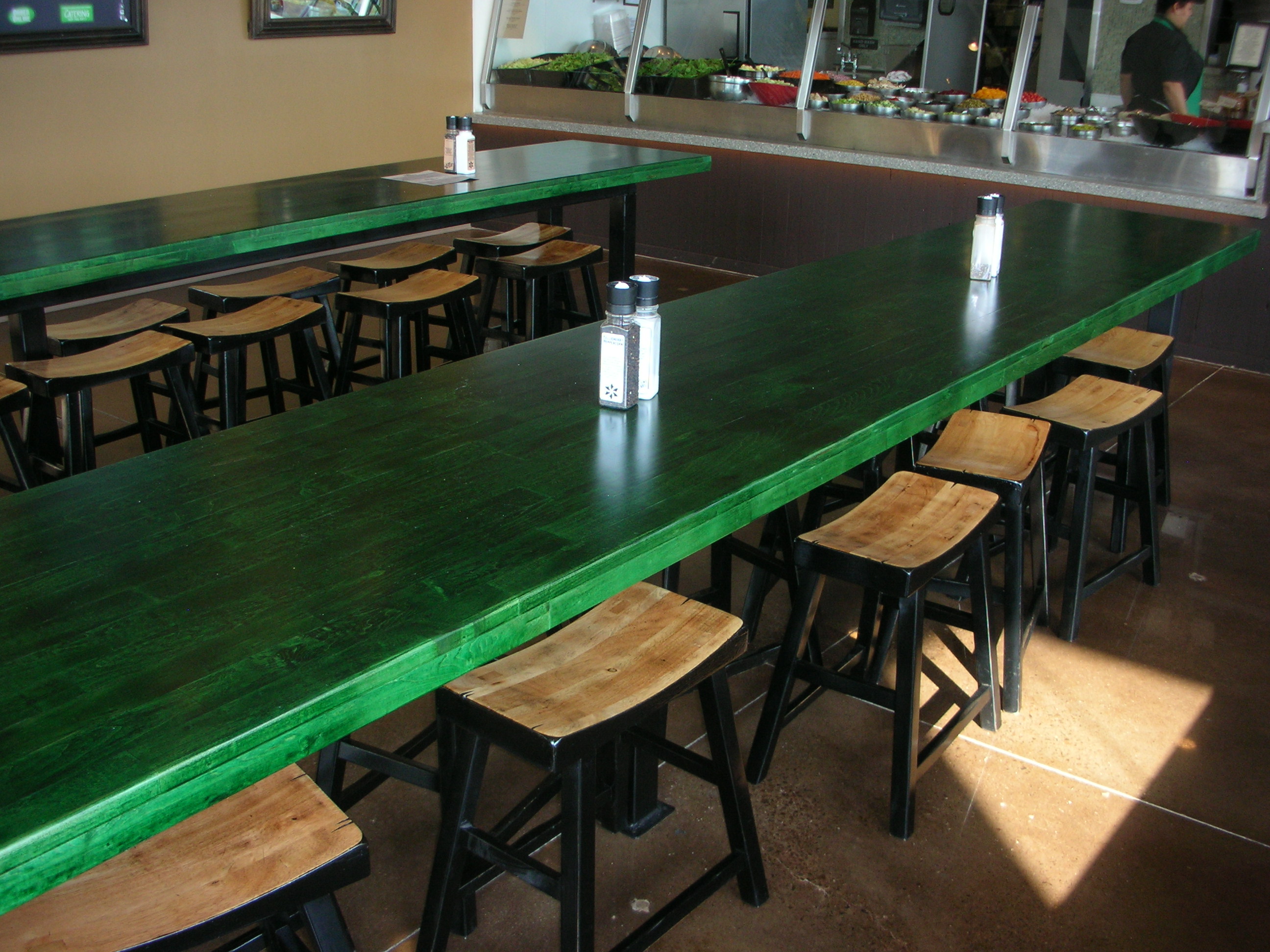

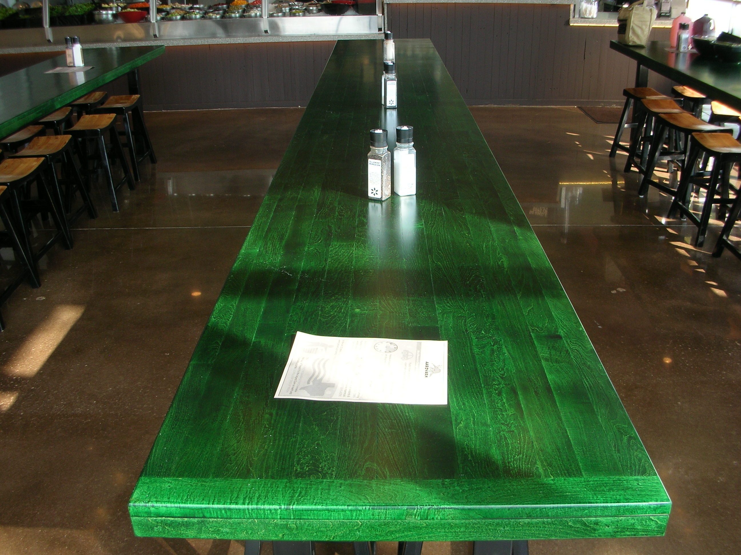

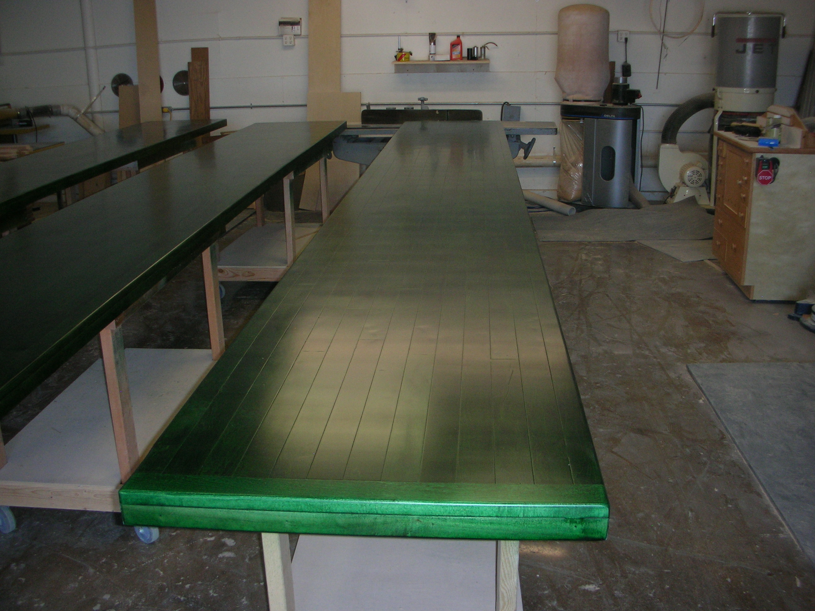

Bill, great looking tables! I had planned on using a 24 hr pot life CV, from my Diamond Vogle supplier but they don't currently carry anything in gloss so I am going to try the 2K poly instead. I am not sure if it's ISO free or not but planning on just a cartridge respirator and my trusted Binks cup gun. Ill post the pictures when they're done.
11/9/16       #17: Restaurant table topcoat ...
Bill Richardson  Member
Website: http://www.awwtx.com
I would caution you against a gloss finish. We originally used a satin finish but found showed to much water spotting. We now use a matte finish and our client seems to like it better. Restaurants are a brutal environment.
