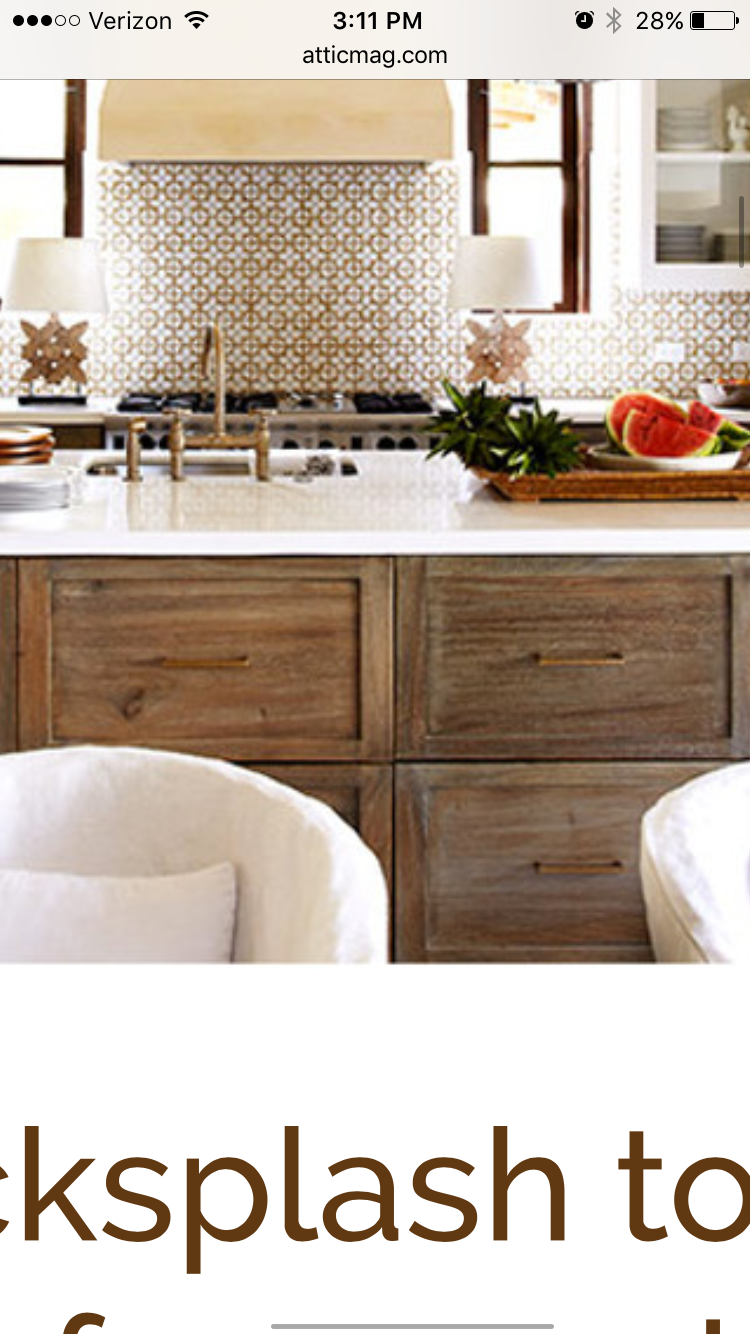

I need some help matching this finish for an upcoming job. Does anyone have any suggestions. I am having a hard time coming up with it.

Looks like you can just about make it anything. Lots of tones there, how can the customer refuse it when you have such a broad range of colors on that piece. What's the problem?
2/4/18       #3: Help with matching finish ...
Dan cook
It’s hard to tell from the picture but it looks like just a natural rustic walnut. Not sure how you would create that in another wood as even if you match the stain the grain would be off. It is not a first quality walnut as there is knots etc. so I would check with supplier to see if you can get similar stock, then you don’t need to stain it at all. Just clear coat it and done.
2/4/18       #4: Help with matching finish ...
Paul Snyder  Member
Website: finishing.tips
Hard to tell what kind of wood they used - I'd guess chestnut or hickory - but the web page the picture came from says the finish is a white wash stain with low sheen clear coats - see the link below.
Link to the kitchen article withpictures
2/4/18       #5: Help with matching finish ...
Daniel Shafner Member
It looks like a sprayed whitewash, grayish white, rubbed through to reveal a brown stained wood underneath, and then topcoated with a low sheen clear. I base what I say on both what I see in the pictures and also the romanticized write-up in their text.
2/5/18       #6: Help with matching finish ...
Shane
build with Knotty Alder...
wipe stain with a light burnt umber (light reddish brown/orangish shade stain)
Catalyzed Vinyl Sealer
Scuff...
make a light tannish/grey or coffee with cream colored oil based glaze.....
glaze entire surface... brush/rag off to get the look
Coat of catalyzed vinyl sealer
Very Light dry brushing of a raw umber glaze to dirty it up in accent areas
Topcoat with Conversion Varnish in a low sheen 10-25 Sheen?
optional second topcoat to sweeten up the deal?
