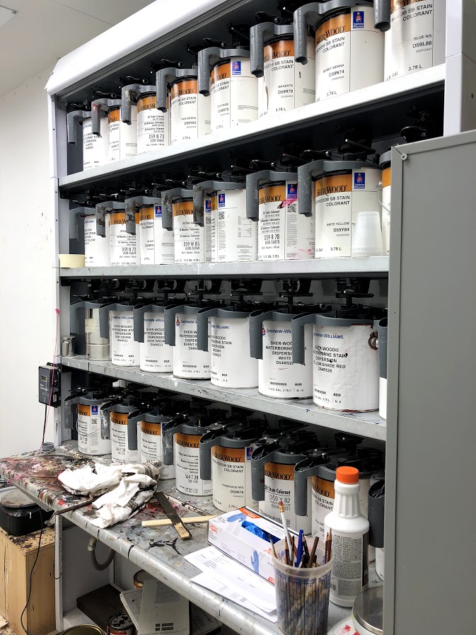

if you guys want to go the Sherwin route.. Which I highly recommend... Switch over to their SB stain colorant system and use their aurora program to build/store your formulas. they have several clear bases to work with depending on you application type.. wipe..spray no wipe... spray wipe... Based on about 17 different tints you can create any match right in your own hands and use the aurora system to store your formula and add notes about the process... recall and print the formula and weigh it out for any size batch you want from 4oz to 400 gallons... I also do a good bit of their waterborne stain dispersions for going under my UV coatings so I also have that whole tint line and the raw ingredients loaded into aurora for formulating... you could do this without the whole mixing station. I find most of my mixes contain the following tints with the concentrated clear base for wipe and naptha
Black,White,Burnt Umber, Raw umber,Burnt Sienna,Yellow Oxide,Bright Red,Blue R/S,Van Dyke Brite Yellow.....
you can hit just about any color for wipe or spray with those colors....

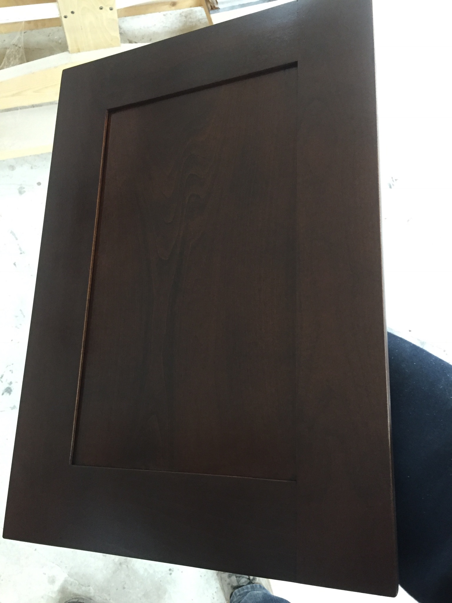

I used Mohawk vandyke brown dye on the raw door, I didn’t drench it. Then I used Mohawk van dyke brown wiping stain, then the door was sealed with vinyl sealer with no color added. Then scuffed. That gets it to the point it is in the first pic.
The second pic is when I gave it the light coat of the 50/50 thinner and vinyl sealer with the 2oz of the same wiping stain added to it.
3/28/18       #38: Stain issues ...
JeffD
Ok, that makes more sense to me, when I first read your post it almost sounded like you sprayed on a coat of the stain/thinner/sealer concoction and got that color. Which would have been an amazing feat and certainly had my attention. I just re-read it and realize it was me just not reading correctly!
I don't use the dyes on their own too often.... for fear I'm not going to get it on evenly. Are you just spraying it straight or doing what I've done in the past mix a couple ounces of dye into some thinner and shade it on gradually?
Oh and those last pics certainly look a heck of a lot better than the first ones!

I use the dyes straight. The key to getting it even is to turn the pressure way low. When I spray it’s almost like a drizzle of rain. I use one coat. For some time I used dye as the only color. Plenty fast enough and easy to get it dark. Couple reasons that I quit using it as a stand alone color. One it’s to transparent by itself, I’ve got a door right now in my office that standing upright the rails are darker than the stiles, flip it 90 degrees and the stiles are darker than the rails. Second, if your doing pieces that have a lot of crevices then it’s really hard to get it in those places without getting the rest of it to dark.
