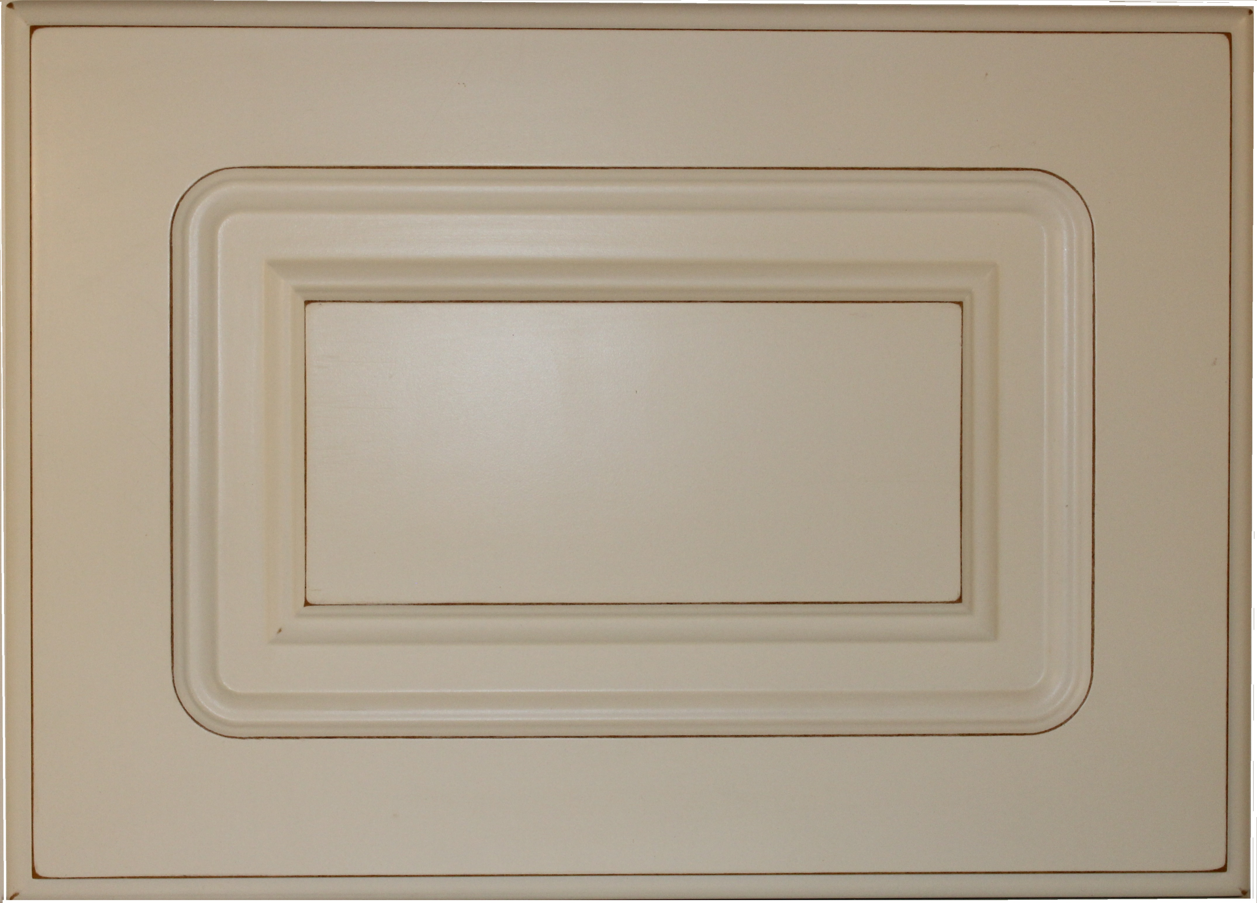

Are you putting a good break on your edges
before finishing? Also the sandthrough to the base is what would be there if it had worn naturaly. Maybe trying too hard as sandthrough is an attempt at replicate natural where.
View higher quality, full size image (4300 X 3088)
