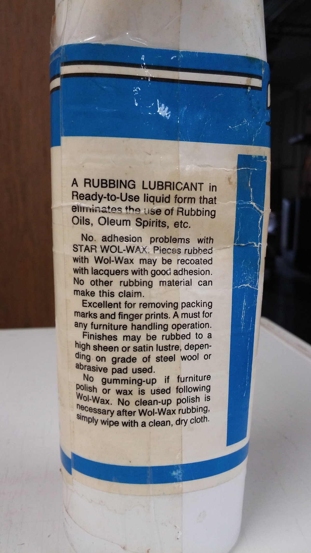

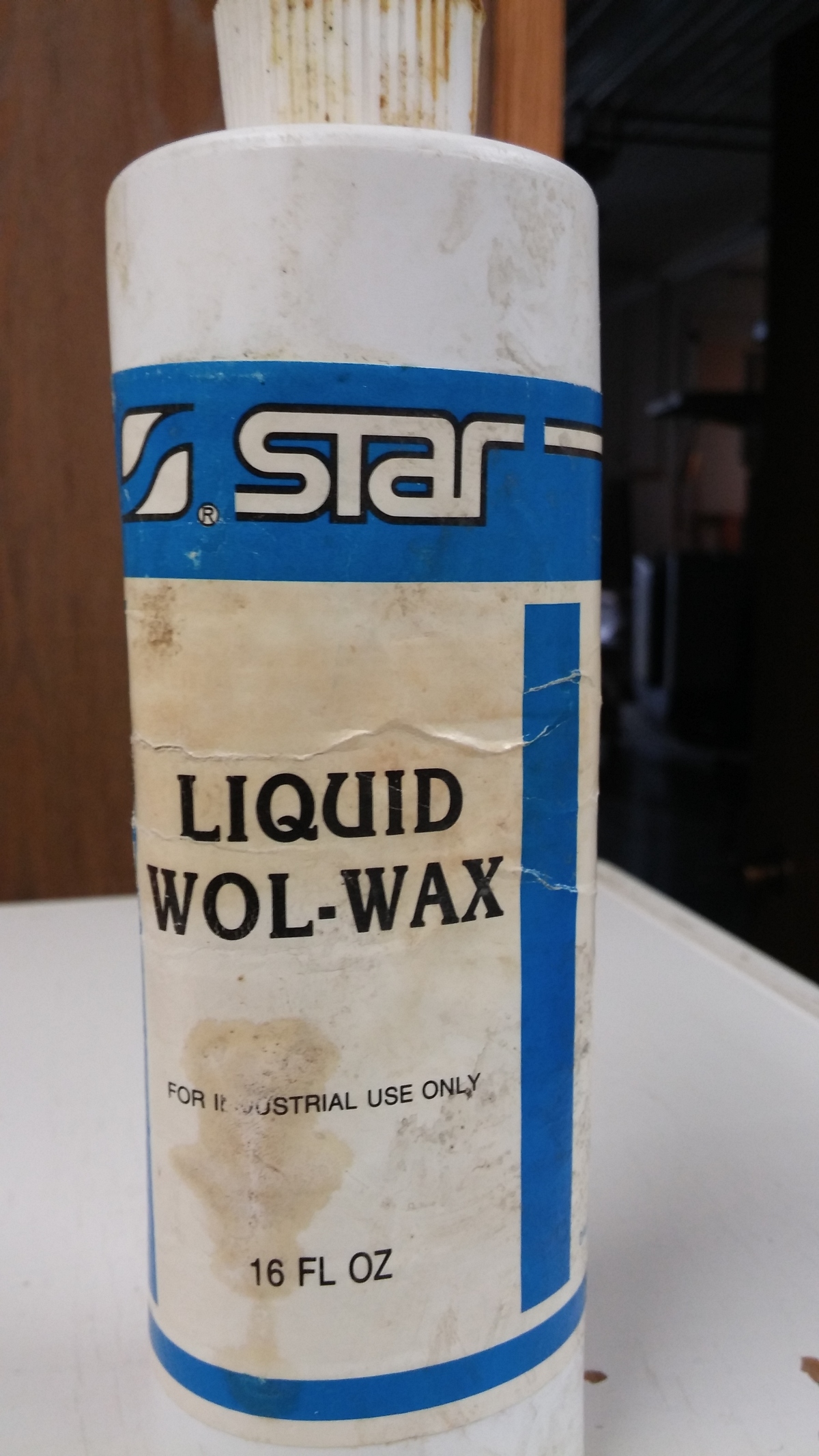

8/19 #5: wool wax ...
I think this is the product the furniture factory was using? We used this with 0000 steel wool but it works well with fine wet sanding paper also.
I have not seen it for sale for some time.
View higher quality, full size image (1200 X 2133)
8/27 #6: wool wax ...
That Star Wol-Wax is the potash soap that I referenced in my posting, above.
