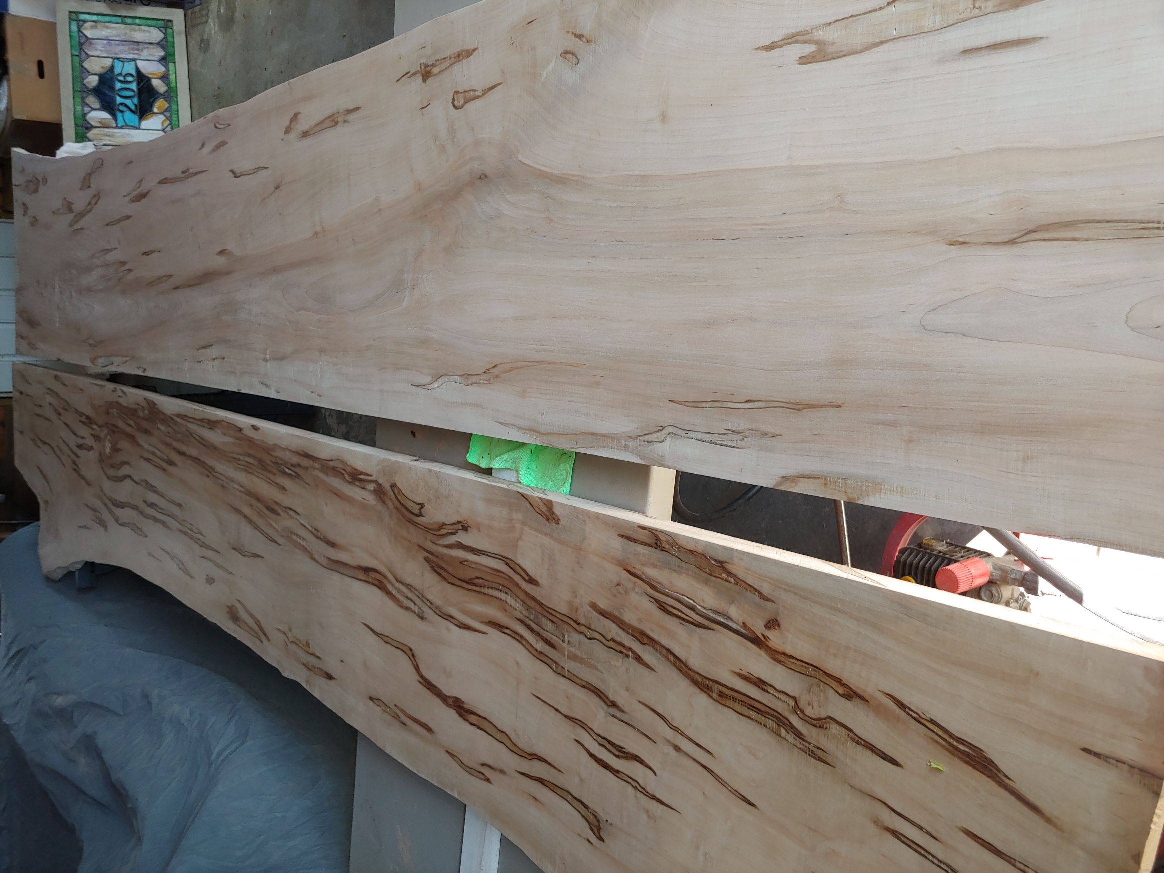

First time post..... Redux of master bath. We didn't find any vanities that we liked, so we are building a top out of a slab of maple with lots of ambrosia. We are ready to start applying coats to it and I'm seeking advice on products to use. I don't have a sprayer, so they will be hand applied - and we aren't looking for a high gloss glass finish. In years past, I worked with a shop that used Sand and Seal as the base coat - applying and sanding between coats and then finishing with a poly coat.
Checking with you all on suggestions for products to use to give us a finish that will bring out the ambrosia in the wood, seal it off from the everyday use as a bathroom top (w/ vessel sinks) and will WOW us every day we walk into the bathroom.

2K poly system comes to mind!

5 or more coats of Epifanes marine varnish. It's available in a matte sheen. I've used it on numerous bar tops. It holds up well and can be touched up/recoated more easily than other products.

I would use a PU varnish for marine / boats. You can find in any paint store and it is easy to apply and accept re finishing
