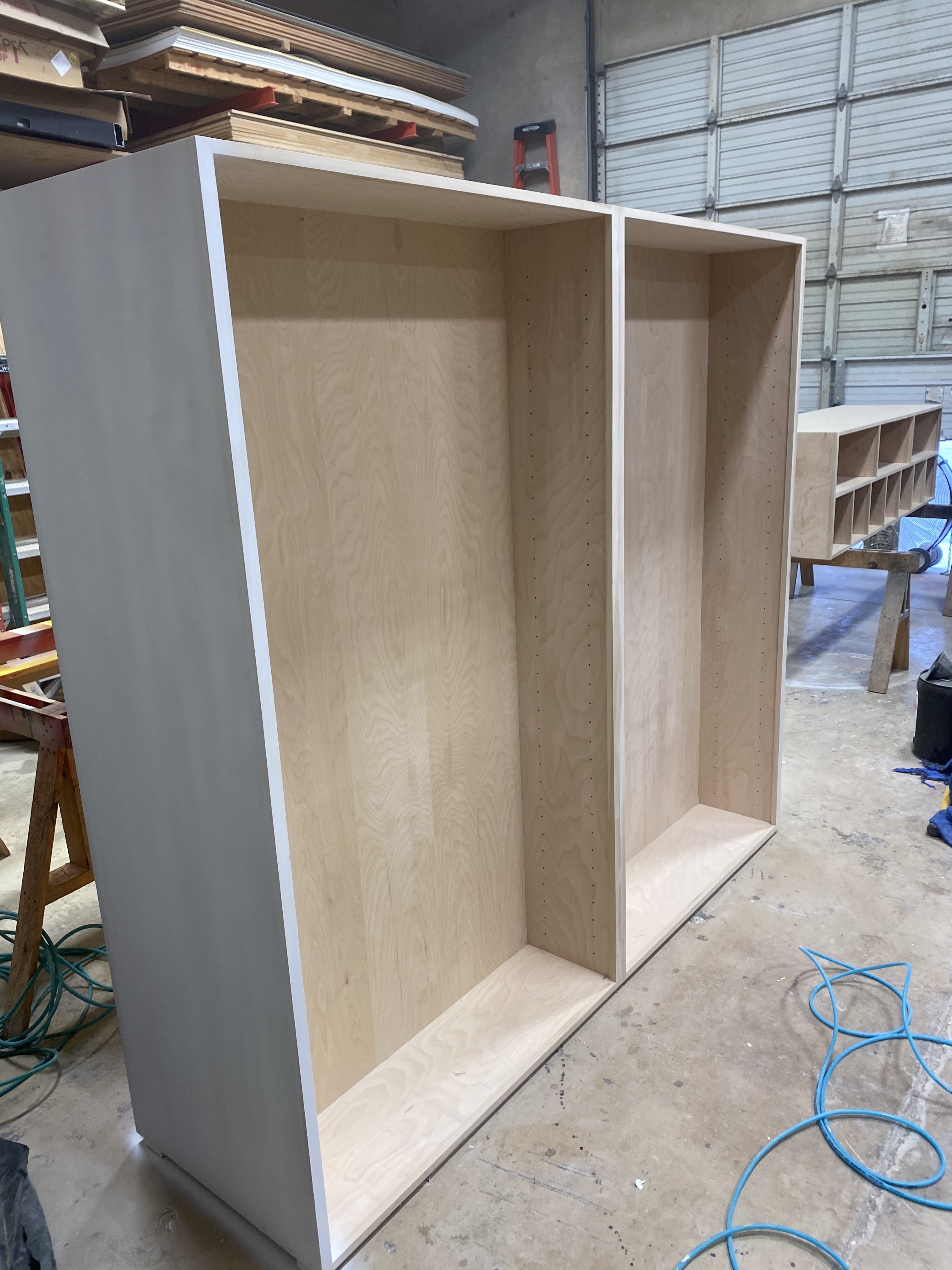

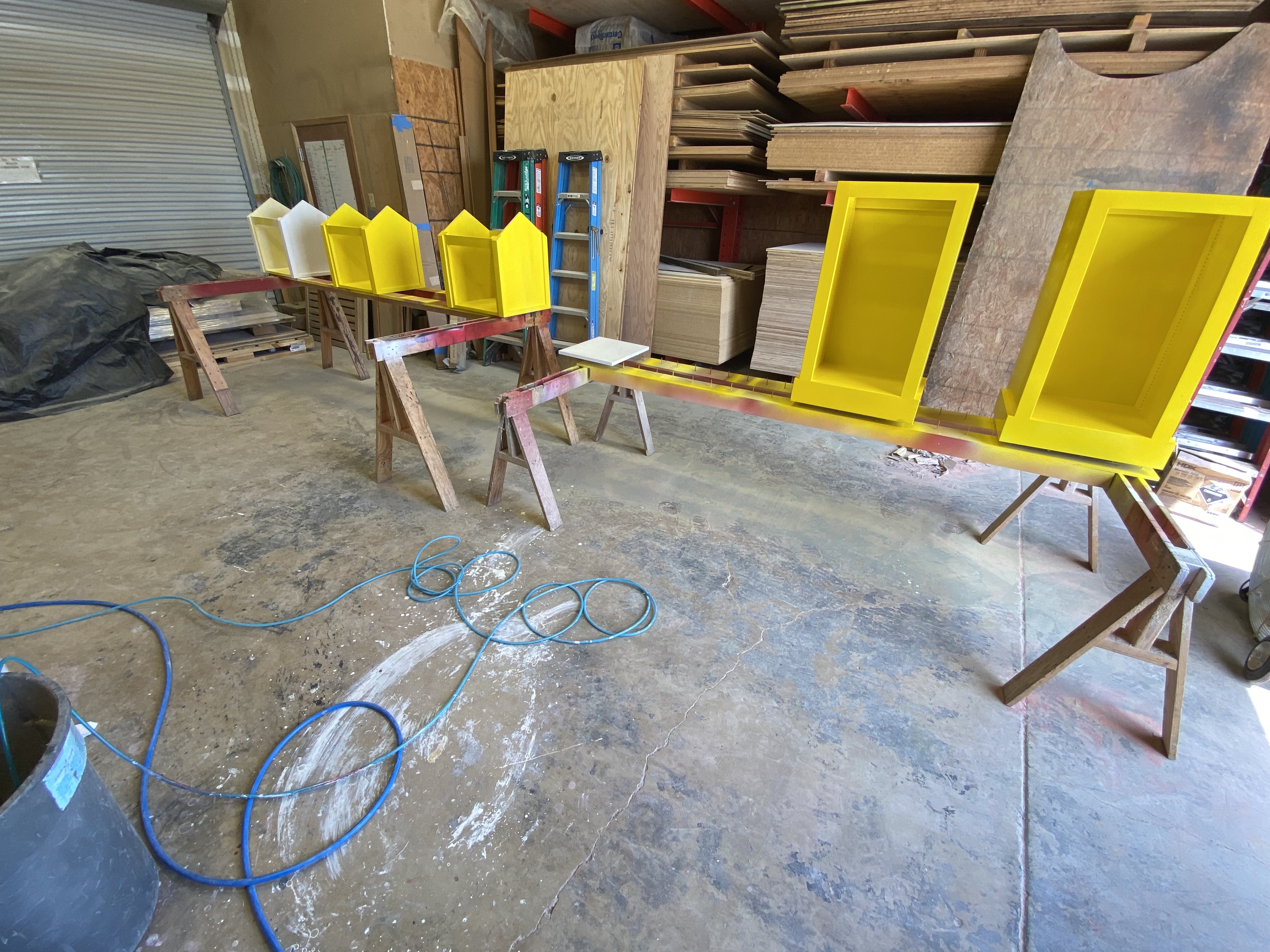

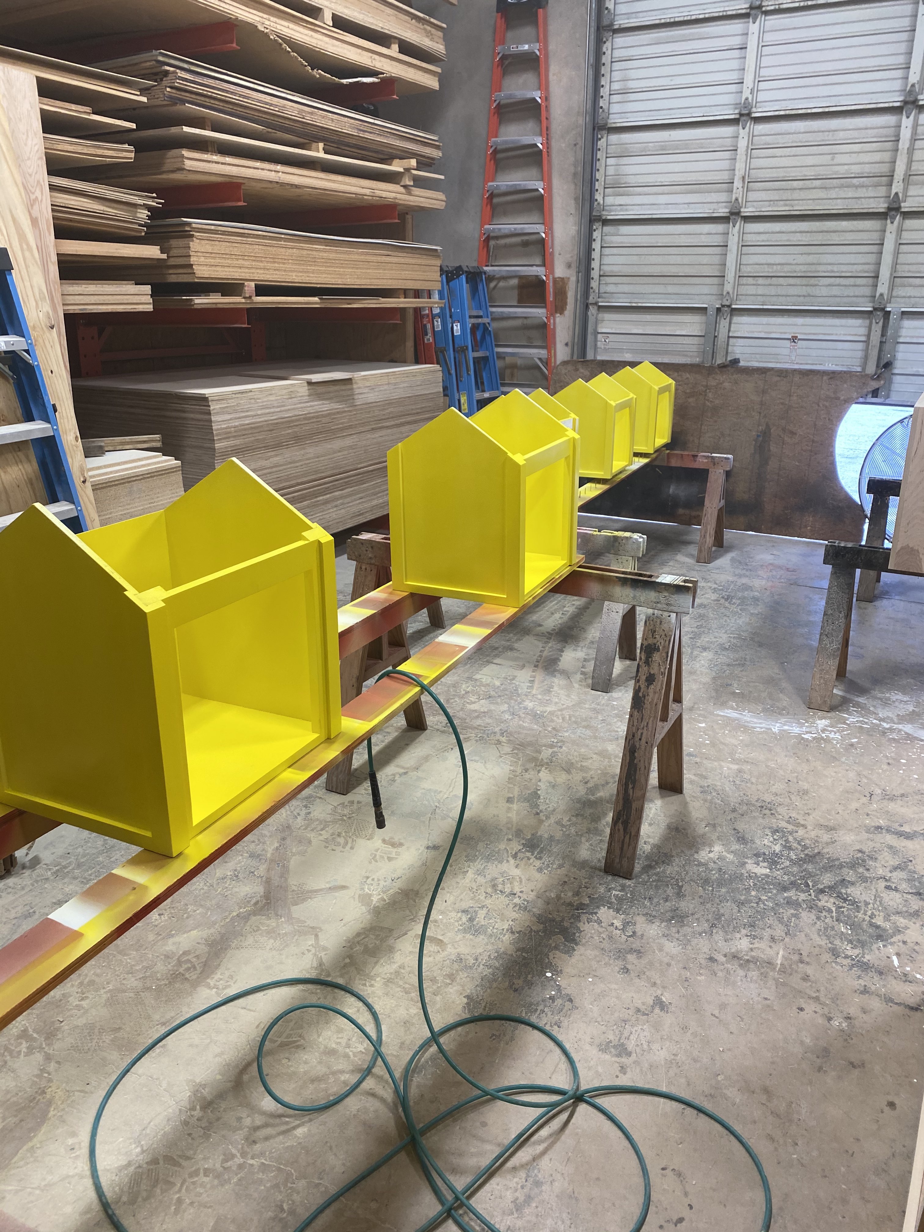

Most of our finishing jobs go to a dedicated finishing shop, but like it or not I am slowing becoming "the guy" for small lacquer jobs at work. We also have to buy all of our own PPE, so when I spray I use a 3M 3000 series respirator with organic compound carbon filters. Because of the virus, I can't get filters at the local home depot like I normally do. How long do you guys in practice use these filters? Also, if you are not in a full hood, how important is it to protect your eyes? Spraying inside boxes, is when I am really aware that I should be thinking more about how this could effect my eyes. I am spraying in a huge wear-house, with a moderate fan in the door. I would love to hear any PPE pro tips you guys have. I only have so many brain cells, and I need to keep all that are left.

I guess the company you work for has never had a visit from OSHA, the local fire marshall, or insurance inspector? Hard to count all the issues in those pictures.
