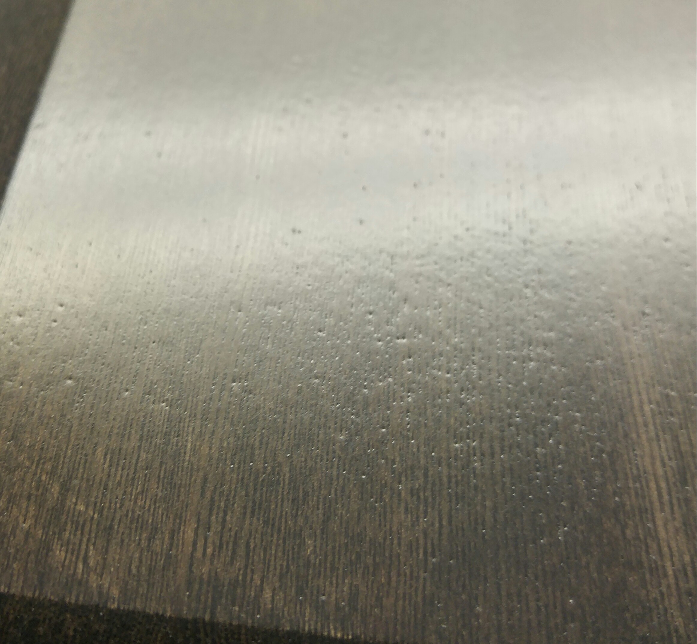

So I am still having pinholes issue on ash.
I have followed advice here and got a AAA pump. less pinholes but they are still there.
I have read a lot of threads here and followed many advices but got mixed results. what has helped so far:
-Going AAA
- grain poping with water first(finish seems to sink better i the wood rather than skinning over). I was getting pin everywhere but this has made them onlyover the pores
-thinning CV a lot. up to 30% was the best way but it is runny saggy and sure cost a lot of reducer retarder.
-leaving the wood unfilled as the cv would sink into them rather than bridging and trapping air/solvent.
What did not help:
-grain filing. tried proper oil or water based filler and also using very thin timbermate putty. maybe made them more visible since the surface was more smooth.
- spraying thinner coats may help at first but eventually they beging appearing on the last coats.
I am now looking for causes rather than cure/solution. right now I have these:
-I have read that blowing dust with compressed air could be a cause as it loads the pore with air. it seems logic in theory but how would I remove dust efficiently then. I am unsure about tack cloth and stuf that could contaminate wood
-Using a tip wich output too much cv. I use a graco m211. I sure have to move the gun fast(3-4' per sec.).would using a smaller tip help or worsen the problem

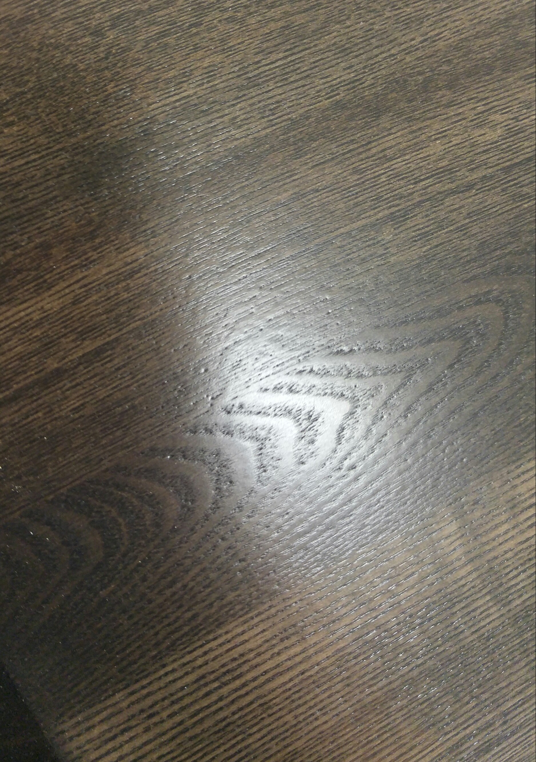

also added some pics to help. Keep in mind that I am going for a semi filled look so visible pores are ok to me

7/1/20       #2: pinholes again ...
pascal stgelais
Oh forgot to ask if multiple application or grain filler and sanding could help.
7/1/20       #3: pinholes again ...
Pascal
3rd edit:
I was looking at an older project and noticed :
They almost Always seem to appear on larger surface. The ones you have to make multiple passes in order to spray. When I shoot narrow pieces that only need one pass(2 inch or less) I almost never get pinholes.
Could they come from the air the AAA use to blend the tails. I mean can it make the finish skin too fast. I generally need about 10-12 psi to blend the tails correctly.
Maybe I am holding the gun to close to the surface. I come from a hvlp background and am used to hold the gun 6-8 inches from the surface. Maybe this is to close and the overlapping passes act like I was blowing a air drier on the piece?
(I once used a air drier to speed up the drying of a test piece an got the WORST case of pinholes and solvent pop ever…teenage pimples everywhere)

Your coats look really heavy to me for oak. I echo the advice of thinner coats, dial your fluid settings down. You can also experiment with different coatings. Some are formulated for open pore definition, some for closed pore, a lot of data sheets will tell you.

Just wanted to point out what your seeing is not the industry standard "Pinholes". What your seeing is the in between coating thickness stage of open pore versus closed pore... The "pinholes" your seeing is areas of grain structure that is more open than the other pores around it... Always an issue with wood species that have large grain pores. I generally keep an open pore low film build look on those species or fully fill them... The true "pinholes" term is when a coating has some contamination issues and pin holes develop in the coating.. not a surface tension issue surrounding an open pore on your substrate. Get yourself a pocket microscope that goes from 60-120X power and start eyeballing some of your issues and you will start to understand how some of them are happening...

But as someone else says, what you are seeing is really the inability to flow, wet, and stay in the open pores. That is a much more complex issue.
The mohawk 550 and 275 CV, while very thin in viscosity, are pretty high solids (44%). That means it's gonna be harder to spray thin coats that look like a coat, because there is less solvent/etc to help it flow.
All chemistry being equal (and it's not, but again, it would be a really long post to go into this), the higher solids content CV is going to have more issues getting into, and staying, in the pores of open pore woods.
You would be almost certainly be better off with a lower solids (25-30%) content CV and spraying two coats of it.
The individual coats would likely flow a lot better into the pores and not pull back.

and nice explaination of the problem I always thought it was pinholes but you re right that when I sprayed lacquer, vinyl etc with half or les solid I never had this sort of issue even with WET coats.
oh and i suppose it means that going for a full grain filled look rather than a partial fill should (hopefully) deal with most of the problem?

It is hard to see what is happening from a picture taken after your material is dry.
It sounds to me like you are ending up with a lot of solvent pop, Google solvent pop and you will find some good information.
Like others Have said you are going to get some holes or indents with open grain material as a couple coats of finish coat won’t fill those holes.
If your spray is like little air bubbles that are popping you are having solvent pop. By what you were saying and I would agree with Daniel, you have to much thinner, and the other thing is it sounds like you are laying down to much material.
Your material comes with a data sheet on what percentage of thinner you should add. After you add your thinner you should check the viscosity with a viscosity cup, you should also check your material thickness with a measuring gauge.
