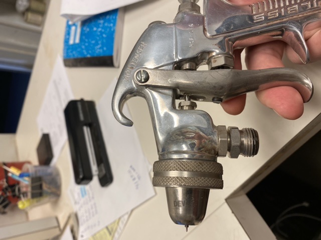

Shane
I have one of the old devilbiss veiling guns that hasn’t seen action in many years....
