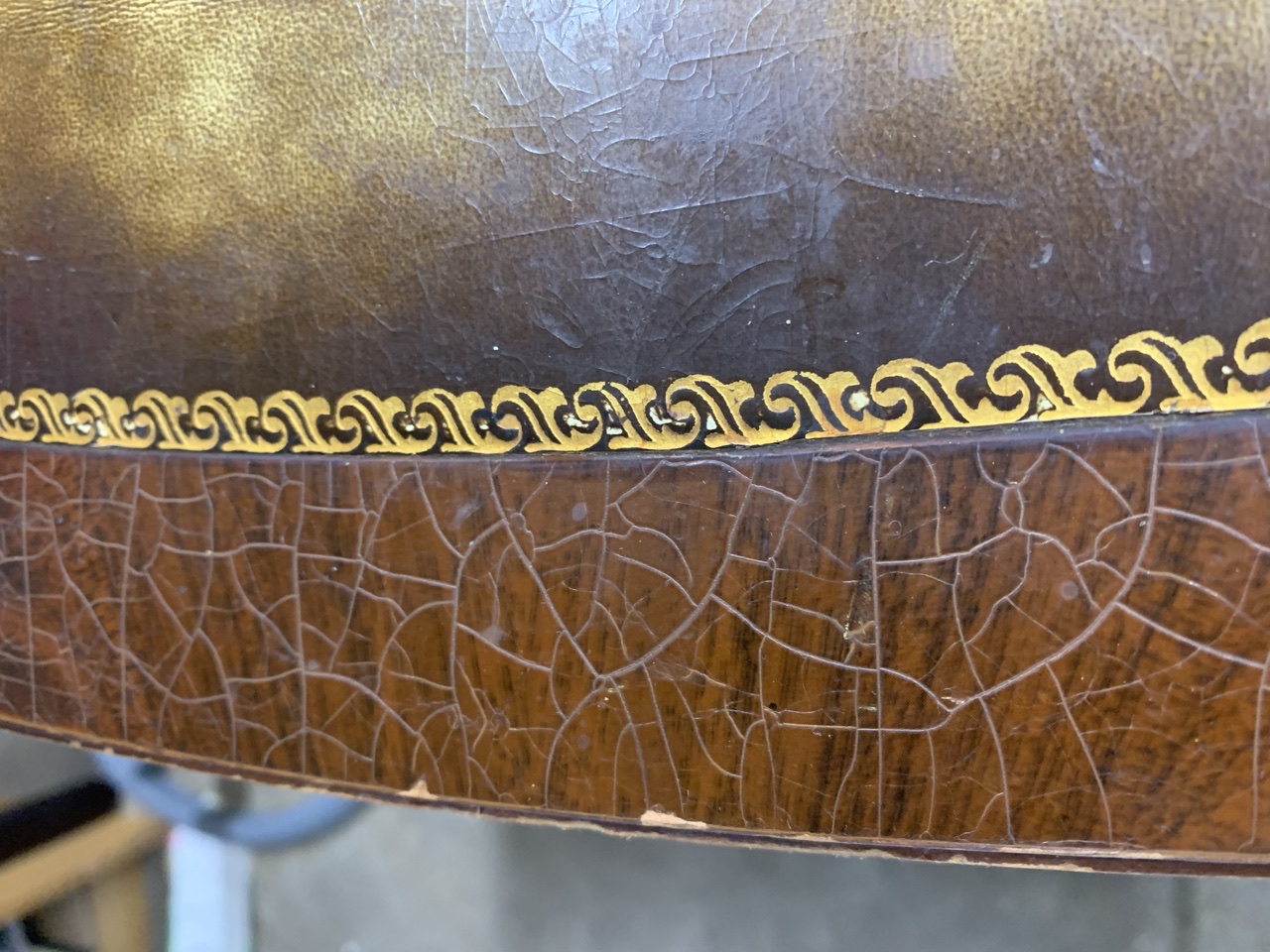

I’m re-leathering an antique Pembroke table. The shellac has crackled/crazed on the whole piece, even on the leather pieces. I’m only replacing the top, the leaf leathers are fine. Is there a way to get that crazing on the new piece I’m installing?

Samples samples samples..... look into getting some waterborne crackle medium and make samples to figure out how to control the look you need.... then send it it!

Robert M  Member
for what my 2ct advise may come to.....
If it's "true" shelac.....simply use alcool to restore and match the new piece !! ;0)
All the best.
10/20/20       #4: Leather top table ...
Shane Welch
There are ways to make the shellac fracture but it will take some extensive practice/sampling..... after the coating is flashed off and cured for several hours you can warm the surface with a heat gun on low and get some distance from the part.... take canned air or pc dusters... turn upside down and spray the surface.... thus creating extreme temp swings and creating the fractures..... it's fairly unpredictable and also depends on coating thickness as to the reaction that happens... that is if you want the crazing.fractures.

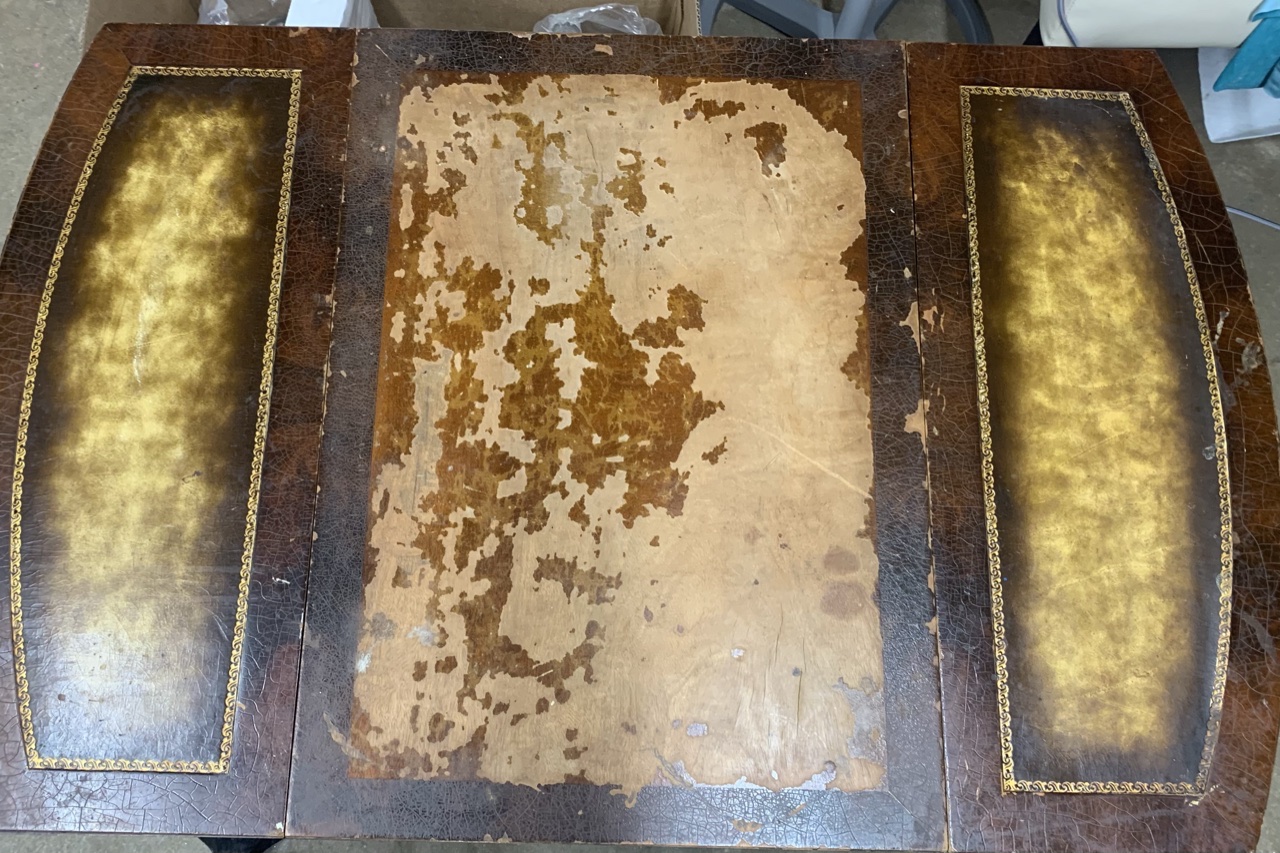

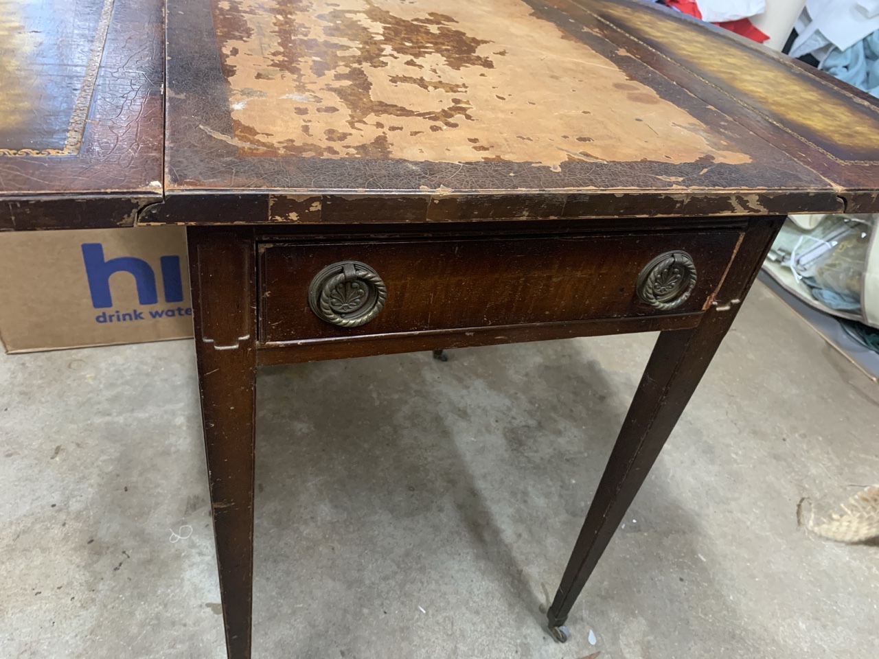

LindaI Member
Thanks for all the great advice!!! I’ve finally gotten into the shop to get some pics. I’m also looking for someone that can replicate this leather for the missing piece. It’s my moms table. It’s was her Grandmother’s, so I’d like to do it right. It’s a mess. Didn’t realize it was in such bad shape. I’ve redone lots of furniture before(and I refuse to paint good wood, it’s just wrong). Should I strip it bare and redo or use something like Formbys? I’ve heard lots of restorers hate that stuff. I’ve used it before with good results. Anyway, thanks again!!!!💕💕💕
