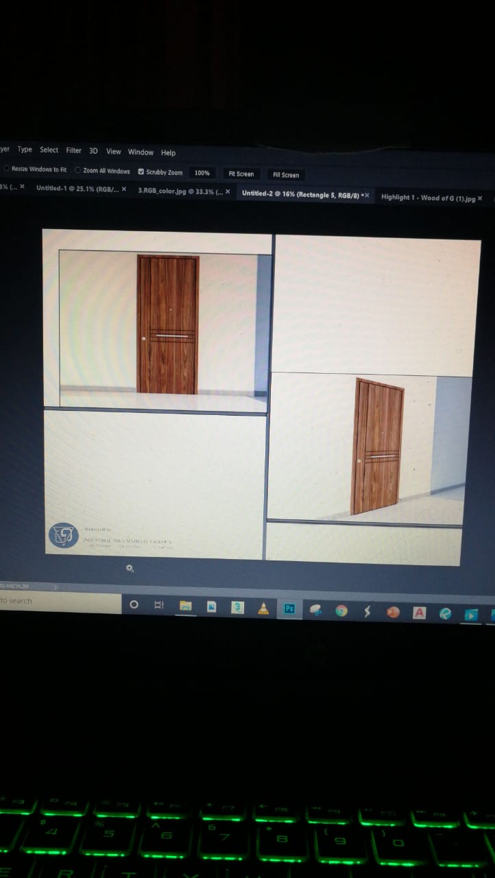

I have a project that includes an entrydoor and interior doors
The customer want a modern look and he want to use white or redoak veneer
Can any one give me an advice about what type of stain to use to give it a modern look a little bit brownand any picture will be much appreciated
This is the door design a simple door with joints
Thank you in advance

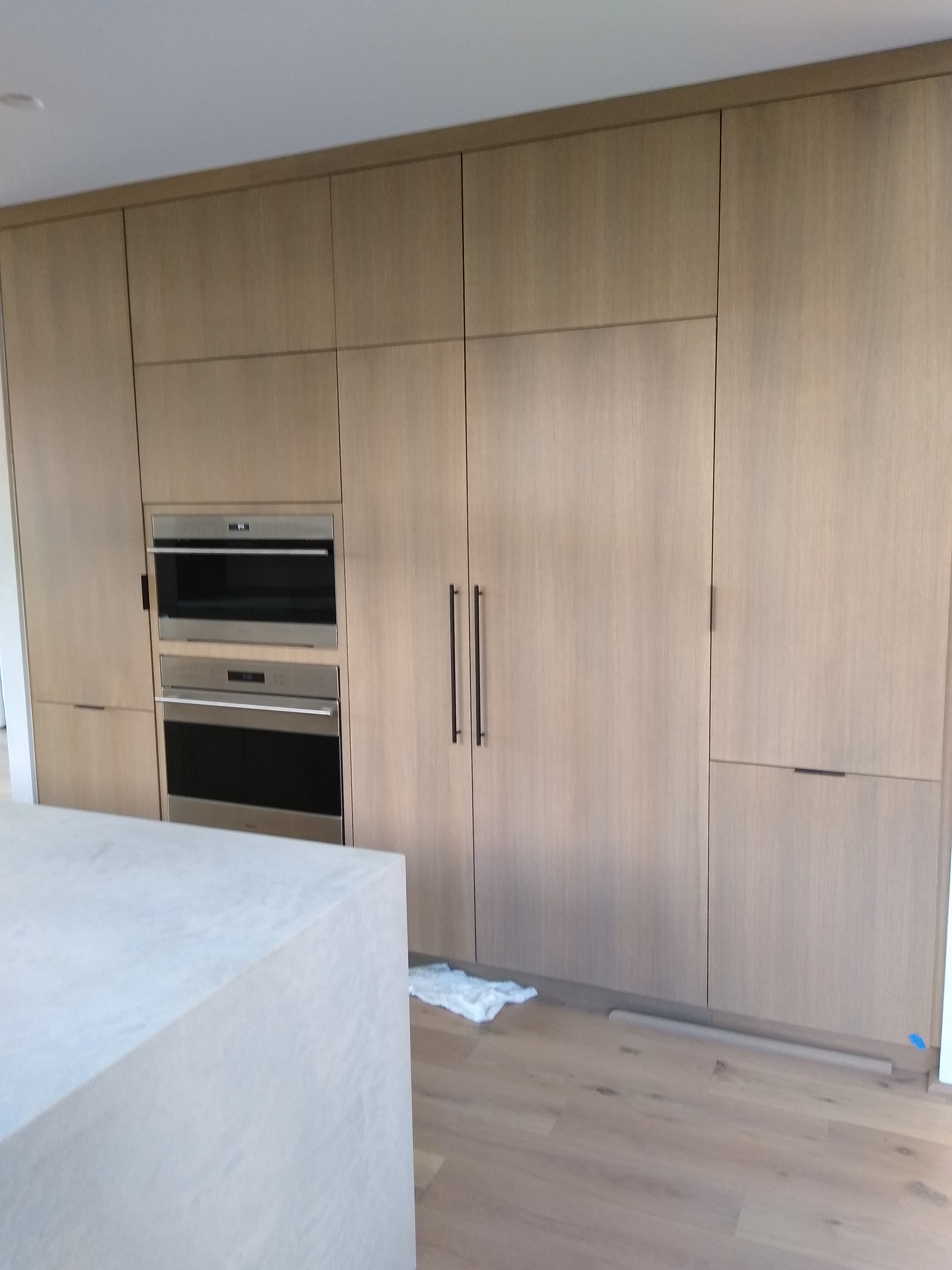

mastercabman Member
As mentioned
Keep it natural, maybe use a waterborne so that it is as clear as possible
Or I have seen/installed white oak with this graphite like stain
It's a little dark but if doing flat slab panels
It is very modern
