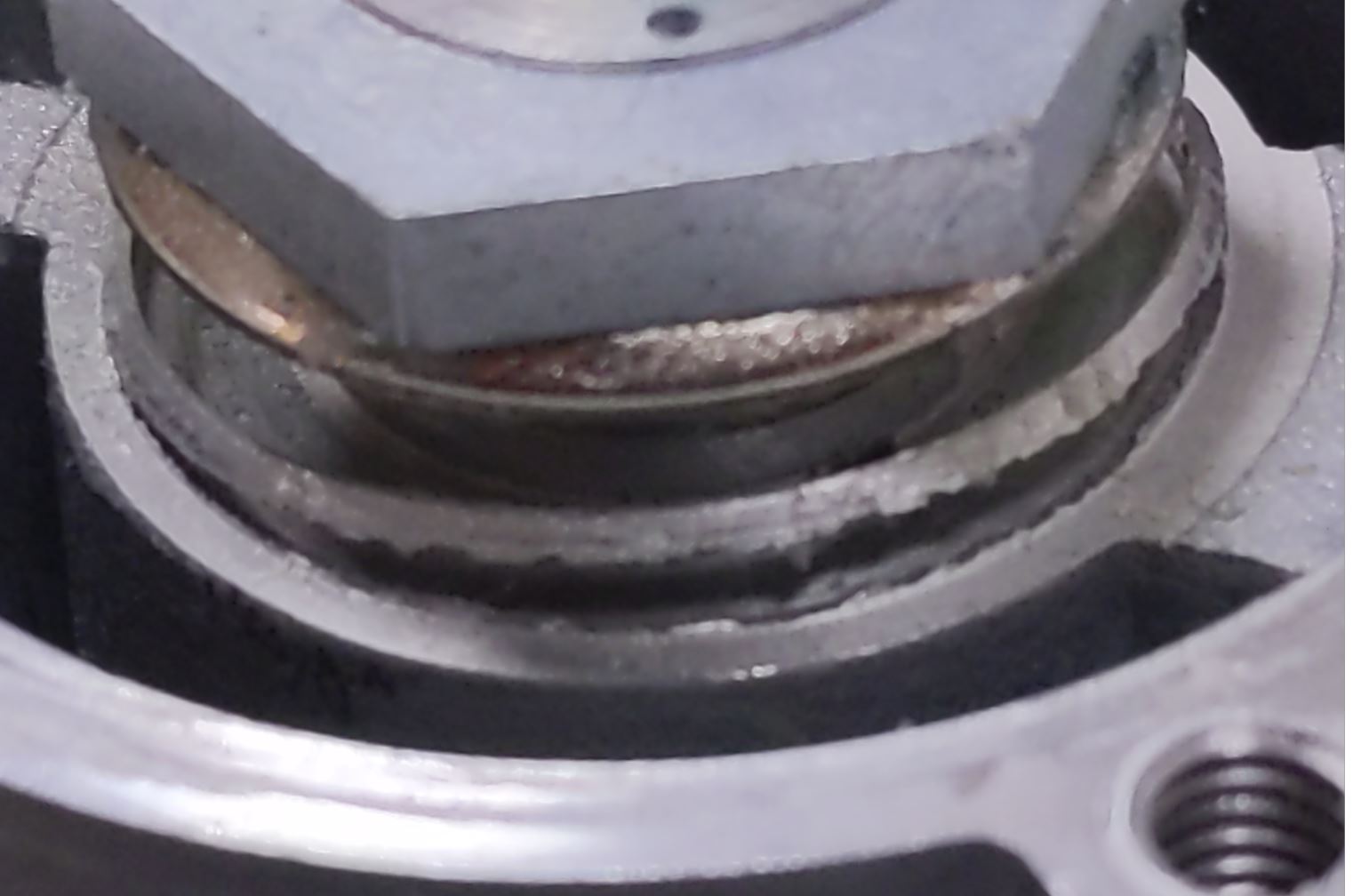

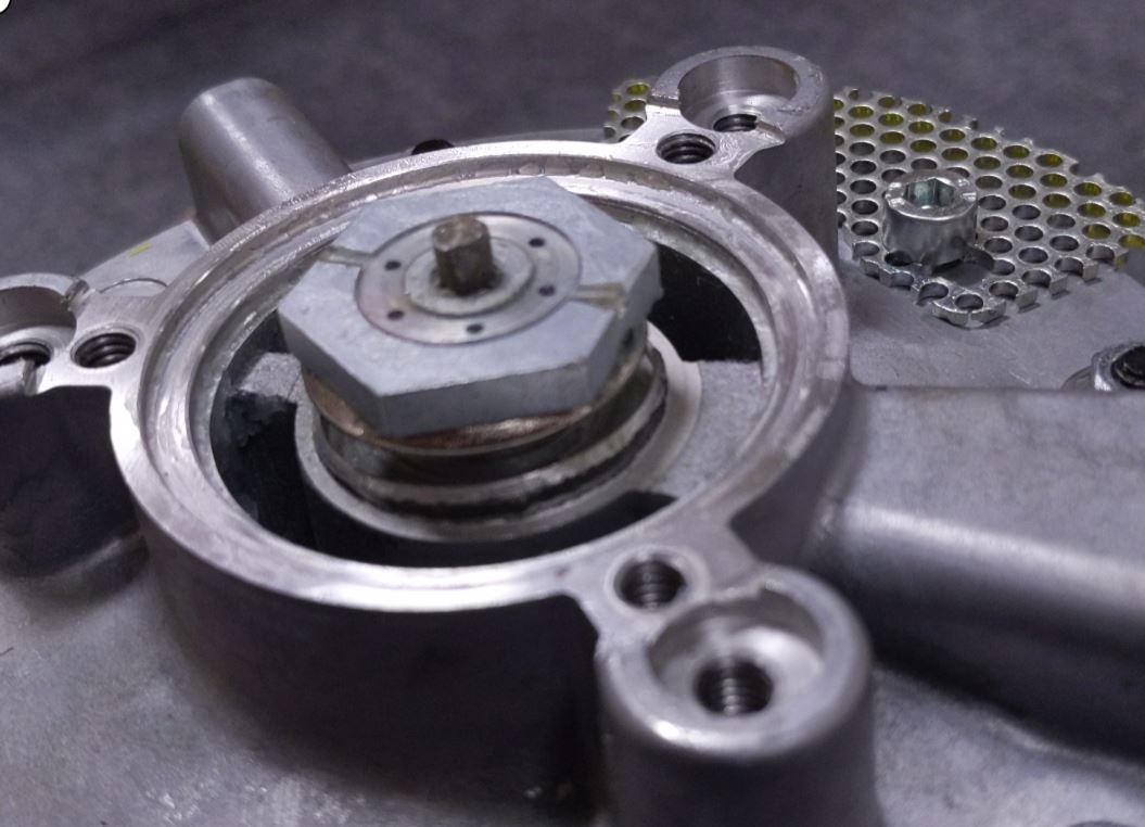

Recently the 18 month old Kremlin pump started malfunctioning--- the pump would stammer/stutter on the down stroke, and then just stalled out the other day. I had to unpin the fluid and air motors and manually pump the conversion varnish out with fresh thinner.
I opened the air motor and found a busted ring that is cast into the upper plate called the "Reversing Body". See pic attached.
Anyone else have this issue? The ONLY thing I can think that has ever happened with this unit is that it can easily start pumping forcefully when changing over from thinner to varnish, because they put such an ENORMOUS pickup/suction tube on them. There's a huge amount of air in that pickup tube and these pumps seem hypersensitive to air in the fluid motor. Even at very low incoming PSI, the pump can jackhammer if you aren't extremely cautious.
All I can figure is that at some point, this happened, and the force cracked that "reversing body" ring.
So, we're spending $300 in a replacement part on a Kremlin that's hardly 18 months old. Has anyone else had this happen? Do you have the same trouble we do purging the air out of the system without the pump going Warp 9?
